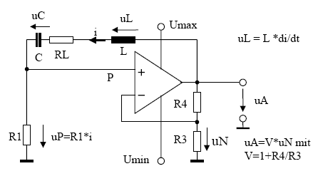

                          • Hi,
                            if anyone is interested on a powerfull LC oscillator, the basic circuit is shown below. The output of the op-amp can be driven with pnp/npn output stage, to increase the drive current.
                            I have tested this LC oscillator type and it delivers as much power, as you need.
                            Here the source for this LC oscillator (german):
                            http://www.home.hs-karlsruhe.de/~ker...us/sinosz4.pdf
                            Aziz

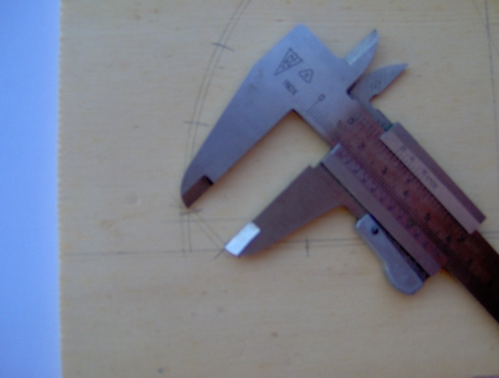

                            • Hi,
                              Max.
                              What is the dimension here ?1,6cm?Because I can see clearly.
                              • Hi,
                                and also this added area exept 12,75.How much it is 1,5cm?2cm?
