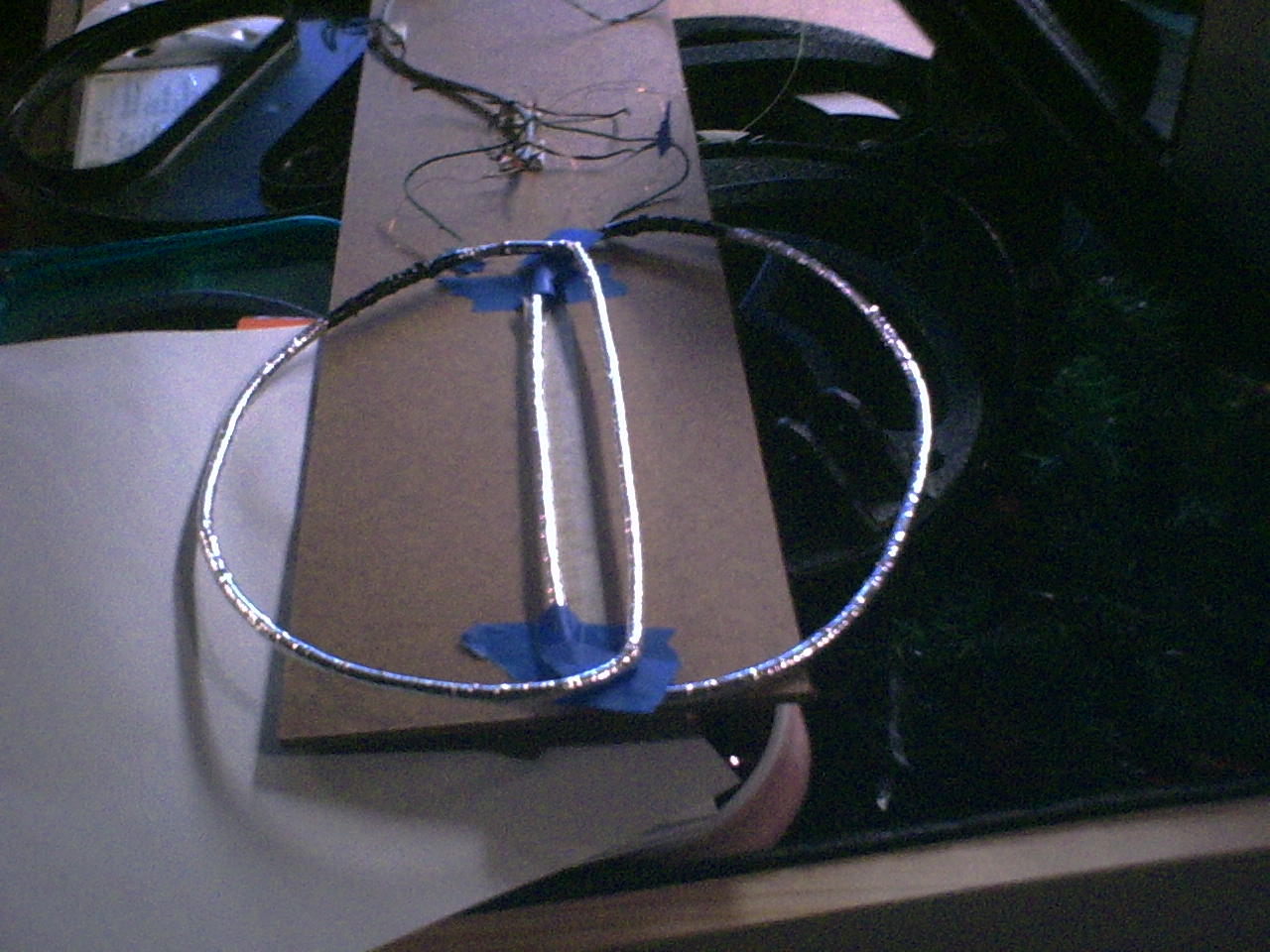

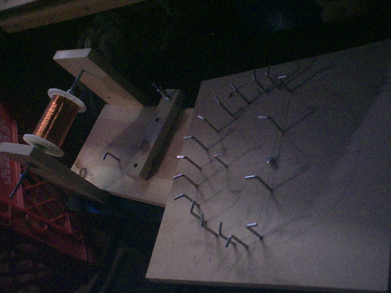

                • Yesterday i null with the scope very easy the same coil, but know i need to know how to do fine tuning of the RX coil. Should i use caps parallel to each lead of RX coil? If so wich value should i have to use?.
                  This questions is because i had noted that sensitivity of my TGS is to poor, a 27 mm coppper coin is just detected at 18 centimeters.
                  TX coil is working at 14.6 Khz.
                  Any help, please write about.
                  Nelson
                  use Ivconic's data:
                  TX= 100turns
                  RX= 105turns
                  wire 30AWG (0.25mm bare diameter, without varnish); you can use 0.30mm but require change a bit turns.
                  Coil diameter will be around 27cm DD type.
                  Null at less than 15mV peak-peak
                  Resistance is for each coil... around 20ohm and you have match tx frequency of 14.5 - 14.7Khz.

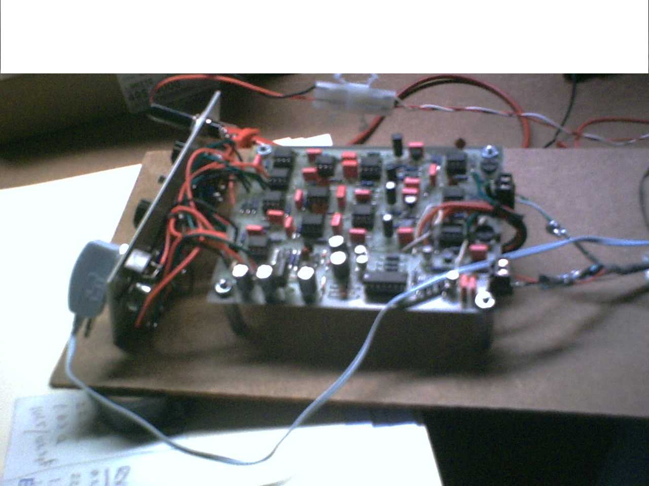

                  • Hi,
                    Did some more testing, All aspects of descrimination, sense, and notch feature work properly. Coils are connected properly, still Rx always shift to the right when triggering on Tx. First gate of GEB (LM358, pin7, Max's Test point #9) rise when metal exposed to coil, like Qiaozhi said.
                    Problems are some erratic noises and only 18-20 cm depth on 2cm copper (or silver coin) Using LM308 or TL081 same. Only changes from schematic are 4.7ZD instead 4.3ZD, 3.9K instead 3.3K, and am using 10K instead 2.2K (or 33K) like Ivconic suggested, sound seems good. LF442 is TLC2262, FETs are TIS75s.
                    Haven't made many DD coil, but have made many PI coils. Am using 30 AWG enameled wire 100 and 105 turns wound on fixture (see photo), 0.8mm thick spiral wrap to bind coil, then .05mm thick aluminum foil for shield with 1 cm gap, then .2mm vinyl electrical tape to secure all. Null is ~8mV pp. Below are some photos. Sorry for the crappy images....
                    Any suggestions?
                    Many Thanks for everyones help, this has been a good (interesting) project!
                    Molzar

                          Hi Molzar,
                          For the TGS, the TX frequency should be 14.65KHz and the RX must be tuned to 16.12KHz. So it's important to note that the resonant frequency of the RX circuit is higher than the TX. This might be causing the right-shifting of the phase if the RX frequency is lower. Otherwise, there is no reason why the DD and concentric should react differently, unless it's something to do with the physical construction. i.e. under or over-nulled.
                          Perhaps you could experiment with your setup, and let us know the results.
                          • "...Problems are some erratic noises..."
                            I heard this from many people recently. Among 22 devices made so far, i also had few cases, where some ocassionall chatters and noises occurred.
                            Really...I dont have universal solution to solve this problem. Usually it is about bad coil.
                            I posted many posts arguing and explaining ONLY one proper way to null specially this DD coil for this TGS. Yet..very few memebers accepted my
                            advices.
                            Do not null coil using RX stage outputs (LF353)...WRONG!
                            Null exact coil for exact TGS using only its TX output connected to TX coil and RX coil leads connect directly to milivoltmeter, BUT NOT TO TGS!
                            I know...few experts here will again deny my claims and method, explaining theoretically why it is not proper.
                            Do i give a sh*t? Of course not.
                            My TGSL's and coils works excellent,calm and very "deep", despite "wrong" method i used to null them.
                            1e coin at 34cm in the air and 28cm in the ground. Rock stabile, no chatters, no falses. Perfect discrimination.
                            Only problem i do have with almost all TGSL's is weak audio. Not so loud.
                            Everything else is perfect.
                            I wish you success at the end.
                            After all....try my method and you will see.
                            Best regards!

                              Hi Qiaozhi,
                              This should be easy to prove by swapping the coils so the Tx is the lower frequency (higher inductance). Also if you take a look at Carl's coil data http://geotech.thunting.com/cgi-bin/...oils/index.dat the one Tesoro DD has the Tx as the higher inductance and all the concentrics are the opposite, Tx lower inductance.
                              I've read many posts on Tx frequency of ~14.6 KHz here, but where does the Rx frequency (16.12 KHz) you stated above come from?
                              Will try swapping coils tonight...
                              Thanks,
                              Molzar

                                I think the problems are always there:
                                - fets commutations
                                - comparators
                                I noticed that also on BandidoII happened in past I got instability due to comparators : I haven't guard rings or something there. Also, on fet amplifiers no guard rings.
                                The problem I solved on bandidoII shielding lower side of critical parts... and I think a large copper plate to gnd will solve many of these problems also on TGSL (actually I have rock solid TGS but not solved yet... cause I test just from time to time, the problem on my TGSL board... that's really sensitive too but noisy).
                                The dang fet commutations are still a problem but I think the really weak ring is related to last comparators... too easy to commutate there if noise present... and adding inertia slow down all the operations there and that's no good.
                                I noticed Paul Panzer's project has large GND plane on upper side of board... that's the first thing I would like having on TGSL board but at now I cannot rebuilt it this way to see.
