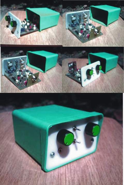

                • I designed new pcb for TGSL. It fits exactly to plastic enlcosure for Fisher 1265. Why i did this? Somebody from Bulgaria is making huge series of those enclosures from ABS plastic. It is cheap there....i think 5e per piece. So....
                  Enclosure problem is solved for good!
                  While drawing routes i tried to pay extreme attention on signal flows. So...this maybe not perfect but very descent.
                  Later i found out that missed 1K resistor connected after 220nF from LF353 output.Not an issue, could be easilly added after...
                  Here is file, enjoy!
                  P.S.
                  This is the second time i am posting it. First time was posted on other thread by mistake....
                  • ...and yesterday i finished first device on this pcb...Tested..
                    What to say? I am affraid you wont beleive me and take me as lunatic, but 1e coin detects at 46cm in air!!! Cola can at 80cm, 10cm x 6cm Al plate at 80 cm... 2.5cm bronze roman coin at almost 50cm!!!
                    I didnt expected that!?
                    Yes, GEB is adjusted that well, it does not react at all on large ferrite rod, hotrock, roman clay...i tested it on every possible junk in my workshop. Discrimination also perfect. Large tweezers rejects totally, not a sound,at disc pot adjusted to "2"...
                    Coil i tested with is ordinary 27cm coil, i usually make for TGSL's...nothing special...
                    What else.. i put hi quality capacitors there; WIMA. J107 as usuall, 2N2907 as usuall (all resistor arround as usuall except 24K which couldnt find, so i put 22K)...
                    LM308H - metal case.
                    In chopper stage i put BC177 and BC107 in metal cases. Minus voltage is now -6.5 volts, not -6.2 volts as it was with other devices...
                    Detector is rock stabile up to Sense adjusted to "8". Over "8" to "10" (max.) it can chatter ocassionally, but very silent and mum chatters.
                    Moving coil and cable randomly, squeezing cable....not a sound, perfectly stabile....
                    So....
                    It is to early to abandon this project. i was thinking to start with something else (kind a tired of TGSL's, made over 26 pcs so far)...but...i will not!
                    This is shoving more potential than i ever expected.
                    Now modding audio makes a lot of sence!
                    I have doubts (somebody else gave me tip) that present setup with MPSA13 and speaker do act like a parasitic ballast in a way. It is very possible.
                    I already noticed direct relation between type of speaker and ocassionall chatters. Those are produced in latest stage of device, not coming from frontend for sure...!
                    So...i was thinking how to remove that ballast and figure out some type of relaxative audio? But how? Which one? Possible to involve some stronger FET or simillar...?
                    Need to be explored more...
                    I do suggest you to try this pcb...much less noise than on all others made so far!
                    BTW
                    here are photos of device..
                    • Hi Ivconic,
                      Very neat an clear PCB ! all components are well clear from each other.
                      Good luck,
                      regards,
                      Fred.
                      • Hi Ivconic,very nice,I can't believe it that depht but I trust you so I have to believe it.Grt Nakky.

                          • Thanks!
                            Sure thing Amtech 2005!
                            Nakky it is in the air, so far didnt tested it on the ground. I already have been seen few "boosted" detectors with fantastic results in the air.But those were very unstabile. On slice touch on coil those produces a lot of false signals. Not to mention touching cable or lowering coil to ground!!!
                            But this one is different. It is very encouraging, even now, this TGSL 1265 is absolute immune on any torture with cable and coil.No falses at all.
                            46cm in air on 1 euro coin means some 30-35 in the ground...medium soil, hopefully. But i will wait with claims until testing it properly. I also have excellent reference at home to compare with - Eagle Spectrum. So far TGSL 1265 performs much better on coins than Spectrum...! On large items ... let's say 20x20cm Spectrum is more than superior.
                            I know what is all about; TGSL's oscillator is very weak, producing limited em field. Other hand Spectrum's oscillator is stronger, producing stronger em field and covering larger area....
                            So it is good deal, TGSL to be used as hell of a coinshooter only, with smallest possible coil. I do intend to experiment with coils under 20cm in diammeter. And Spectrum will serve as powerfull prospecting machine mostly.
                            I always wanted powerfull coinshooter....now i have it. Job is done...
