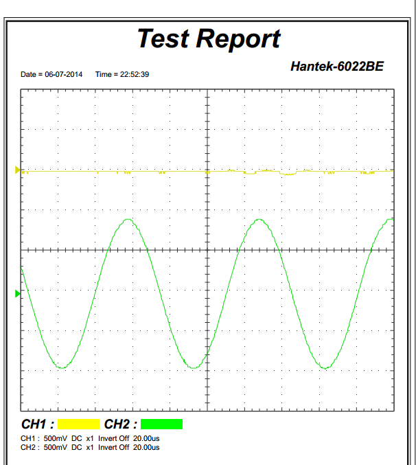

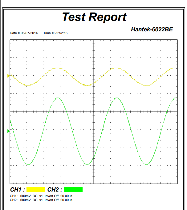

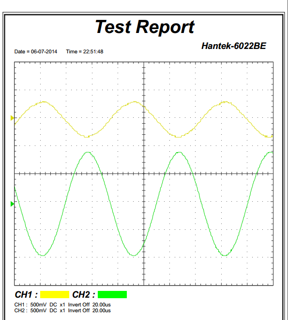

                    • I just were playing with coil balance using USB Oscilloscope
                      On RX coil i just placed function generator tuned to 14.5KHz
                      and that is the channel 2 on scope,
                      on first scope channel i connected RX coil
                      And moving coils across each other i got perfect null position
