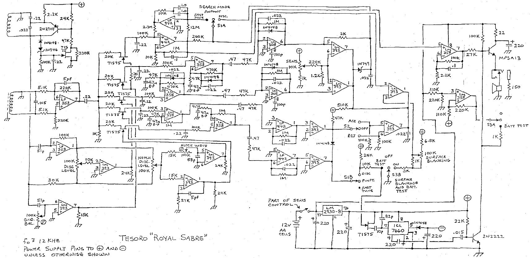

    Don Bowers' schematic has fatal mistake in TX colpitts oscillator. look on my right sch of Cobra and you will see R3 is NOT 47k -!
    (R10)
    somebody (iwkonik?) losted the decimal point.
    Short retrospective from most of the schematics available:

      "...Of course RX measures the same Freq since it simply Receives the TX. exactly my knowledge says the same thing but in that guide it says the rx tank should oscillate at about 16.1 khz!..."
      Presuming that you check RX coil by connecting it at TX coil place. Than you'll see the different frequency, of course.
      As for "mistake" made by William Lahr; there is no mistake at all.
      At various Tesoro designs you'll see the same resistor vary from 4k7 to 47k.
      At Bandido is 20k. Etc.
      By strange coincidence i am having one TGSL on the bench right now.
      I replaced 47k with 4k7 and i don't see any difference in behavior. Works the same.
      2e coin detects at same distance in both cases. Disc, GEB, everything works perfectly smooth and same in both cases.
      At the same time there is Bandido II uMax on the bench, with 20k on the place. Works just fine.
      So?
      If you pay too much attention on KT's rubbish; you'll get nowhere, that's for sure.
      I saw part of the schematic you posted and i see dramatic changes in TX stage!?
      What the heck you did there man?!
      (rhetorical question)
      yeah that is a standard type colpitts oscillator
      now i'm going to change things to default and see if there'd be any differences (hopefully) i'll come back with results
      but i have a question : how a transistor colpitts oscillator would oscillate at 16Vpp by using +8V supply??
      that's pretty strange to me...

        Due different voltage supplying the oscillator, simple as that.

          Do you have oscilloscope?
          Can you tell the difference between DC and AC?
          Do you understand the "Vpp" meaning?
          • Royal ............... 47k
            i learned Royal good because GMT king cobra is same. you write that do not know.
Name:	Tesoro Royal Sabre.jpg
              [ATTACH]49360[/ATTACH]
              Be a sport, waste just 2 minutes of your precious time, change your 4k7 with 47k and see what happens.
              If supplied with 8 volts and than if supplied with 5 volts. 12 volts in your case.
              Use oscilloscope and analyze the signal amplitude.
              Than continue to be a sport just for 2 minutes of your precious time more and inform us here about your revelation.
              Many thanks in advance!

                    сам смотри - РЕЖИМ ПО ТОКУ транзистора в генераторе даже на взгляд ненормальный!
                    логичнее 4.7к а не 47к!
                    • 10 108 posts on Geotech forum... and still so low knowledge and understanding of some basics in Electronics?
                      Hate to say; ignorance.
                      "...It is logical 4k7 and not 47k..."
                      Electronics is not based on whats "logical" and "not logical" but on strict laws and rules.
                      If you take the same oscillator and supply it with 5v,8v or 12v; it is not the same.
                      You must know that? Or not?
