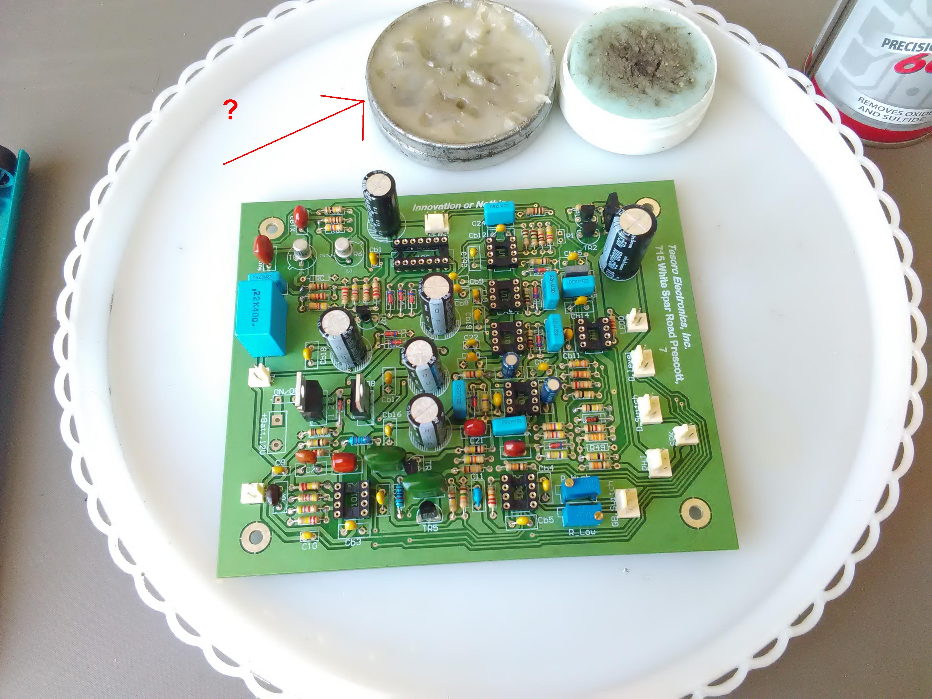

    Also, I think you're all being unduly harsh towards Mr.Jaick. Personally, I think he's done a pretty good job of creating his own PCB.
    Agree with you my dear Quasishoshy!
    Very nice pcb put together.
    Very neat work.
    But when i saw that piece of schematic he posted... well!
    • WAIT A MINUTE!
      WTF is this on photo?
      • Could it be... by really unfortunate occasion... the oily conductive grease for welding gutters and various metal sheets!???
        Or it is just put there for fun?
        • If i am not mistaken in what i see, if that is not just your spouse's make up set left there randomly; than your pcb is greased very well, all over the place and conducts randomly everywhere.
          Only cure now is nitro resin bath. For stay and soak for 20 minutes deep in nitro resin. Later on brushed up good and let to dry good and long on fresh air.
          And all over the sudden; that pcb will start working just fine!
          (Assuming that those strange modifications at TX stage are making any sense)

              • But i think i discovered the main problem at his nice work already.
                It is the greasy welding pasta.
                Worst calamity you can imagine in our line of works.
                I can not resist not to laugh, when see "pro" dil sockets there!!!
                I wonder even if nitro will solve the problem there!

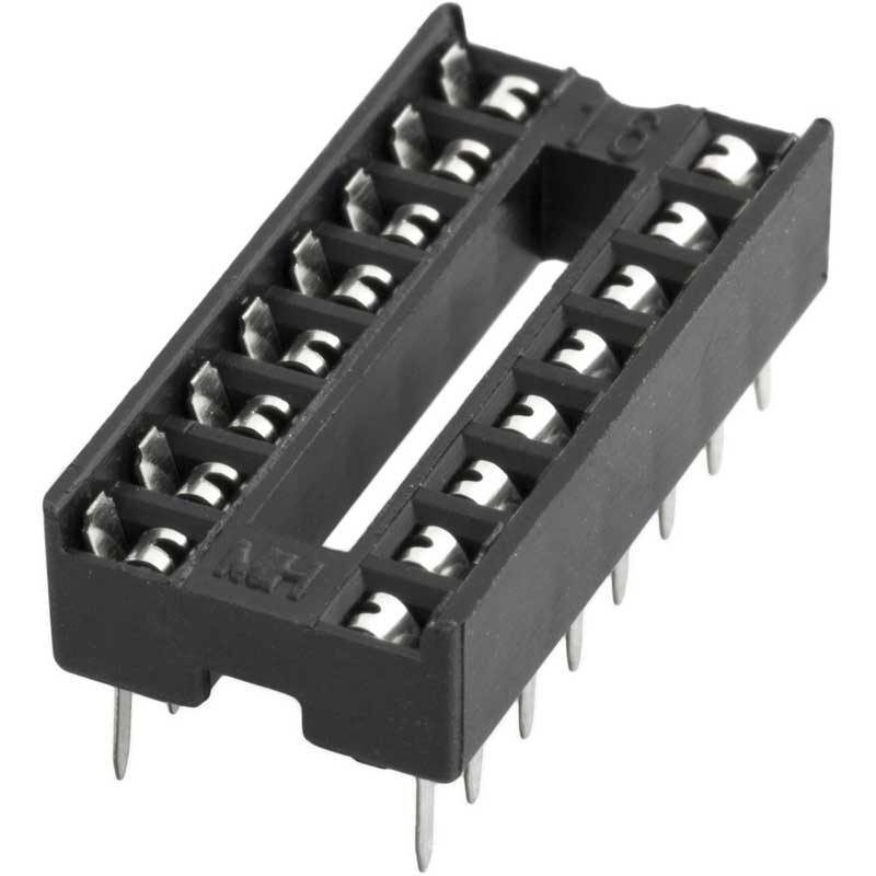

                • Those machined pin dil sockets gave me many problems in the past. Haven't used them in years. I switched to theseClick image for larger version
ID:	356471 I don't have problems with them.
                    W. Lahr NEVER made mistake on this, period.
                                yes sir that's for soldering but i cleaned it with gasoil spray and then clean the gasoil with precision electronics cleaner spray no problem , it says on the cap "clean after use to avoid unwanted connection"
                                do you have any better solution for soldering , i'm welcoming
