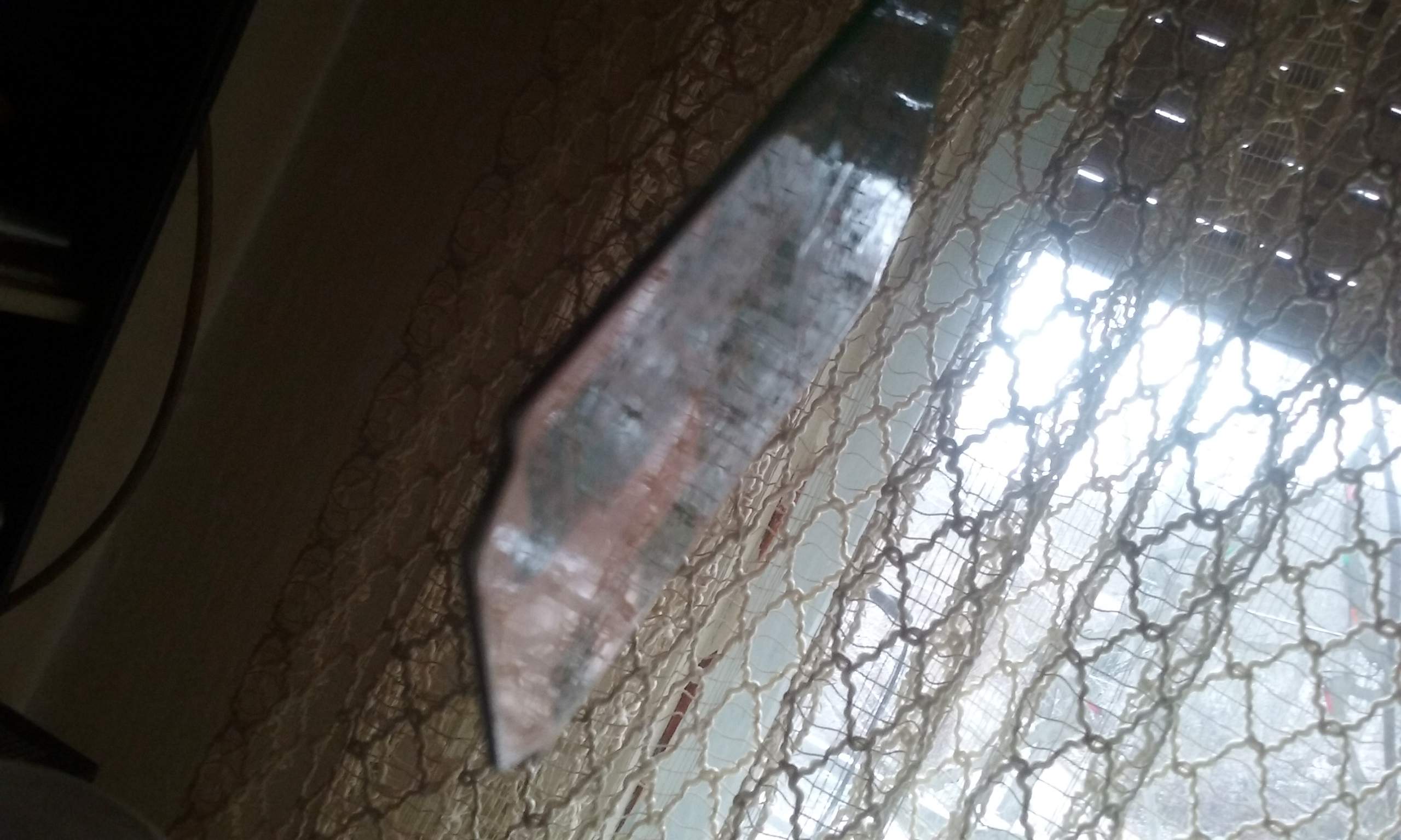

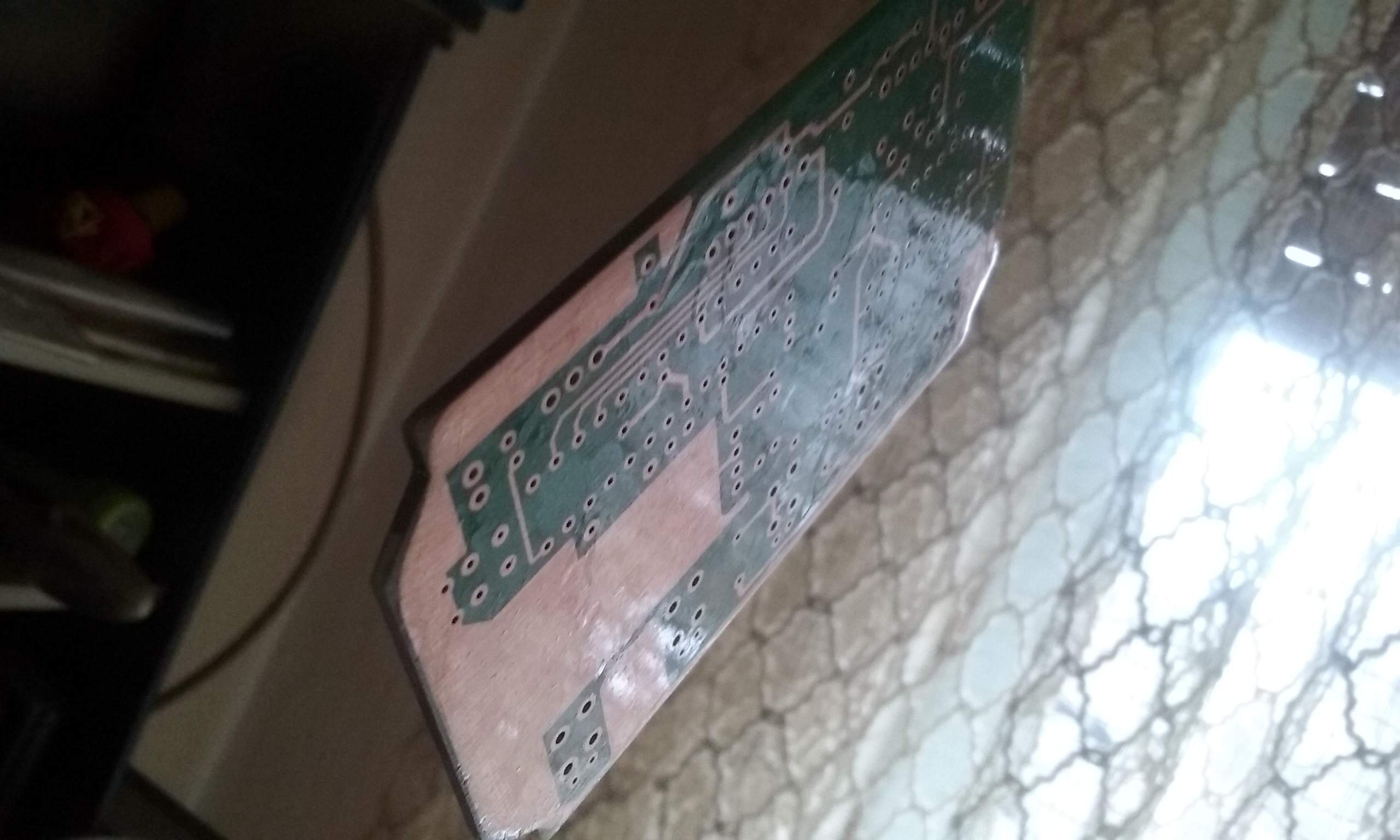

                    • This is how it looks like when coated with kalafonium.
                      This one is most recent pcb, hanging and drying:

                      • What you are referring on is "Kalafonium".
                        no it is not. i bought it for 'probe' and it is kinda from petrol made like semiliquid paraffin.
                        do not like it because does not dissolve good by alcohol on cleaning. colophony is much better.

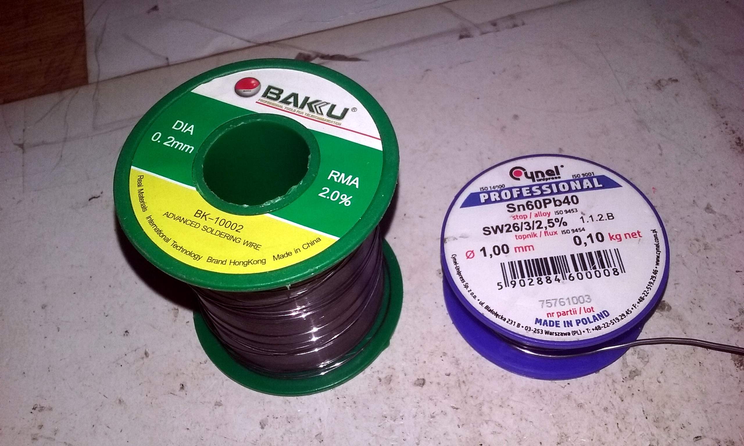

                          Right now i am using these:
