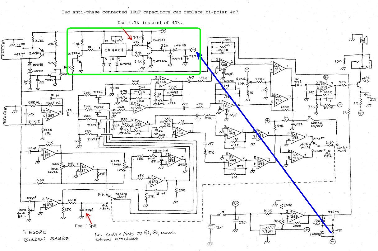

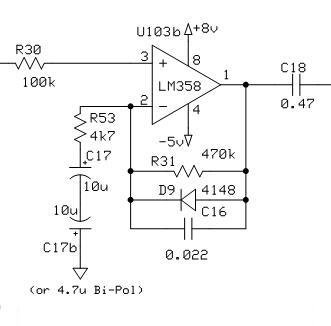

  • Hi every body i bild one TGS but i dont where is this -6,25V before 1n4148 and 470 k i have 0,74 v what is wrong
    • Originally posted by sevar12 View Post
      Hi @sevar12,
      Did you build the TGSL by using @Ivconic's PCB?, for C17 (a+b) or Bi-Pol is connected to -12 Volts.
      Are you not you just measuring the DC Voltage drop over the 1N4148 (D9) ?
      For more information concerning TGSL Tuning & troubleshooting, you may also want to read this thread:
      TGSL Tuning & troubleshooting:
      http://www.geotech1.com/forums/showthread.php?t=16122
      Robert
      Attachment: Extraction of problem area referred to by @sevar12

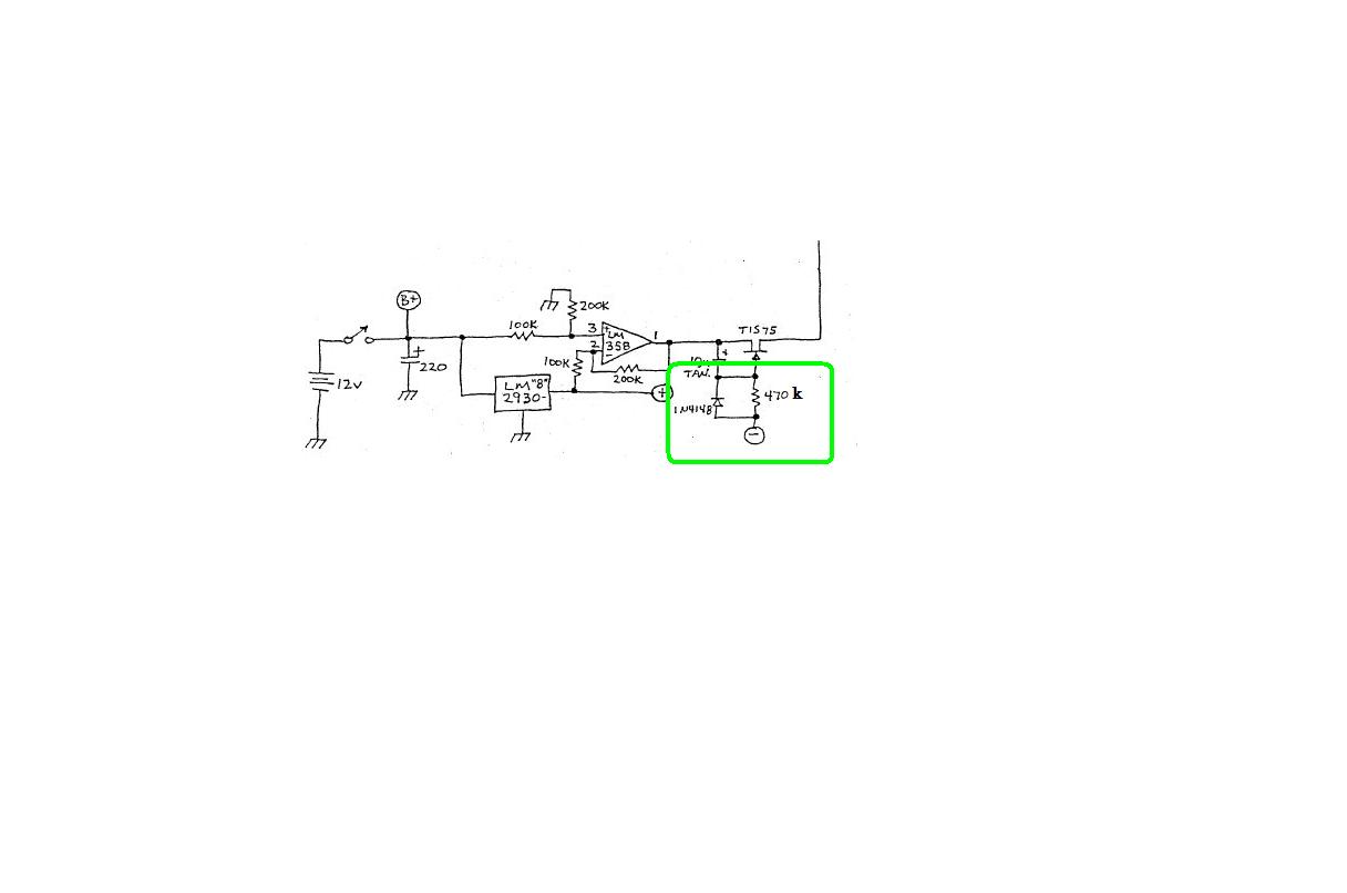

        Hi Sevar ,
        Perhaps you mean this point ? :
Name:	negative voltage.JPG
        If so , this part is only for the positive voltage and the battery check .
        Please note that for the negative voltage the Tx coil must be connected and you must have (Tx) oscillation , then the negative voltage is generated in this part :
Name:	negative voltage 2.JPG
        regards ,
        Dennis the Mennis
        • thanks everything is ok i forget Tx i have -6,5V

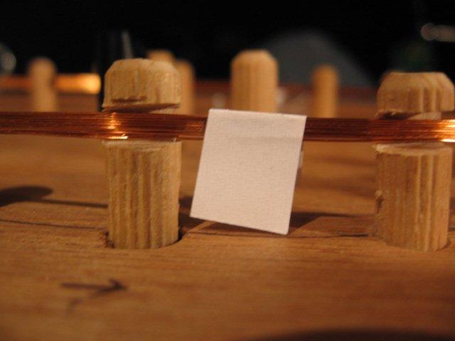

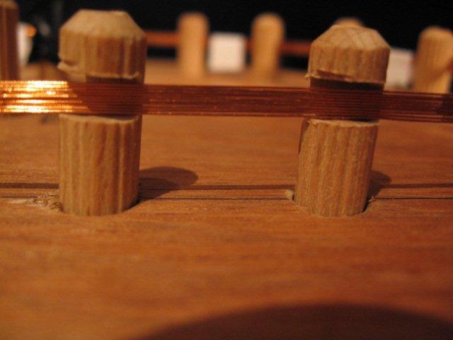

                I was experimenting with these 'construction' for a square coil with sequence in the layers:
                the piece of paper was for the contrast, this way you can realy see the layer by layer build up
                Only the space was a little too big , perhaps when it's smaller I get a perfect layer by layer and perhaps a small advantage is that these coil can be constrained .

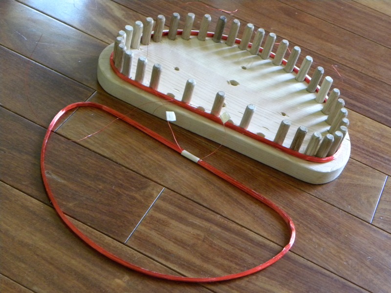

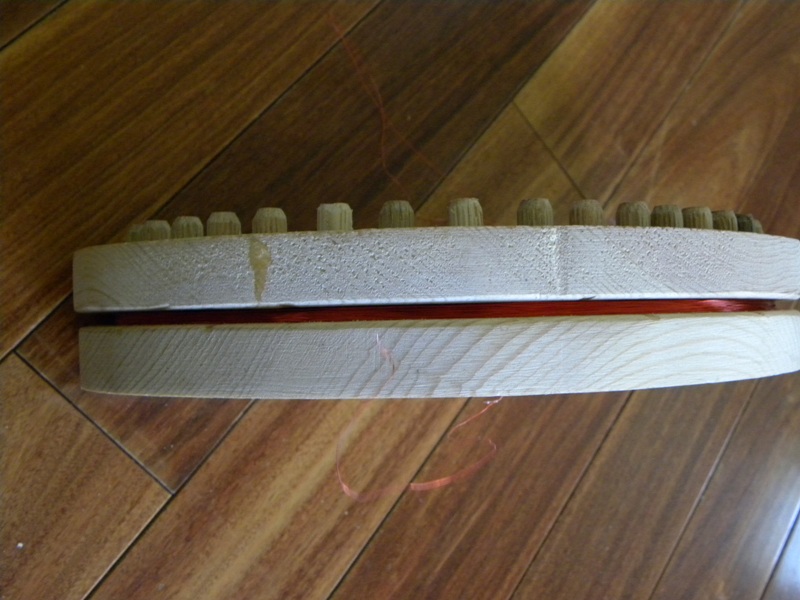

                  Sorry.. I forgot to add a few details.. I am using .25mm wire (30 gauge I believe). No constraining at all. When I wind coils, I feed the wire through a small container filled with varnish. It is an old pill bottle with two pinholes. The wire goes in one pinhole and out the other so the wire goes on the form "stickey". Let the wire dry for a while. Then just remove the top and gently work the coil off the form. That's it! I usually put a few extra turns on the coils so I can just peel off a layer or two to tune it. Usually, inductance is dead on from coil to coil.
                  I tested the coil pictured above. No improvement over any other coil I have made. Just looks a lot nicer. Most coils I build, I can detect a 1e at 29 or 30mm. I'm going to build a second circuit board, a little different to see what difference it makes. The coils I have made have been "jumble" wound.. Not neat layers, but they come out with a square cross section.
                    I was always wondering if layering would make any difference.
                    Don

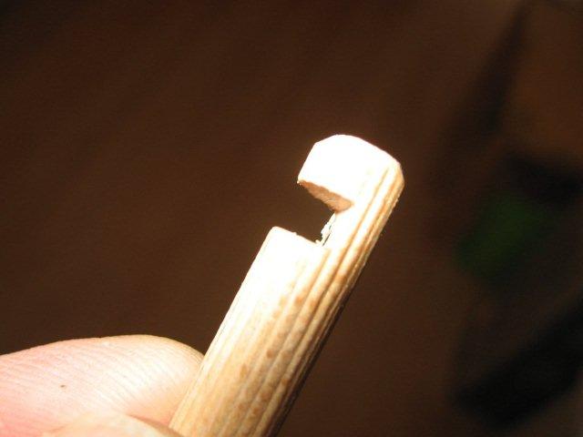

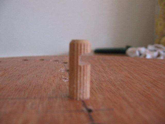

                      In between the Pegs, a drop of Cyanoacrylate Glue (Brand Names: Super Glue, Crazy Glue, Loctite or Insta-Bond) may be used. The capillary action will spread the Glue threw out the windings, so sparingly (very little Glue) apply it to multiple places on the Coil for proper fixation. Then let the Glue cure, and only then remove the Coil from the Mall (or jig).
                      Note: Capillary action is a physical effect caused by the interactions of a liquid with the walls of a thin tube. The capillary effect is a function of the ability of the liquid to wet a particular material.
                      If you use too much Glue, then the Pegs will also be reached and stuck to the Enameled Copper Wire, so only apply sparingly. Glue that may have adhered to the fingers etc., may be removed by the use of Acetone.
                      Caution: Acetone Vapor in Air is Flammable and Explosive, so no ignition source may be present, smoking etc..
                      But be careful when using Acetone and Enameled Copper Wire, for the Enameled Coating may dissolve (read: will dissolve). Cyanoacrylate Glue is a Glue that hardens by the action of Moisture, and is NOT Air dried in the normal sense (moisture in the air cures it).
                      Caution: Cyanoacrylate Glue that gets into the Eye(s), will destroy the Cornea !!!
                      Wants the Coil has been removed from the Mall, then Varnish may be applied. But it must still be flexible, for you will still need to Nullify the Coils.
                      I hope this helps.
                      Robert
