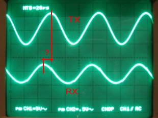

                    • Maybe I have not clear what is the requested phase difference...
                      I thought that the rx signal shold have been on the right of tx to have a positive difference.
                      Dennis' , as I see form his picture, looks negative to me.
                      So my questions to the gurus are: is this phase relation correct for a coil properly nulled? Should it look the same both at input and at the output of the preamplifier ? (I mean phase, not amplitude...)
                      Thank you
                      Stefano

                              • Originally posted by Stefano View Post
                                Thank you
                                Stefano
                                You should measure the RX initial phase-offset at the output of the pre-amp, as that's the signal which is sampled by the synchronous demodulators. In your photo of the scope the phase-offset is incorrect. For a DD coil it should be about +20 degrees, but you're showing about -50 degrees.
