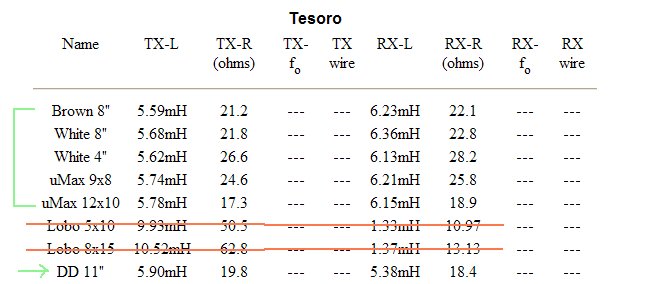

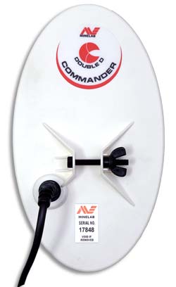

            Wild_Desert , You can use Litz wire , but you need to use a smaller diameter or gauge of Litz . If Max said use 30 gauge of regular enamel , then use 33 gauge of litz . Yes , Litz is better !!!!! But your windings must be very precision windings on your forms. Minelab Commander series of search coils use Litz wire !!!!!!! Try to first wind the Lits wire to the DC resistance values on this chart. Then check your frequency of oscillation , if it is close to Golden Sabre 1265 light frequency . Then check your inductance , you will notice a difference from normal enamel wire !!!! And you will detect deeper than all of us using our cheap copper enamel.....Litz is much better wire , more expensive too , and $50. dollars for 500 feet .......Please let us know your results !!!!....See the chart I reposted again............Eugene
