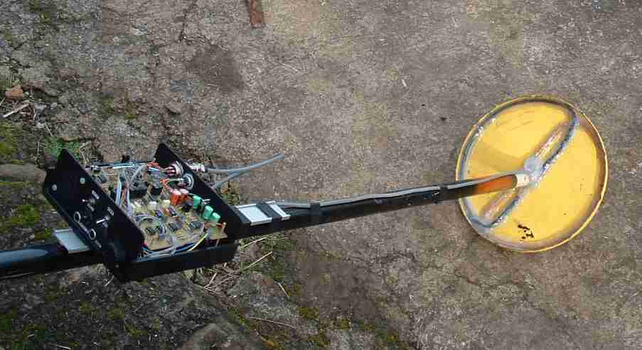

                  • New coil, incredible resuts.
                    I have just tried my new DD coil, here are the results.
                    All tests where made in air, with a 1 dollar coin,38mm diameter.Coil is 20cm diameter
                    When at maximum,the "sens" pot is at 5 o´clock, here i get a few random beeps,i reduce it to 4 o´clock and it is perfect.
                    -With ground ballance pot a one side (no ground balance),all metal,i could detect the coin at more than 45cm!! With sens at max, barely detectable at almost 50cm. I had to fix the coin on a 1m plastic pipe to avoid detecting my hand.
                    -With GB properly set, all metal,38cm.
                    -"Disc" on , 27cm
                    Now i want to put the GB pot on the front , i let a space for this.
                    The TGS i really an excellent detector!
                    Thanks for all who helped here to build it , in particular Qiaozhi,Max,Ivconic Etc.
                    If i find a treasure i will let you know
                    No i am going to build to the next project, a PI.
                    Best regards to all! ,
                    Fred.

                      Nice to hear that, Fred! You don't need to put GEB on front panel, you only need to preset it right. Already explained on this thread. But i will suggest you to adjust it to point where is just about to reject ferrite rod.OK you can leave it to produce some mum "crack's" when ferrite rod is few mm's away from coil surface. You dont need to fully reject it. Sdjusted that way, GEB preset will suit your demands on most of types of terrains.
                      The rest you already experienced (as i see from your post) so no need for further comments. Again congratulation! You've made it right!

                        About the GEB: i wanted to put it in front panel because if i want to change coils i dont want to open case each time.It´s just one more pot in front, you did not find its necessary when you change coils?
                        I have right now a PCB etching for the XR71-same as DP, i am glad i have choosen the right one, it took me a few days
                        The PCB is one side, with pots on PCB, posted on DP thread , really nice work.Should be ready in 10 minutes
