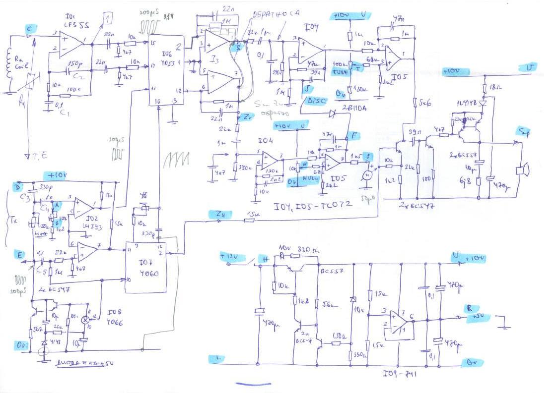

                          Hi Max
                          I am made some shematics
                          last was minelab relik hawk there in air 1 euro at about 30 sm with DD 28sm
                          it have a nice diskriminate but a smal object problem...
                          before i made this shematic at the pict it was stable with concentric bul low sens and make DD 28sm but euro in air - 28sm you can sagest some way to make a DD or concentric for this shematic or for minelab RH
                          before 3 years I made a magnum but not stable shematic
                          I want a make a stable and depth IB detector
                          plboy

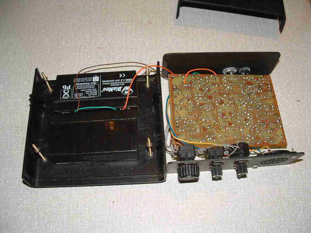

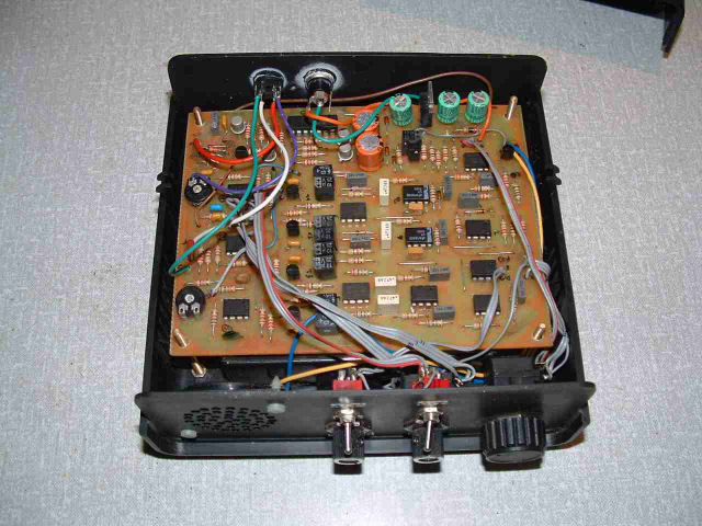

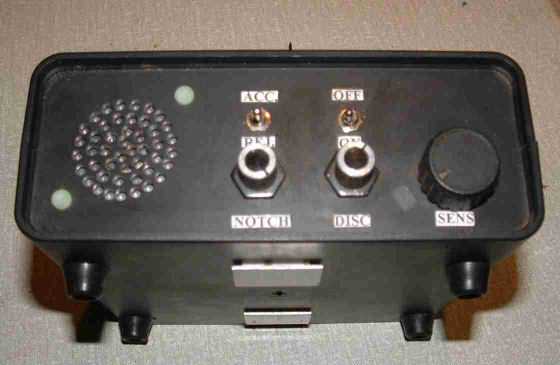

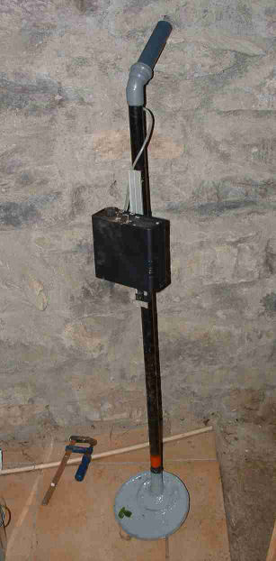

                          • TGS new version
                            Coil is for pinpointing,from another project,not on the right frequency(around 19khz)works well with extremely small objects, i have found tiny 1X3mm screws 5-8cm with loud signals.
                            Fred.
                            • Originally posted by plboy View Post
                              Hi Max
                              plboy
                              Hi plboy,
                              I don't know about a good coil for that schematic. What I know is that you can made very good things with low noise op amps and a good design + a 10''coil (25.5cm) diameter.
                              I can detect , for example, 1eur at 36-37cm on the air with 10'' coil DD.
                              I think that if your circuit , even simple (I think it isn't ML's relic hawk but a simpler one), can do well with good signal/noise ratio and good coil. Coil nulling is the trick: reach few mV peak-to-peak nulling and your coil will be fine.
                              Kind regards,
                              Max
                                TGS new version
                                Fred.
                                Hi Fred,
                                I see... what about depth with coins ? What about coil ?
                                It seems like in some Andy Flind's project... we discussed the topic with Ivconic some time ago. Much better pinpointing with that.
                                Kind regards,
                                Max
