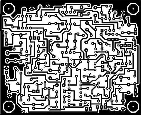

      I cannot make at now double sided photo-process (cause I haven't suitable good material to do it)... so thinking at Vladimir's pcb design I've made some small correction to the original picture file...
      I haven't made any board cause of small time... but I'll do soon I think.
      I've cleaned some tracks and kinda of dirt (colors) from original file to better suit photo-process.
      So... maybe that file could be useful to others too... then I post it here.

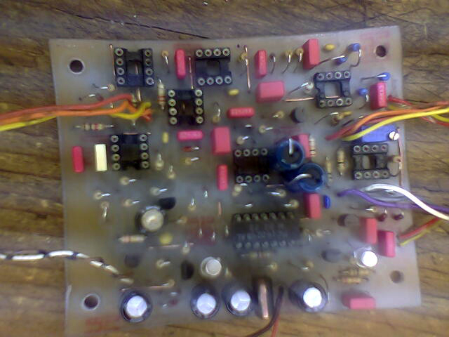

      • How can I post pictures here? I dont know how. Please help.
        • Here is my work of Vladimir's PCB. Sorry for low quality of pic.

            Here i post some pics of my TGS : i hope they can be usefull .The coil form is from a CRT monitor support, excellent as very strong, but a bit too small: diameter of the coil is only 22cm.With this coil i could get 25cm for 1 euro coin,same foir similar size of gold, and around 30cm for a big copper coin.
            I will try to improve it a little and build a bigger coils, will post eventals (good) results

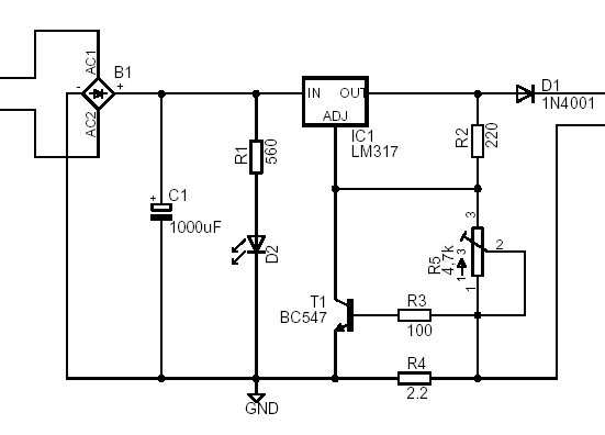

                                BTW you can use my second schematic with LM317 and pot etc to charge gel-type batteries; I use it with lot of success from many years, just set output to 13.8V without battery... then connect it.
                                That's all... it's fully automatic, limited, cannot damage battery and will charge it in very few hours...depending on its status at charge start. Just check voltage... when reach 12,75V battery is fully charged... or you can leave attached to circuit as you want... no problems.
