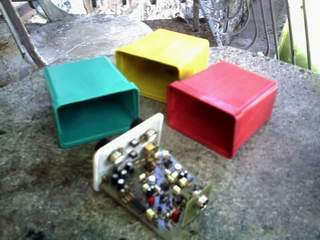

      I designed new pcb for TGSL. It fits exactly to plastic enlcosure for Fisher 1265. Why i did this? Somebody from Bulgaria is making huge series of those enclosures from ABS plastic. It is cheap there....i think 5e per piece. So....
      Enclosure problem is solved for good!
      Hi Ivconic,
      Very nice work, and I like the plastic enclosure. Do you know if the Bulgarian guys are going to sell these? Where can I buy some?

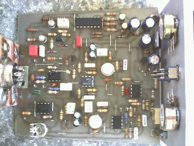

        It would be nice to see more clear pictures of your finished board, especially to see metal cases. Are metal cases easy to find?

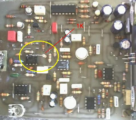

        I'm not clear - is the 1K missing resistor added to the PCB or still missing? How do you suggest to add it?

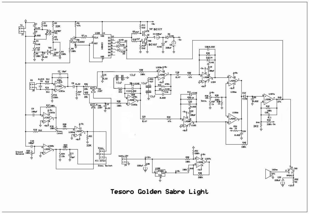

          • Schematic is even more reduced. No battery check anymore.
            Here is the schematic used to draw this last pcb.
            I am using 12V/1.3Ah accu. with all my detectors, so no need for battery check at all.
            TGSL 1265 draws 25mA-35mA when no detection(no sound) and approx.55mA with full discrimination(loud sound)....
            Quiaozhi, i got enclosures from a friend who oftenly go to Bulgaria. Shop is in Sofia (capital). I think somewhere on this forum, somebody already gave link to manufacturer. Maybe some of our bulgarian friends can help here?
            Tiktak c'mon, give us link to manufacturer of coils and enclosures.
            If i found this link, will post it here for sure.

            I will take photo closer to pcb. Problem with my photos are due low quality camera...
            • Like i said before; pay attention on R27 (1K)! I missed it on pcb.Not a problem to add it over...like i did. Had troubles without it.When first time switched ON, detector started to act ubnormal. So after 2 hours of nerving i discovered that stupid mistake...
