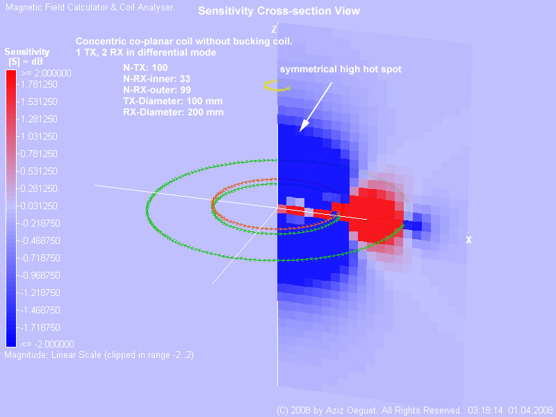

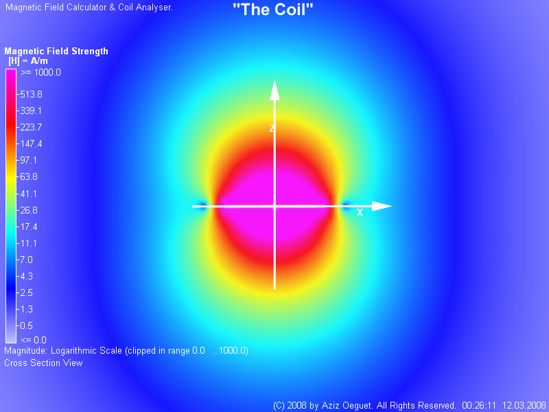

            • The fact of the CC-Coils (concentric coplanar) is, that they have to compensate the magnetic field flux (Φ) inside the flux area of the RX coil (A).
              Otherwise, it wouldn't be balanced. This causes decrease of the magnetic field density and strength (B, H) on the center position of the coil compared to DD or OO coils. Magnetic fields of DD or OO coils need not to be compensated. So the fully possible magnetic field density can arrive the target and maximize the induction effects.
              (Uind=induced voltage, n=number of windings)
              What we have to do is, minimizing the compensation magnetic field over the center of the CC-coils. I am working on this and probably I found an ideal solution for this. I will know in few month, whether such a CC-coil is possible. I am still working on the coil software and it is pitty, that I have to wait until some important implementations are done.
              Aziz
              • What we need is a magnetic field density/strength profile for CC-coil like below:
                • Best CC-coil should not compensate its magnetic field. In this case, we have only one TX-coil (Radius R3) and two RX-Coils (N1, R1, N2, R2).
                  N1 = number of turns for RX1
                  R1 = radius of RX1
                  N2 = number of turns for RX2
                  R2 = radius of RX2
                  R3 = radius of TX-coil
                  Balance is made by R1 <= R3, R2 > R3 with appropriate radius and number of turns N1,N2 and the RX coils are connected in serial with opposing winding directions (differential mode). Remember,
                  the total Φ(N1,R1,N2,R2) gets =0 over the total flux area of the RX-coils (A).
                  Is anyone interested on experimenting with such a CC-coil? I can provide all the needed parameters.
                  Aziz
