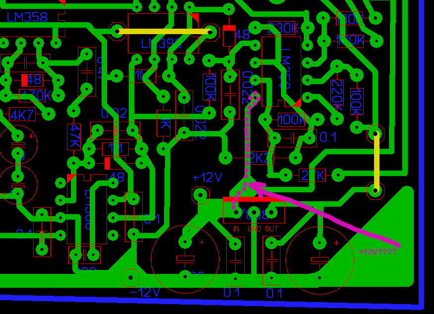

            • TGSL1265 last.lay
              Hi Ivconic:
              I am not sure, but maybe small mistake on TGSL1265 last.lay layout.
              See attached photo. It looks like pin 8 of U107 (LM358 ) is connected to +12v instead of +8v.
              Probably not important, but noise from speaker is on +12v.
              -SB
              • Well...i respected original schematic...
                  (Oh no, not another secret schematic... !)
                  Maybe reason for it is because U107b is used for battery check, so needs to have supply not dependent on regulator?
                  Never stop learning lessons from good old TGSL...

                    • Looking at some questions and remarks here (least reffered to your question about schematic), on these pages...i oftenly ask my self: " Heck! Does people open and read all what was posted here?"

                          It is my running joke that you and Max are magicians who can make metal detectors do things no one else can and have secret formulas... maybe I'm only one chuckling...
                          Yes, I see on that first schematic U107 is indeed attached to battery 12V+ -- I had not noticed that. Just about every other schematic shows it as regulator 8V+. How can we trust schematic when changed later... was it a mistake or truth????
                          I am beginner so I like things simple-stupid as possible. A PCB should match a schematic, not part of one schematic here, another there, for beginners like me. So I nitpick and make little corrections to help me and other beginners, no criticism intended. I also like to question what is best practice and why. Maybe annoying, but someone has to do it...
                          Cheers,
                          -SB
                            Cheers,
                            -SB
