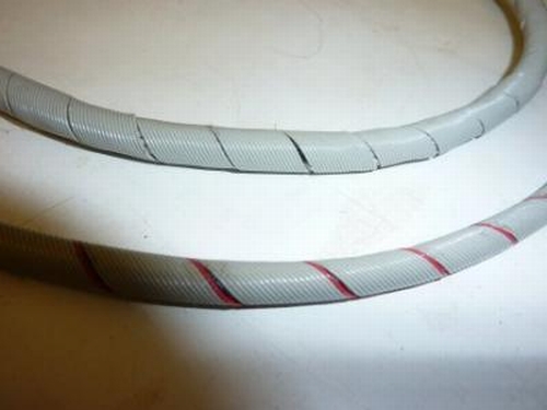

          • Hello, Voya tgsl attempt to operate properly.
            Discuss the detector has a problem, but it is touch and blasts false starts.
            I have several reels, with shield and without shield. I think the sounds she makes are not normal even though the coils are poorly constructed.
            I uploaded a video.
            http://www.youtube.com/watch?v=Ta9nkay9Z4g
            What is happening?
            I need guidance.

              Try replacing the cable between the control box and the coil with a different type. From your video it appears to be microphonic.

                I wonder if that is same as I'm troubleshooting right now. Interesting. I'll follow what you find out with Qiaohzi's suggestions. Try touching other things such as the support stand, pole. Then try moving cable around, tighter, looser, etc. see how it changes.

                • Virdi_248
                  i have same behavior of my coil..i still can't get no informations why but i think its because not proper shelding
                  best regards
                  • Use a USB-2 cable. Wire it according to Ivconics "TGSL coil making" pdf. If done in this manner you will have a stable arrangement.. at least for the cable part. Coils are a different story. They must be infused with super glue..Shields attached and set in a shell with slow cure epoxy! This is the only way I know of to fix your problem.. Don.

                      Hi Lunamay ,
                      Another possibilitie is that resonance frequency of the coils are too close which can cause very high sensitivity with unwanted side effects as shown in your video .
                      Try different values for your Rx caps with a capicitor bank like -SB suggested in previous threads .

                              • Originally posted by Virdi_248 View Post
                                I uploaded a video.
                                What is happening?
                                I need guidance.
                                The video: 1.-Faraday shield is not set on the coils. 2.-Try replacing the cable between the control box and the coil with a USB-2 cable is thicker than (0.27 mm) wire coils. 3.-Electronics box should be made of metal and connected to 0.
