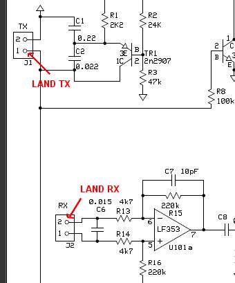

      Sorry.. I see now. All you guys are right! I switched black and red and rewired Rx start and Rx stop to keep the right phase. Ground shield should be tied to R13 that goes to pin 6 (inverting)of u101a . Still 29cm on 1e coin. Audio seems to be slightly improved and sensitivity control seems to have more effect. Does make a difference! I have heard some comment that it does not make a difference, but now I believe that it does.

      dfbowers, excuse my ignorance, this comment raises questions. If you will kindly confirm if you need to connect eventually land in the places indicated in the photo would be very grateful.
      I just have this and once I finish the circuit. Thank you
      • Originally posted by Virdi_248 View Post
        Rx "land" (Ground) is correct
        Tx "land" (Ground) is not
          Thanks. And what do you use for the cable in your picture?
          -SB
          USB-2 seems suitable. 4 conductor + copper ground along with foil and braided wire mesh.

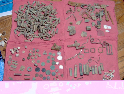

            A few relics.. Camp Meade - 1898 .. Most found with Shadow X5, but a several dozen found with TGSL!
                  Looks like excellent hunting there! Hope you put a thread somewhere describing the items.

                    Your measurements look very good and normal, although I wonder if your inductance measurements are correct? The frequency is right, but inductance very high. Maybe your .022 capacitor C2 is actually lower than spec. What inductance is your Receive coil?
                    It's hard to make the correct inductance of coils, just experience mainly. Follow experience of others, then make small adjustments. Binding (tightly wrapping and compressing) the coil can raise the inductance by up to 1 or 2 mH, so it's tough. I usually scrape a small spot of insulation on the wire, measure, then tape or coat with some insulator and wind some more, and plan for about 1 mH increase of inductance when wrapping. Or you can wind a lot and then measure and unwind if too much inductance -- that's probably best but wastes wire. It's the darn wrapping that is hard to predict, you need to try a few and see how it goes.

                          Maybe what is wrong is that you used the wrong parts.
                          TX capacitor 479pf? Which capacitor are you referring to?
                          There are two capacitors affecting frequency in the TX circuit. Neither one is supposed to be anywhere close to 479pf.
                          But that's not all. Where have you ever seen anyone here suggest that 437pF be used in the RX circuit?? What is wrong with using 15nF as called for in the schematic?
                          Your coil numbers look pretty good, but those capacitors are bad wrong.

                                Yes, measure the TX oscillator capacitors. I'm betting that either the 220n or the 22n capacitors will read VERY low. Maybe both of them.
