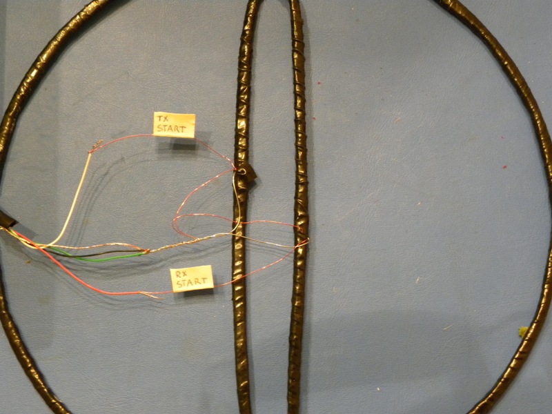

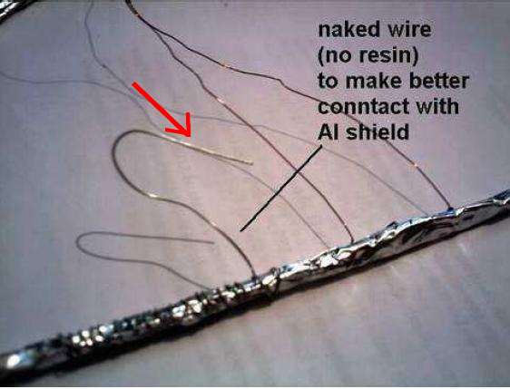

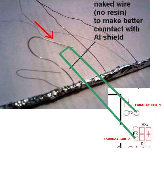

  • dfbowers [quote =; 111643] ¿Tiene el escudo a tierra como se documenta? quote] [/
    wire connection of the arrow?
    It is just that, that is my question.

        Look at colors.. does this help at all? Bare GROUND wire in cable goes to same connection as GREEN wire on PCB.
        Does this help you at all?
        Good luck!
        Don

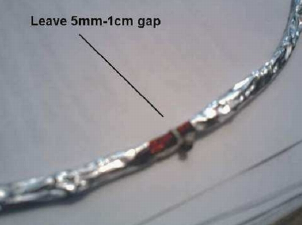

          Hi @Virdi_248,
          Where is your Shield Spacing Gap?
          Extract from @Ivconic's article: TGSL Coil Making.pdf
          ... At the end leave 5mm to 1cm gap. This is OBLIGATORY! Without gap you get NO Faraday shield. Worth nothing! ...
          Robert
          5mm to 10mm Gap (Shield must have
          OPEN Gap)
          • hi, Dfbowers
            I think you have the opposite RX input.
            RX START input is not inverted (pin 5 lf 353)
            END RX inverting input (pin 6 lf 353)
            if dual-tone sound, then turn 180 º RX
            greetings

              You are correct. Problem is solved by flipping over coil.

                It's there.. Just covered by tape.

                      • Originally posted by geminis74 View Post
                        please read before asking
                        Look closely at the photos, is contrary
                        Sorry I have already set in the photo.
                        If I'm right. Faraday (tx) connected (end tx)
                        Faraday (rx) connected to (final rx)

                            Hi Don:
                            It looks from your pictures that you ground the RX lead non-standardly at the shield. Other docs somewhere say to ground the lead that goes to the inverting input of the LF353. Am I correct that you ground the lead that goes to the non-inverting input?
                            Yet you seem to have excellent TGSL. So does it matter which RX lead is grounded at the shield? Can you try grounding the other RX lead at the shield and tell us what the difference is? Also, what happens if you don't ground the lead at all?

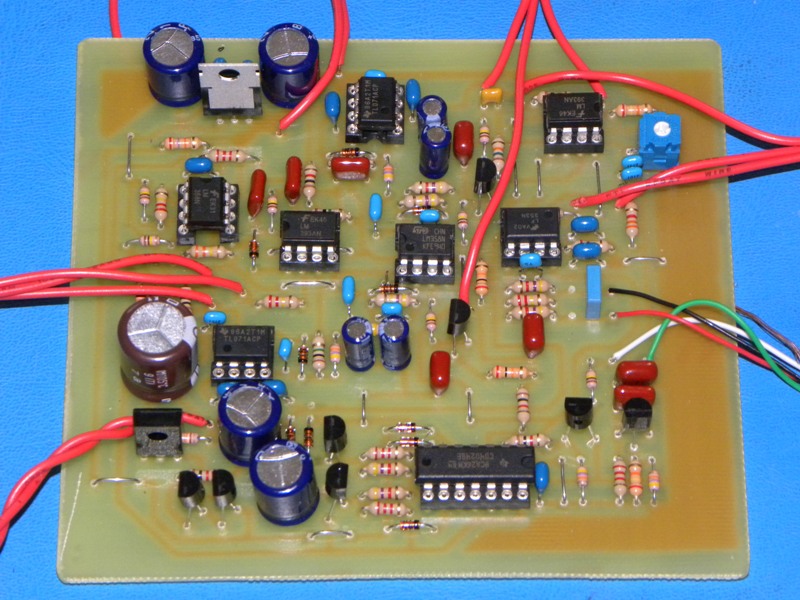

                              Sorry.. I see now. All you guys are right! I switched black and red and rewired Rx start and Rx stop to keep the right phase. Ground shield should be tied to R13 that goes to pin 6 (inverting)of u101a . Still 29cm on 1e coin. Audio seems to be slightly improved and sensitivity control seems to have more effect. Does make a difference! I have heard some comment that it does not make a difference, but now I believe that it does.

                              Simon, I bought my IC sockets from Digikey (see attached).
                              ED90048-ND 8 PIN SOCKET $0.92
                              ED90049-ND 14 PIN SOCKET $1.42
                              Don
