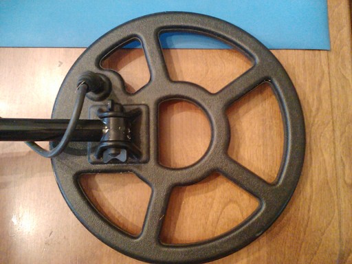

        My recollection of the RX inductance was not correct. It is in fact 6.9mH, which matches [reasonably] closely with the coil chart. The TX was measured as 1.1mH.
        So it appears that my Troy 9" concentric comes from either an X5 Shadow, or possibly an X3.
          That would be consistent with the partial schematic of the X5 that was posted at one time. The X5 and X3 runs at 19kHz and the X2 runs at 10kHz.

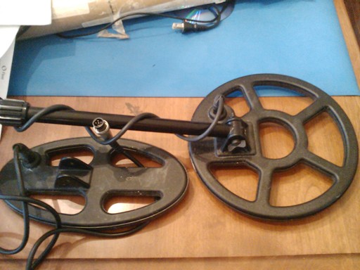

          Here are 2 of the 3 coils available for the X5 and X3, 5 pin.
            The circular coil is the one I have, but I cut the plug off some time ago ... and cannot remember if it was a 5-pin or a 4-pin.

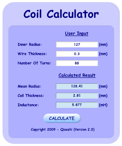

              • Hello there,
                I am planing to do coil by myself. And now I am wondering about Cu wires.
                In pdf about coil making is mentioned that wire should be 0.25mm Cu (0.27-0.28mm with resin layer). But in local shop there is only 0.3mm with resin layer. And I think that 0.3mm wire should be good too cause wire thickness doesn't change inductance only W.
                So can anyone confirm that my thoughts are right?

                  Using .3mm will change your inductance as well as resistance. The reason being is that more wire will be added to your coil in order to achieve the same number of turns. Your mean radius will increase as well as your outside diameter. Also, coil weight thickness will increase..
                  I have no doubt that you can get it to work with .3mm wire but you cannot use the guidelines in the .pdf and expect the same results.

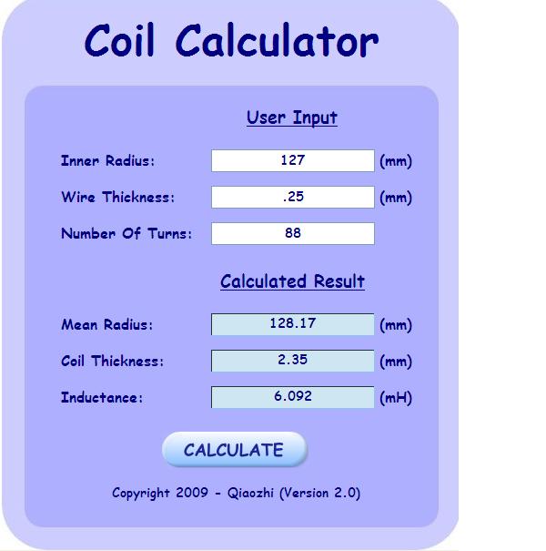

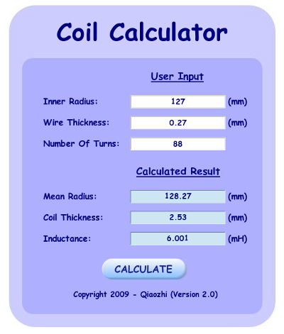

                      Here's the sort of difference you can expect between 0.27 mm and 0.3 mm.
                      • That's not as bad as I would have thought. So going from .25mm to .3mm gives a difference of about .2mH. Adding sheilds always changes things as well. It can add up to 400pF to the total C depending on how well the wires are insulated. If that's all you have, I might be tempted to try .3mm wire. Just add about 5 turns more to the Rx coil.
                        Anyone else have any thoughts??

                          I tried to make some RX coils with thick wire like that and had much trouble.
                          I'm not sure but I think the problem is that because the resistance is lower, it makes the Q of the resonant circuit much higher and changes the phase shift/frequency relationship which can throw off your discriminator unless you are very careful. It also magnifies the noise pickup at resonance (although it reduces it at off-resonance). But the TX signal is off-resonance, so it may be actually causing a type of signal-to-noise problem.
                          I tried experiments where I added a resistor to the RX coil to try to make it act like thinner wire. For some reason I did not have noticeable improvement, but in theory, that is a technique that may help. (Because I was experimenting with prototype circuits, I probably had poor depth for many other reasons too.)
                          All I know is I have not yet had good success with thick wire. However, I feel that with very careful design, it should be possible, and that using thick wire for the TX coil should actually be better potentially.
                          If it is the only wire you have available, I would go ahead and try it. And try putting a 15 ohm resistor in series with the RX coil. (It may also work to put a higher resistance resistor in parallel with the RX coil, but you need to calculate it to get the same Q.)
