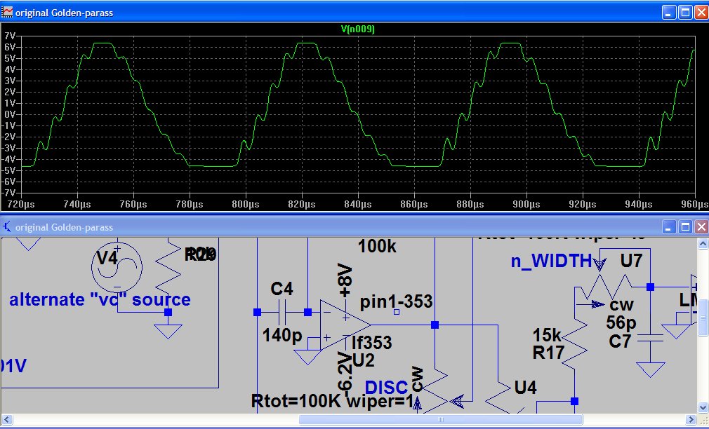

  • Hi Ivconic,
    I think I've found where was your problem with first cap...
    simulating it with 150pF gave me that thing... means that the reactance of capacitor at osc frequency let pass so much signal that 353 goes into saturation in that strange way ... I mean with all that bouncing.
    So maybe your wrong cap had a tollerance of more than 50%... very bad one.
    Problem is that at out freq and with 100pF signal is perfectly sinusoidal... so, if simulator is right, Ap and me have something parassitistic capacitance of 35-45pF there... cause maybe socket is involved for real... but I think that a socket could not introduce such deviations...

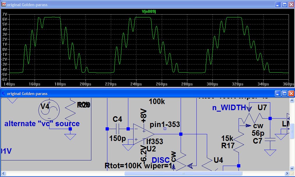

    • Hi,
      now I think that it's all about reactance of cap + parassistic effects due to board, sockets, wires and also operating frequency that is a bit higher than bought TGS (about 400Hz more from my informations using Ivconic design for coil).
      Look below: at 140pF total there you have oscillations like you can see on my traces...
      Solution could be reducing the cap value from 100 to 50-60pF to compensate the above things and higher freq.... or much better reducing the feedback resistance to something e.g. 50Kohm instead of 100K.
      Now I hope that some proud TGS homwbrewer test that things... one way or another... cause, other things apart, I have to spend my penny now.

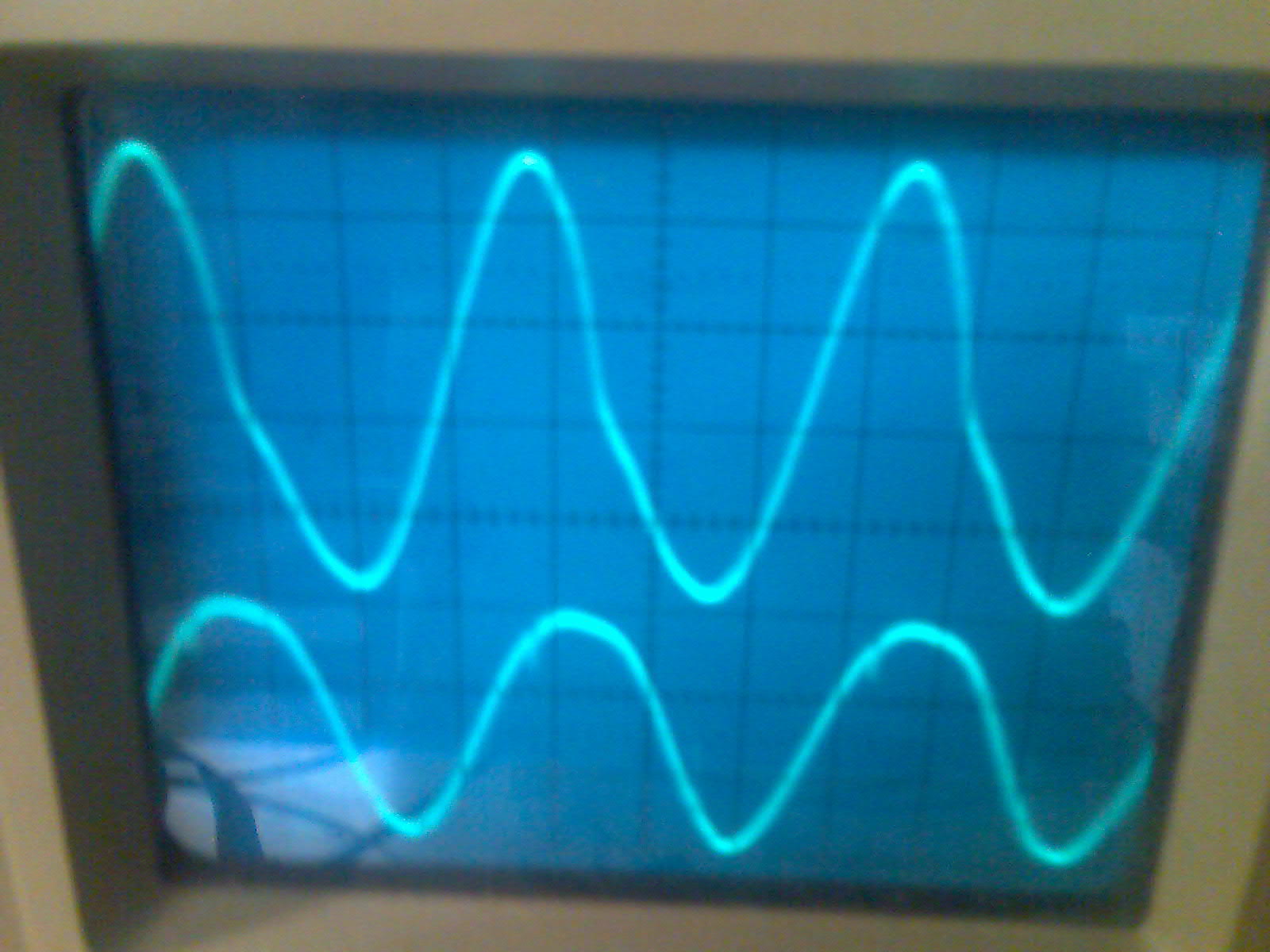

            • Hi. Finally how must be the signal at pin1 of LF353???? square or sinus ???
              I have a very good sinus signal that vary about 80 degrees but it don't discriminate. Maybe tommorow to check the capacitor. I think that it must be the last check and then i let it. I have better projects to do than to play with one capacitor if it is 100 or 140 or 220pF.

                          • I atach again the form of signal that yesterday i took from TGS. The upper signal is from pin1 of LF353 (8V p-p) and the other at the out of RX Ampl (LF353 pin7????? i dont remember, 150mv p-p). Scope was synchronised with channel2. I attach one file more with the coins that always i use for tests

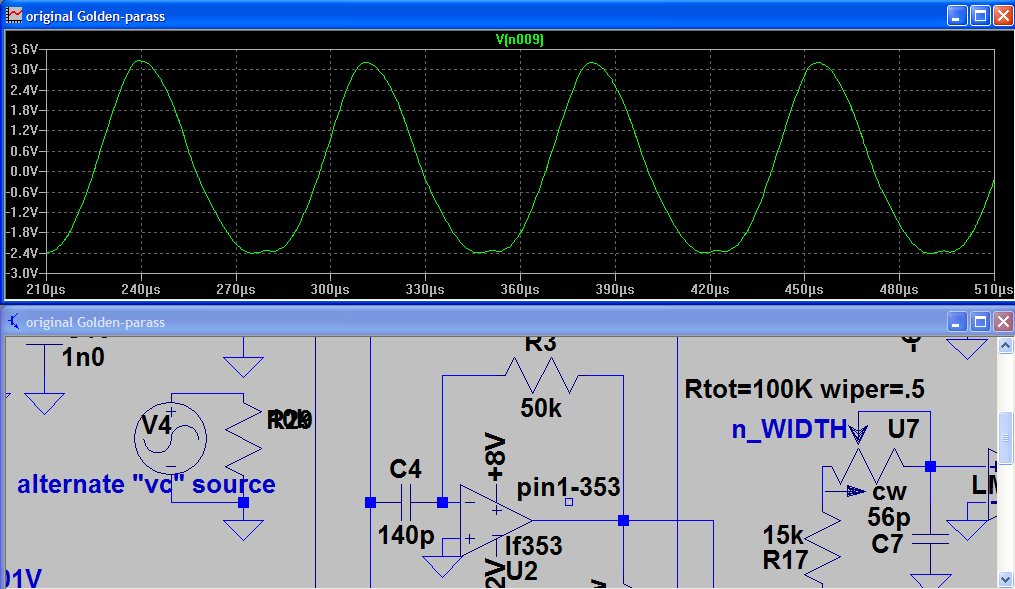

                                I've just made some simulations to show why the LF353 goes into saturation so easy with higher cap value: reactance
                                But there are more things... for example yesterday I've simulated the 50Kohm influence as feedback resistor... and simulator showed a good shaped near-to-sinus wave with 100pF... but early in this morning I've made the real test and yes... there is a similar to sinus wave... but also some small ringing on one part of wave that there isn't in simulation. That explain everything... no simulation is perfect, no simulation parameter list is "complete" -> there's always a gap between simulated things and real signals from pcb.
                                About the 220pF (or 330pf) it works about sens like Ivconic stated... I've not tested disc effects using that mod on the real circuit... so I cannot say if it still works on the PCB... I've made that simulation that say the disc sample will happen always at same time (phase shift) even moving the pot: on this I think simulation is right... cause I was thinking the same before made that on LTspice... just using my understanding of circuit.
                                I'll check this too on real board to say if it still works... and if so to understand why: we have also consider that a comparator needs few uV differences at inputs to work... so even a few angles edge of "square" wave could be enough to move forward of few degrees... so acting still as disc.
                                Infact... if you look at simulation you see vertical edges (without zoom )... and all we know here that's impossible having that on "real circuits"...so all depends on how much is that inclination of the edge.
