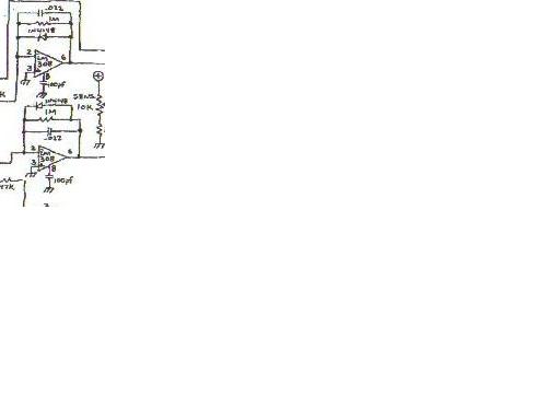

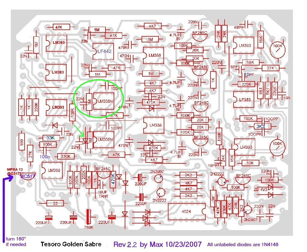

          • Hello Friends
            There are one diference with schema and Pcb of TGS. There are 1 more 1n4148 diyot on schema near lm308 paralel with 1M and 22n but not shown PCB parts replacement.it is important or not ?
            Erol Ünal
            • Originally posted by erolunall View Post
              Hello Friends
              Erol Ünal
              Hi Erol,
              thanks for that information: I've missed that diode at all !
              Now it's about clear that first PCB hasn't it as I've indicated in picture: the upper LM308 hasn't any diode there, instead the lower has it as in schematics (where is the arrow).
              I think this fact could explain why there are sometimes noticeable differences between TGS and TGSL.
              The function of diode there is limiting dinamic range of op amp. This fact could be strongly related to instability in TGSL... but I think topic need some more investigations.
              Anyway, it's absence seems is not a problem on TGS: I haven't it on board just like PCB picture and everything works cool.
              Best regards,
              Max

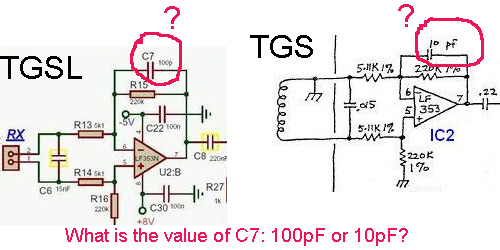

              • Max, ivconic,
                Thank you to the help and the information.
                Now, I have other question:
                What is the right value for C7 capacitor? and what is its role?
                Please, excuse me, if you are already discussed it.
                • Originally posted by rdec4 View Post
                  Max, ivconic,
                  well... we need a picture of an original TGS to say that. In some other schematics it's 5pF there. So maybe that's right value. I've mantained it at 10pf cause noticed that detectors works cool with that value.
                  I think that original was 5pF... but change a few if you have 10pF there.
                  So it's your choice using one value or another.
                  Kind regards,
                  Max

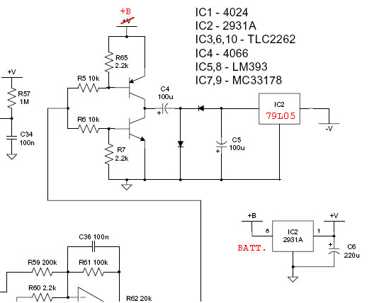

                              • folk, I did not find up this question but I still remember, it was about -V source and there was a problem with low value of -V.
                                I offer to change a part of the schematic according to this picture.
