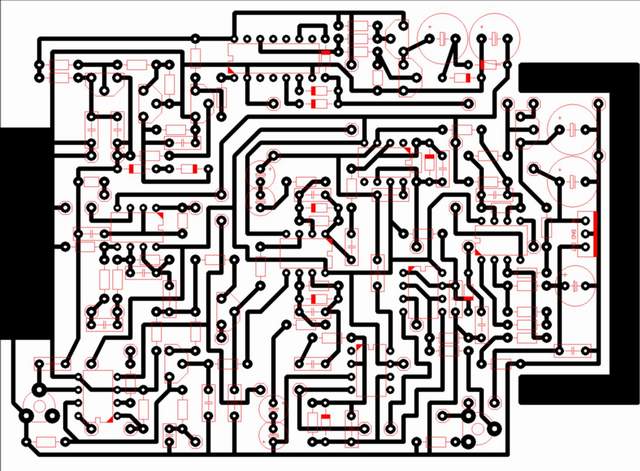

    • Refering noise,hums,interefernces and intermodulations;
      so as i noticed this design can suffer from all mentioned if pcb is not designed well. When designing it, man have to pay a lot of attention on certain components and stages and their orientation and position on pcb.
      Recently i learned to use Sprint Layout 4.0 (with huge help from my dear friends Nakky and Ap Berg) and dared to try to draw more complex pcb, like this one for TGSL.
      Why drawing new one when we already have hear nice TGSL "Goldy" pcb?
      Simply i wanted to use CZ5 enclosure, left from one sadly burned Fisher CZ5.
      So i used original CZ5 pcb sizes and redraw on empty sheet.
      And i started...after few trial&errors somehow i managed to finish this.
      Device ia already finished and tested. Wow! It is working noticeable better than "Goldy" and original (Kutrie post) pcb.
      Now i can turn Sense pot fully to max. no chatters at all.
      Distances rises up to 5% than on previous handmandes.
      PCB perfectly matched into CZ5 enclosure...
      I can post photos later.
      For now here is pcb only...
      " call me crazy, but respect my efforts.."

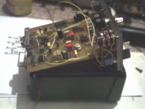

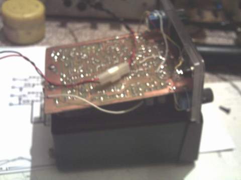

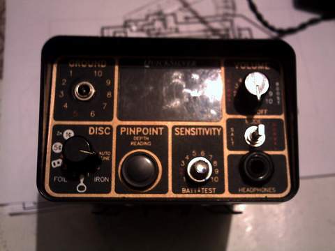

              BTW...here are some photos...
