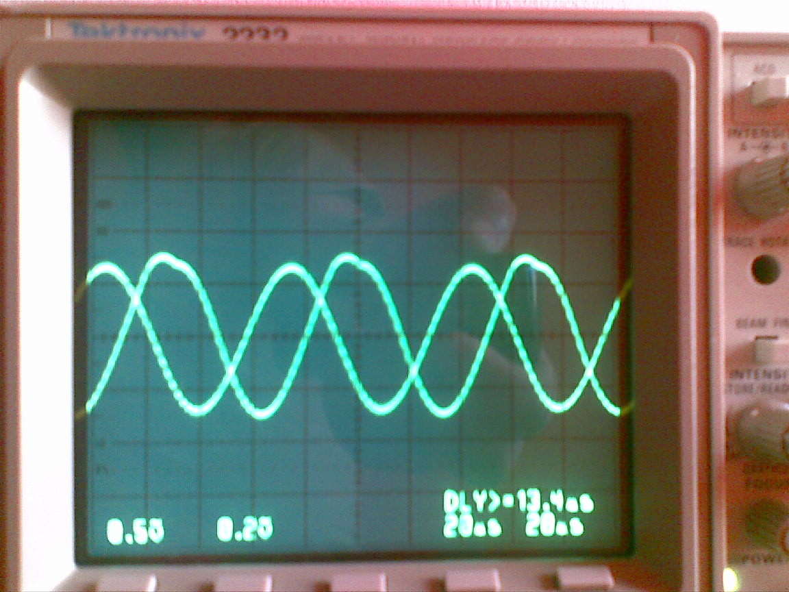

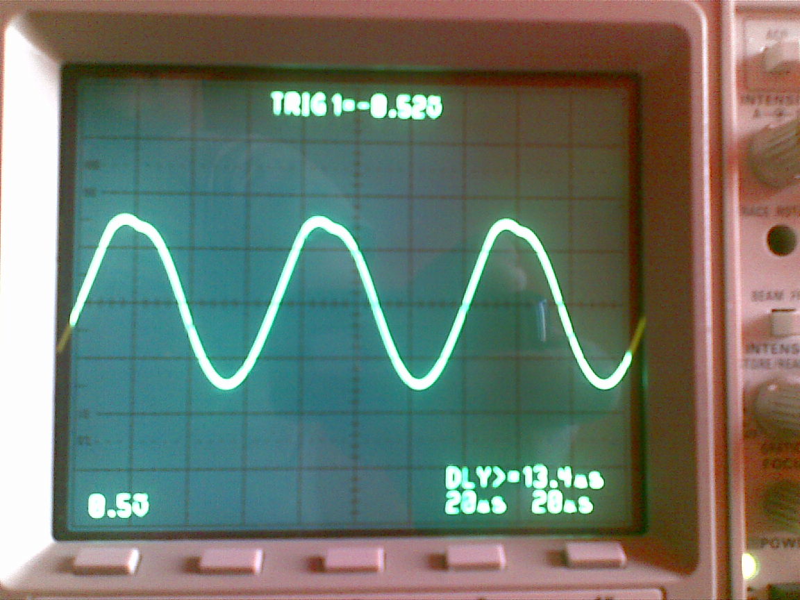

            • Hi,
              Max.
              I have try to adjust like you show.But I can see this relationship only in chop.Is this normal or my oscilloscope is not working properly?
              I see that my TX signal have some distortion in peak.Can this be the source of my problems?
              Here are some pictures:
              • I think there is nothing wrong with your TX signal. I get exactly the same shape. That little notch is supposed to be there.
                Is that 15vpp amplitude? I think it is. So you have very right signal at TX output. Good!
                Cheers!

                  • Hi,
                    Ivconic.
                    Thanks for the fast reply!
                    So TX is ok.
                    I am shame but its my first steps with oscilloscope and still ALOT to learn.Plus I dont have manual for this.So how to understand what is my p-p voltage?
                    On second picture there is TX signal/collector 2907/ VS 353 pin7 this is in chop.Anyway I will make some more pictures.
                    But still my sensitivity is too low.
                    I have noticed before that there is a small diferance in voltages somewhere in RX section.I will check again and will give some more info.
                    Have a great day.
                    • Originally posted by Ultimate_Haze View Post
                      Max.
                      the little notch, like Ivconic already stated, is just a small non-linearity at oscillator, mine is the same... are all about the same cause transistors aren't ideal devices... and small non-linear behaviour is normal.
                      Also, if you simulate in LTspice, as example, you get same shape with notch... cause transistor models are accurate and close to reality.
                      About chopper mode... you use it depending on frequency, in some cases alt mode is better to see the two signals but TGS runs at 14Khz and up (VLF, so very low frequency) so you'll be fine in chop mode with your scope.
                      Check the amplitude of signal at TX, must be 15 to little less than 16 V peak-to-peak , if so you have correctly running oscillator then will check other signal (rx one) for details.

                        • Hi,
                          Ok.Thats easy.As you can see on first picture for chanel one 16 X 0,5V=8Vp-p.
                          Its too low.
                          you say 14-16.
                          What could be the reason?
                            Its too low.
                            you say 14-16.
                            it's about 3 square height, the square value is 1, the 5 divisions on squares are 0.2 each, but you must consider your probe also:
                            if probe is 1:10 attenuated you must consider 10 times what you read on screen.
                            Now, if 1:1 you have (roughly) 3x0.5 = 1.5V (it's unreal you get such 1.5V)
                            but I suppose probe is set at 1:10 (attenuated 10 times) so you have actually 3x0.5x10 = 15V peak to peak
                            If so... 15Vpp are about close to "perfection"!
                            Kind regards,
                            Max
                            • Hi,
                              My probe is X10.
                              So its OK.
                              First I tought that I should count the devisions and multiply.
                              Now its clear.
                                Max.
                                If you used TGSL Final version of Ivconic's, you will have notch because there is no feedback-regulating JFET in oscillator. The benefit is you get larger voltage. With original circuit, you can get rid of notch by adjustments.
                                -SB
