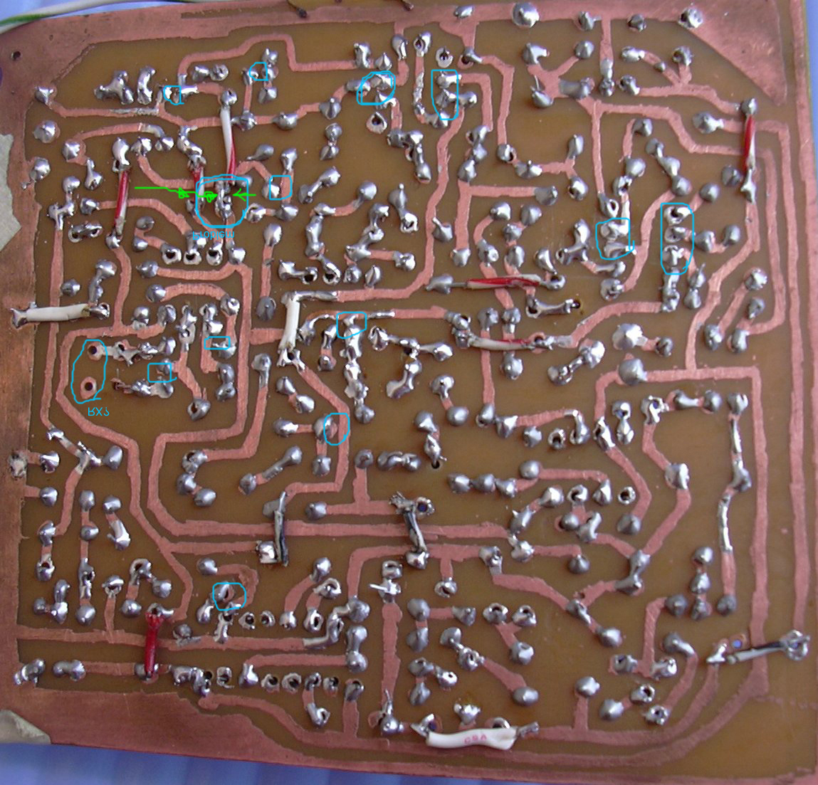

    Hi Ivco SB Max Qiaohz and all
    i have repaired the PCB abit now is better but bliv me it wasnt like that
    just due to too many times of soldering and disoldering became like that
    and it is home made PCB any way
    here are some measurements if you can help me please
    U106 pins
    1 6v
    2 0v
    3 0.6v
    4 5.20v
    5 0.20v
    6 0.03v
    7 4.8v
    8 7.9v
    U107 pins
    1 6v
    2 7.3v
    3 7.3v
    4 5.25v
    5 4.8v
    6 0.09v
    7 1v
    8 11.20
    thanks all

      Thanks, that is very helpful.
      I see possible problems.
      Let's check again with your oscilloscope.
      (Also be careful about pin numbers so we are not making a mistake.)
      Let's start with U106 (LM393) pin 1 (u106a output) and pin 7 (u106b output).
      They should be the same according to schematic! But maybe fluctuating so you cannot measure well -- use scope and check.
      Ok, now U106 pin 3 and 5.
      U106 pin 3 (+ input) and pin 5 (other + input) should be a very small voltage that fluctuates around zero volts, when not detecting target.
      I recommend using your oscilloscope and put sweep speed very slow, like .1 second per cm (so dot moves slowly across screen).
      Put the voltage sensitivity around 50 mV / cm. Make sure you ground the probe and adjust the trace to zero volts first.
      The dot should stay within about 40 mV of zero - the less the better (less noisy).
      You said pin 3 was .6 volts -- much too high! Something wrong there. I repeat, should be +- 40 mV or less.
      You said pin 5 was .2 volts -- also too high! Something wrong like pin 3.

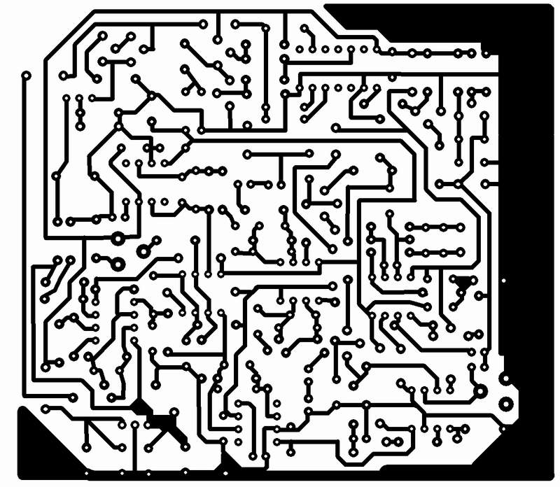

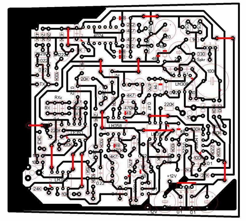

      Ok, now I look at PCB. I admire that you drew by hand, did not use Ivconic's layout file. But so many traces are very very close to touching -- scary. You will have to work hard to save this board.
      I circled areas where traces should be separate but look too close, you should check. You need to use ohm meter and make sure those traces are separate - scrape with tool if necessary.
      There is one blue circle with green arrows pointing to it -- looks like important mistake, please check carefully -- it looks like traces are connected where jumper crosses over.
      Anyway, that is some ideas to begin with.
      Cheers,
      -SB

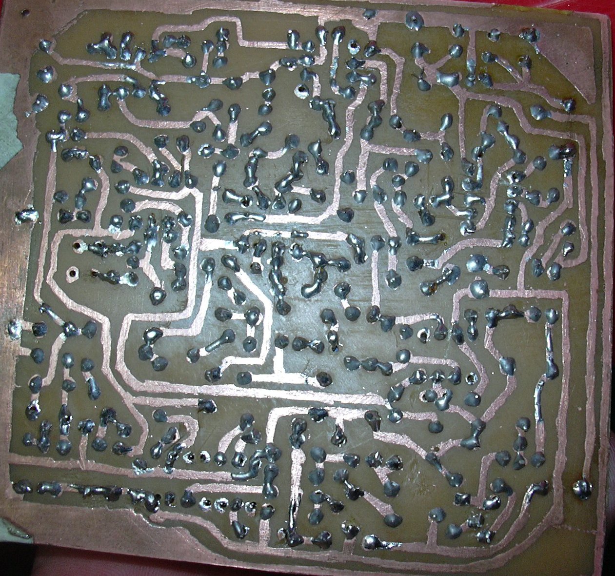

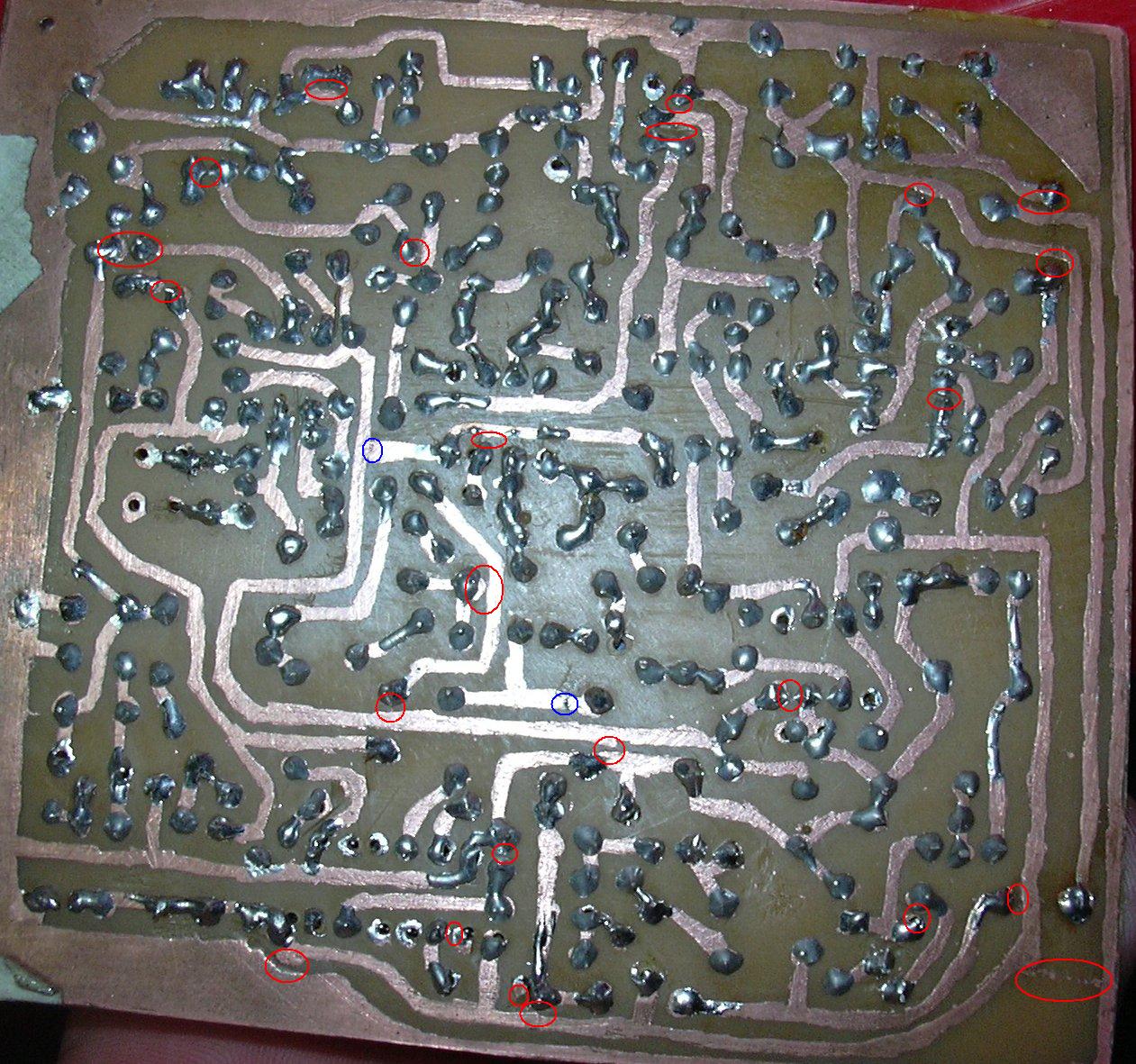

      • Good thing is that you moved jumpers on top side. Now bottom layer looks a bit better. Yet i would like if you check again these spots.
        Red circles means that you check from shorts and blue means that you check from breaks. So use some sharp knife and additionally cut and clean Cu traces and flux on red circles and use soldering iron and solder again on blue circles...
        • It would be much more easier to make new pcb and do all the job again. More easier than to troubleshoot this one. But this time you dont draw it by free hand or yes you can draw it manually but use ruler and thinner marker. Or you may print it on laser printer on thermo foil and after apply it on clean (cleaned with smalles sanding paper and washed with resin good) pcb by heathing to 150 degrees celsius with iron. Use some steel roller and roll over heated pcb and thermo foil so to good apply laser powder on pcb surface. Than gently remove thermo foil and if neccessary correct some traces with marker again.... this is best amateur method to do pcb.
          Here are pics...i tried to spot any mistake looking at your photos...but my eyes are tired. Maybe someone else could spot mistake..
          • Ok..i have some measurements here. No need to be exactly as i noted, but must be in ranges.
            U106 pins
            1 6v..............6V !?!? It must be from -6V to -2.1V
            2 0v..............4.7mV to 5.2mV
            3 0.6v
            4 5.20v...........!?!? must be -6.xx V
            5 0.20v
            6 0.03v..............4.7mV to 5.2mV
            7 4.8v...............!?!? It must be from -6V to -2.1V
            8 7.9v..............OK!
            U107 pins
            1 6v
            2 7.3v
            3 7.3v
            4 5.25v...........must be -6.xx V
            5 4.8v............!?!?! It must be from -5.5 to -2.3V
            6 0.09v
            7 1v..............!?!?! It must be -5.5v and falls to 0V
            8 11.20...........? Certain drop here....should be 12v least.. or you are using bad battery..
            So.... it is obvious - you have a problem here..
            Most probably you have break on negative supply rail somewhere on pcb. Use method to follow minus rail from chopper output to U106 and U107 pins 4.
            It is like i guessed in one of previous posts - you have problems with negative voltage, that's why you get constant audio...

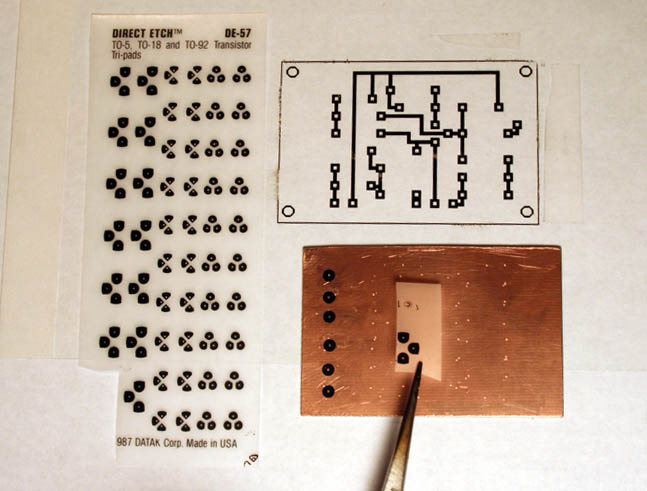

              there's another easy way to make good quality boards (at least acceptable quality for these things like tgs) and that's similar to free-hand drawing... :
              it's dry-transfers method
              You buy dry-transfers in e.g. office shops... the ones that provide e.g. services and products for engineers... , in such places (in my place there are still many, but think in most of the world it's the same) you could find electronic patterns too... as well as other stuff like letters and numbers etc.
              You'll be interested more in e.g. tracks and pads: there are various sizes... 1, 2, 3 mm wide and shapes... and for ics too, transistors... whatever
              Once you get what you need you simply polish very well the new board and apply transfers making some pressure (rotating movement) with a pencil... and voilla... it will place over copper (there's glue on the back side of transfers) and stay there... that's for pads. For tracks you'll cut them with a blade and all fine...
              It took more time than simple hand-draw but you'll get fairly better (and nice to see also) tracks and pads... also it will give you strong copper tracks/pads... cause sometimes the pencil you use for handdraw leave too few varnish... and etching will remove too copper from there... then you have to repair later...
              here a picture of what I mean.
              Kind regards,
              Max
              • thanks Ivco Max SB Qiaohz
                Dear all
                thanks for you all but let me say Ivconic you are briliant i have found the problem what was the problem Yes Ivconic i admit you are very very good
                look the problem was exactly as you said from negative route i have checked the chopper step by step tel i found that the -lead of C4 was not connected to the route
                thanks all again and i hope you as you are for futuer needs
                best regards
