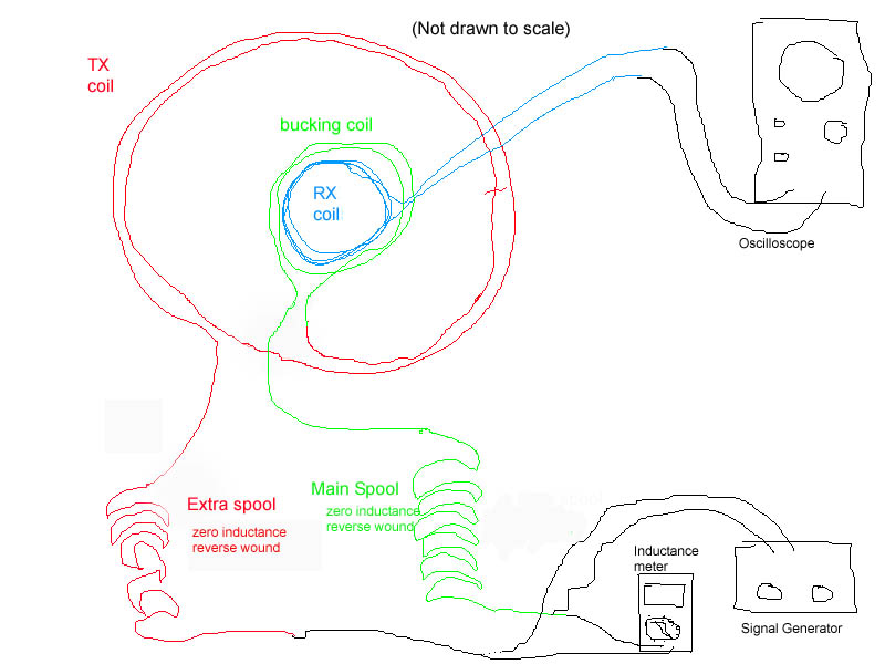

                      I am trying to figure out Coplanar concetric coils for tgs. I have a very rough idea about a size and diameter. Tx is 22.5 cm, Rx (wound on the same diameter as a bucking coil ) is 11cm.
                      Tx has 97 winds, Rx has 140 winds and a bucking coil has 25 winds.
                      I want to hear your opinion about this coil. I took into account that 500uH when constrained with Al foil. For the foil I am using coax foil straight from the isolation.
                      The whole idea came along with an old monitor stand...
                      • Originally posted by kuraja View Post
                        If you've never attempted to make a concentric coil before, then all I can say to you is "Good Luck!".
                        I don't want to put you off from your concentric coil experience, but even if you have the inductances correct, getting the correct phasing between the TX and RX coils is going to be a headache. However, if you are successful, you will have a nice coil. Unlike a DD coil, you cannot easily adjust the relative coil positions.
                        By the way, on a commercial Tesoro Spider coil, the RX diameter is less than half the TX diameter. There are some Chinese copies that have the RX greater than half the TX diameter, but they are not so good in practice.

                          I think I posted something about some time ago... CC for TGS I mean. The idea is right... and obviously you can make it work with lot of care and efforts... but sometimes the work it needs it's too much... too much pain to make such kind of coils, and that if you already know how to make it right (inductances, tx-rx phase, nulling, shielding, formers...) and have instruments required (the scope most of all).
                          So I agree with Qiaozhi... if never made one... good luck.
                          I think the easy way is making e.g. DD or OO coils for tesoro's cause are easy to null and phase right cause you do much by just moving the coils... in geometry fixed designs (like CC) you must made tricks for e.g. null things... like lose loop or half loop... to shield (use e.g. nickel spray or graphite mostly)... to phase it right (add some pieces of foil here and there...altering both nulling and phase)... to mechanically fix it (full epoxy will result in a big weight...so you must use strategy for that if coil is not so small) etc etc
                          The CC are hard to do right, the increase in depth is focused just in the central area good for pinpointing but not as good for general purpose "fast" hunting.
                          Kind regards,
                          Max
                                I hope you try it so we can learn how you do it.
                                Maybe I would try this: I think I would first make RX coil and fasten it down.
                                Then get a long piece of wire for the TX coil, bucking coil and another 20% extra wire and wind all the wire on special spools back and forth (not in coil) so the spooled wire has approx zero inductance. When you pull the wire off the spool, each "loop" has zero inductance and will not change inductance of spool (zero).
                                Pull off about 10% of wire off spool and wind on another "extra spool" which also has zero inductance. This is for adjusting the TX coil later.
                                From the main spool, start taking wire and winding the TX coil.
                                If you have a calculation for the bare TX coil inductance (without the bucking coil, should be greater than 5.8 mH because you will subtract bucking coil later), do your best to wind it, checking inductance with meter as you go (connect meter to ends of the spooled wire).
                                After you finish preliminary TX coil, hook up a signal generator to the spooled wire ends and an oscilloscope to the RX coil.
                                Now continue taking wire off the main spool and winding the bucking coil. Wind the bucking coil until the RX signal on the oscilloscope hits a minimum (nulled).
                                Now remove the signal generator from the spooled wire and check the total inductance of the TX and bucking coil with a meter. If the inductance is too low, you need to start adding windings to the TX coil. You do this from the "extra spool". Of course you will spoil the null of the RX coil, so you will need to add some windings to the bucking coil too (from the main spool). You'll have to go back and forth until you get the correct TX + bucking coil inductance (about 5.8 mH), and also the RX signal is nulled.
                                Then you can cut the wire off the spool, but leave about 2 to 3 meters on each end for final adjustments in case the spools were not zero inductance.
                                Whew, a lot of work!
                                Maybe there is a better way, that's my thought.
