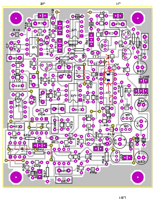

    Just got this working somehow but audio is screaming all the time, so I took off 1k resistor to speaker. Battery voltage is 13V, so -5V is actually -6V..
    any ideas?

      Have you properly nulled coils ?
        I hope so. It's the batterytest-wire (TGSL schematics: Q10, R46) which causes screaming.. TGSL seems to have also S1. My device is TGS anyway,
        just reading the TGSL schematics because it labels the components.
        In TGS schematics R47 is 470R, but in pcb 470k. TGSL R47 = 470k.
        It takes a several minutes to discharge the capacitor so I'm wondering if 470k is correct?

          no... the battery checker runs for 3-4 seconds only then the sound stops.
          If on your TGS isn't that way... you maybe have a fet there that remains "on" ... instead of open the circuit.
          Check the components all around there... caps and resistors.
          You can make it stop just pulling out of circuit that fet... that way battery checker will not interfere with other parts.
          What about fets: what are you using there ?

              • Question for Vladimir, is this (marked on photo) C19 =100n in smd?
                This is your last edition of pcb...
                  Fets are J113..
                  • Originally posted by Lake View Post
                    Fets are J113..
                    Whops! Wrong project.. Fets are BF245C.

                      You can use J107 instead bf 245

                          They are good on TGS so problem is not with them.
                          What about darlington thing ? You must consider there are 2 suggested types but you must reverse 180° from one to the other.
