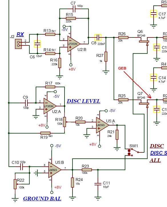

    The ground balance works by sampling the received signal at the zero-crossing point. The theory is that both ferrous and non-ferrous targets affect the amplitude and the phase of the received signal, whereas neutral soil will only cause a decrease in magnitude. There is no phase-shift. Since you are sampling at the zero-crossing, the GEB channel cannot detect a change in the amplitude of the signal unless there is also a phase-shift. Ferrite causes a similar response, and that's why it's often used to find the correct GEB setting. Unfortunately ferrite does not react exactly like real soil, and the offset can be as much as -5 degrees. If you're using a preset GEB, then you will need to adjust it off from the ideal position by a few degrees and set the threshold to silent search, but the best solution is to have an external GEB control. If you set the GEB control to any position other than sampling at the zero-crossing point, then it's not acting as a ground balance control.
    Quite right! I noticed also when GEB adjusted to totally "blank" ferrite rod than device not performs quite well on the field, but when adjusted to rarely "crack" on ferrite - than performs excelllent on the field.
    But how can i monitor exact zero-crossing there? Still not clear many things to me! What points should i monitor on scope? I tried some things but without knowing exactly what am i doing!!??? Heh,heh,heh....

        only way, I think, is to watch it on the scope... one probe to the fet gate of its channel (geb) signal and another to the RX signal.
        If you haven't scope ready to test it...I'm sure that also a sound blaster or similar can give you a scope drawing of what happens using some freeware program.
                    Actually, this is very simple to measure. See attached image.
                    Switch to All Metal mode, and connect scope to point marked GEB. Then adjust GEB control until you have 0V DC. This should also work with a meter instead of the scope.

                      I'll do that! Thanks!
                      • Come to think...! Simillar should be done in Disc mode on other channel? Is'nt it? Or not...due relative position of Disc pot..?
                        Stupid me! Of course not! But another thing; low down Disc to minimum,measure second channel;
                        a) if not zero, than add or substract some resistance on one side of pot. to gain zero,
                        b) if zero, increase a bit and measure again;
                        Why? Try to achieve linearity in Disc range, cose i noticed some non-linear behavior also, there..
                        At the moment, if Disc pot. is lower than "2" than producing chatters more often, if Disc. pot is higher than "3" than no chatters at all...
                        That's why i suspected this stage, at first place...
                        I do beleive there are some differences in FET behavior also. I put J107, not BF245 or other.. ?

                          Also easy to do...
                          To get the correct minimum position for DISC, monitor the output of Q6 (above Q7) and adjust DISC control to get maximum voltage. This should then reject ferrous targets but allow all higher conductivity targets, such as foil, pull tabs, coins, etc.
