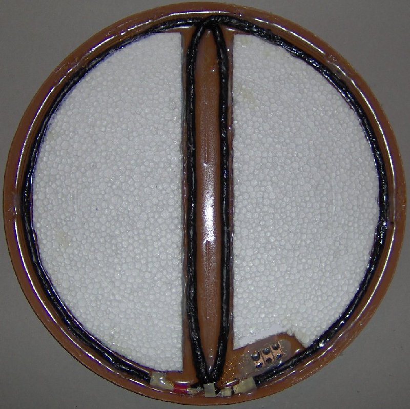

            I have made a few more coils but what ever I do I am still around 20cm not over 30 like you and Ivconic!
            Can the reason be my LF353?The only diferances in my device are that I found only LF353 P and my LM308 are LM308AN.Could this be the reason for my poor preformance?

                  Hi Max,
                  if you used all the same numbers we posted here you MUST reach that performances too. I think that your LF353 is ok...and also lm308an are ok if originals.
                  So concentrate on nulling...how do make it ? Do you use scope or multimeter ? If use multimeter is your accurate and how much ?
                  Do you follow overlaps like in Ivconic's pictures ? That's important for getting good performances from DD that you don't make them too round in the middle like some early models of magazines... keep the wires parallel as you can.
                  If everything fails modifing coils maybe you have something wrong on circuit... but who can say where or which part !? ONLY YOU.... you have to investigate for mistakes on your board ...we can just give some advices... but you have probes in hands... and you actually see the circuit and coil.
                  Here you will find a picture of my last DD255x137mm during assembly... (very hard work cause also this time I haven't housing for it... and had to recover some plastic from here and there) you can see also some polystyrene and clear epoxy work...all that show you again how to align coils... look and replicate similar shape.
                  Best regards,
                  Max
                  PS: what you see in picture have weight of 220gr... total enclosed coil weight is 350gr.

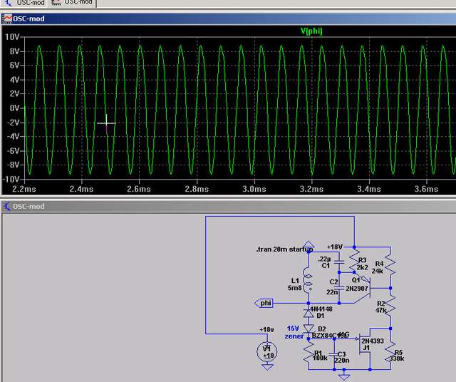

                      SnagIt is installed, here is shot from LTSpice...showing 10v supply and 18v amplitude..

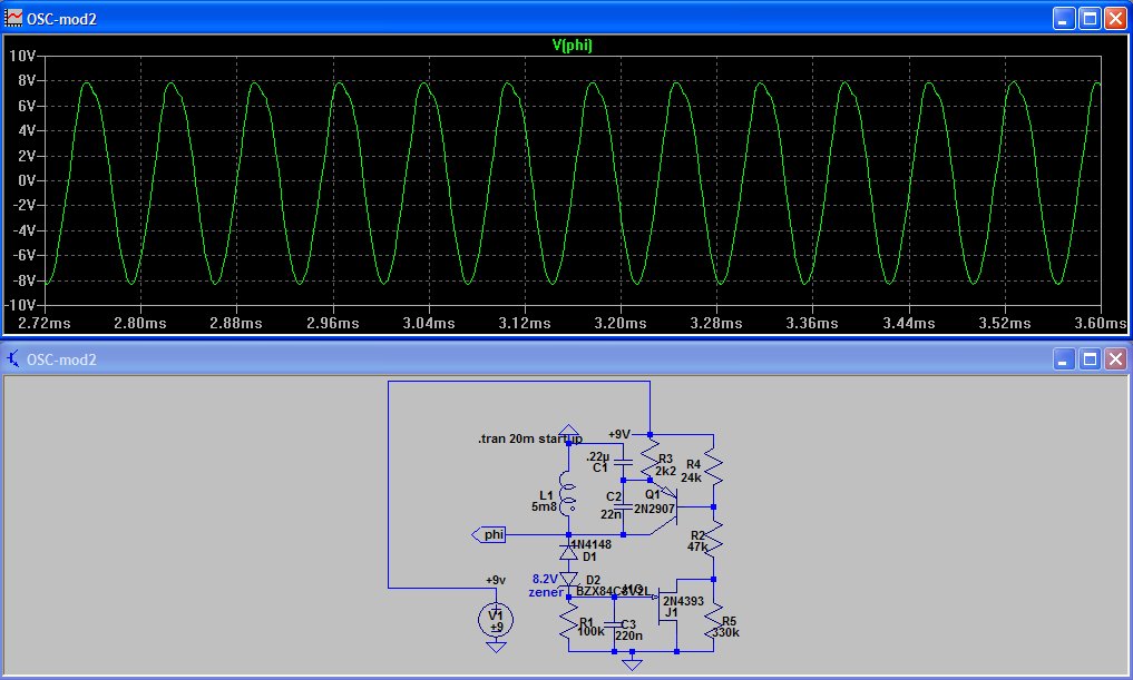

                      • I just checked; 9v supply gives 11v aplitude..!?? Such a difference???
                        10 volts gave 18v and 9volts only 11v amplitude...??? Is this possible?

                          very nice picture. 7809 will be fine too... you'll get something less 18Vpp but it's ok for testing a bit more power I think... you'll notice for sure an increase in the max sensitive area at center of coil for far targets.
                          I saw the picture... but you have to consider also that you'll have problems using the 15V zener with so low supply... cause of the lack of stabilization...
                          I suggest to change also the zener for something e.g. 8.2V (or disable the amplitude feeback of fet circuit).
                          What do you think ?

                          • And repeated again at it gave 16v amplitude...???
                            This software has bugs! I am sure!
                            I repeated few times...
                            Bug occurs only first time you change power supply...for example previous 12v changed to 9v gave false at scope. When repeated again, clicking on 9v and changed to 9 again...aplitude shown on scope is now 16v...!?!?!?
                            Either bug either i missed something?
                              What do you think ?

                              Huh! I missed that!
                              Now is all clear! Damn! I am still novice here....
                              • Hi,
                                that's what I mean: you get about 16Vpp output (60% more than original) just changing 7808 with 7809 and the zener with an 8.2 one.
                                Kind regards,
