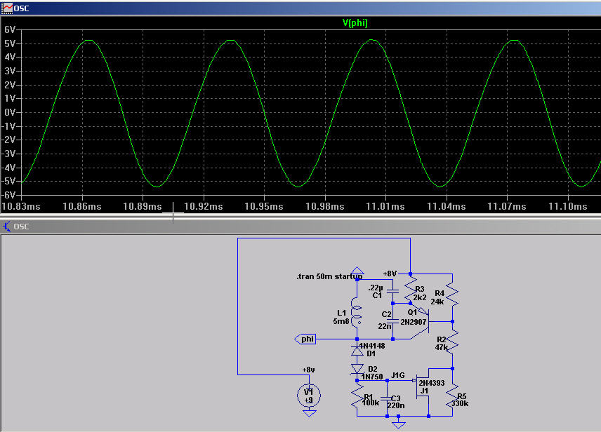

  • Huh! Again error. Now i am more sure it has bugs....Look;
    I took previous oscillator schematic with 8v supply and othe zener...
    Just changed 8v to 9v and look what i got!?
    Now, on this, when i repeat it changes scope amplitude to 16v...???
    OK no big deal. I'll remember this thing and each time i need accurate scope i'll repeat those steps twice to be sure...until find out what is the problem?
    • 1N750 is actually 4V7 so zener is not problem here...
        yes it's ok. I've repeated your test using +8 and then changed to +9... and it goes well.
        You have to close the diagram window and make again Simulation->Run so it will recalculate the points of transient a. again with right params.
        Otherwise it will be not so happy of changes.
        Another thing to keep in mind is that labels mean nothing here and could be confusing also.
        Best regards,
        Max
          yes is the feedback circuit of TGS osc that makes output be almost not dependant from supply variations up the a certain level (depending on zener voltage and diode forward drop).
          That's cool cause you can program e.g. double voltage accross coil just changing the zener and the regulator!
          I think there's enough to test with some spare zener and look for results.
          Kind regards,
          Max

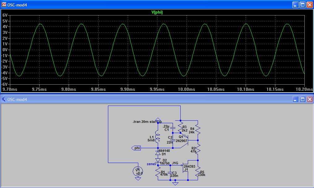

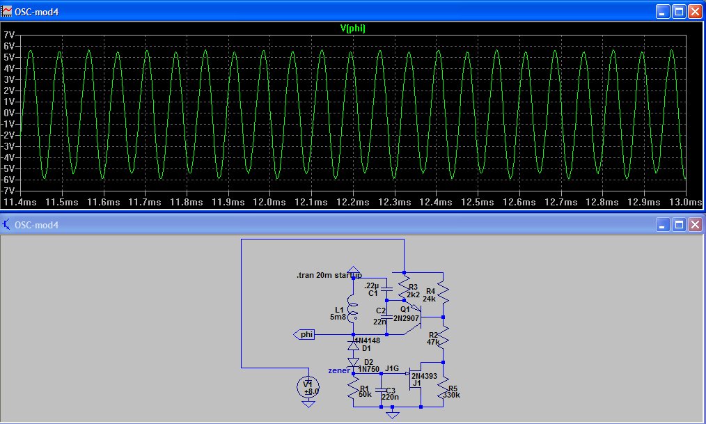

                      • Hi,
                        now I've made a little test to simulate the "moisture" effects on PCB... I mean soldering flux not removed... look
                        Suppose that instead of 100K at R1 the circuit see 50K... the pulses suffer of an heavy intermodulation and you can see that peaks are not all at same level anymore -> as expected this would damage SNR
                        Then I've tested with a 470K at R1 and you can notice a very good sinus...
                        Other interesting thing is the capacitor that filter signal on the gate... if you reduce too much (e.g. 22nF) you will see the signal fluctuate in a funny way (underdamping) ...but if you increase to 1uF signal will be more stable.
                        The alteration of gate components change the feedback behaviour like when in a proportional control you add a delay block... if delay is too short you could experience underdamping...
                        Conclusion is that feeback system is a good thing... but you have to keep clean circuit and use right values... otherwise... it will give you just problems.

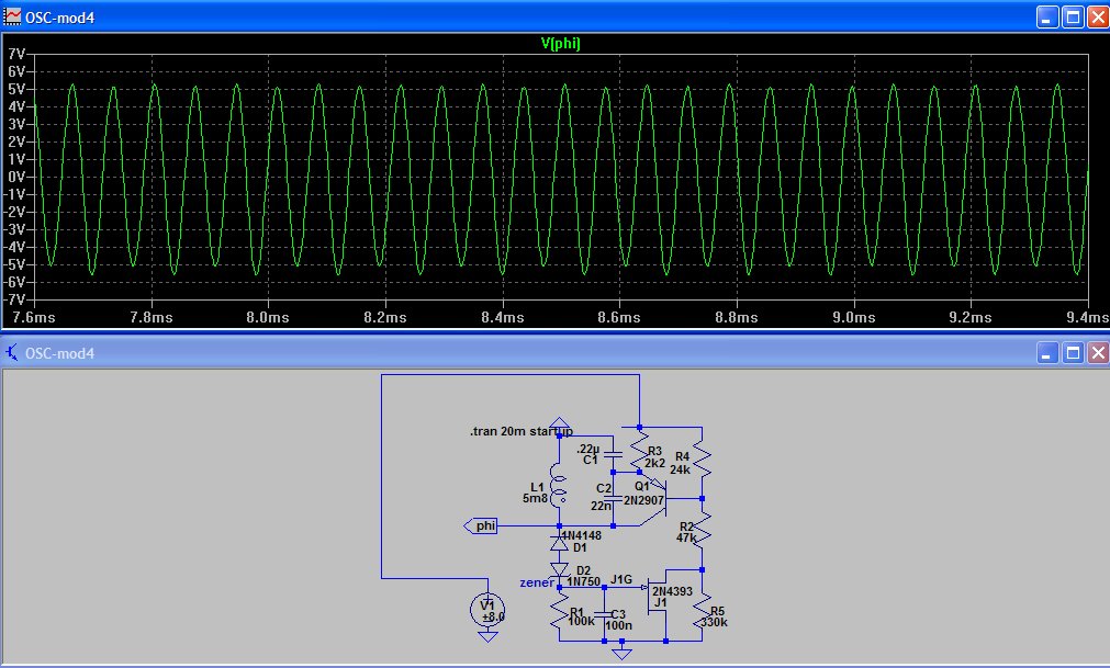

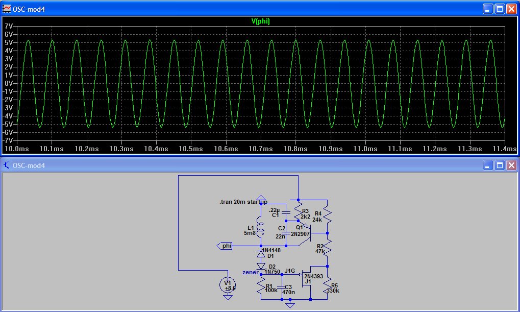

                        • feedback testing..
                          Hi...
                          Max.
                          If you have the time; could you please check alternate values for C3.
                          (100nF and 470nF)
                          Would this change the output amplitude?
                          • Originally posted by Leto View Post
                            Hi...
                            Max.
                            (100nF and 470nF)
                            the amplitude is stabilized by the feedback effect...so you have always that limit imposed by zener + fet etc.
                            Then is the damping effect that could change... if you use 100nF you have underdamping than with 220nF; 470nF is much better cause you critically damp or overdamp oscillations (so have less fluctuations from one sinus to another)...that's what we need first: perfect sinus.
                            Kind regards,
                            Max
