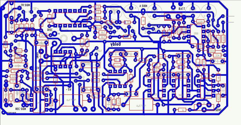

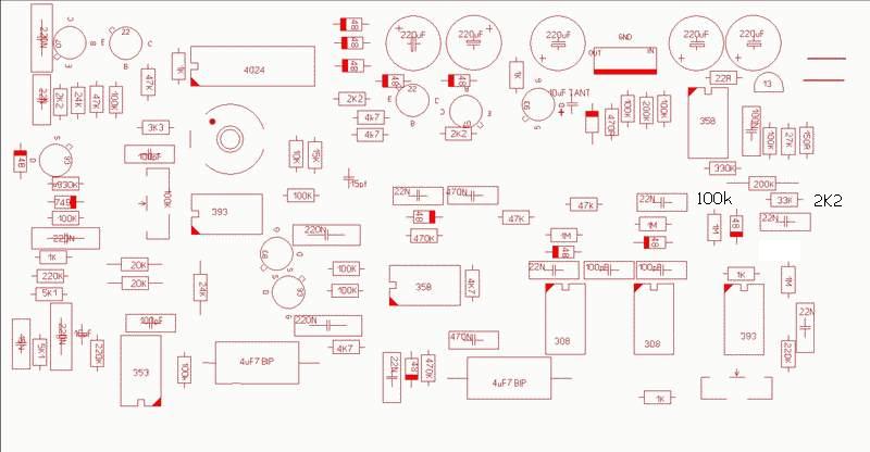

        Also you may see few mistakes on placement, but i already corrected those; instead 100k there is 1M by mistake, instead 2K2 also 33K...And pin 8. of last 358 is connected to +12 instead +8v...all those corrected already..
        Hi Ivconic,
        nice work on goldy (TGSL). What about dimensions of board ?
        I like this configuration...and maybe I could make if find some spare time....have already all components.
        BTW are there differences between this and Vladimir's PCB design ?
        Kind regards,
        Max

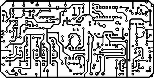

          • Actually it is not mine...I think original author already showed here...Huh! Now i am thinking; i havent check with him, can i post this here or not? Damn! I just awaked...still confused..!? Damn! It is possible he to be pissed off me much!
              Yes I know that's work of our common forum friend, he sent it me too.
              You just revised labels etc.
              What about noise between Vladimir's one and goldy ? If you think there are fets related problems disposition of the two and their behaviour could solve dubts ?
              Let me know.
              I'm planning of making another TGS (this time light - no notch)... and like both PCBs but I'm too thinking at noise propagation issues...
              Both are good from an electrical point of view but are there differences about noise ?
              Best regards,
              Max
              • I havent finished Vlasimir's pcb yet. Also posible problems..?
                Can you look at this Goldy and try to find any mistake?
                I dont know what else to look...get tired of it to much...

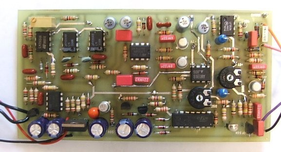

                      One thing is still buging me;
                      again i went outdoor with TGSL. It is still producing false signals from time to time on the ground? I checked everything. Cant find what is the problem? So i have made TGSL on 2 different pcb's. One (bigger) from first page of this thread and second, smaller.....I removed all components included in notch section from larger pcb. Comparing those i saw that device with larger pcb is acting much better than device with smaller? First one is not producing to much false signals at all. Smaller one is producing to much false signals.
                      What is interesting; i can not provoke false signals to be produced by bending cable,shaking coil,punching it....remains silent. Not sensitive on any kind of "torture"...But when small item moved in coil vicinity, just about to provoke weak detection....device detect it weak and when item removed, device continue to "beep,beep,beep...."-ing all the time. Outdoor, when coil is in the air, i get simillar behavior, but when lower to the ground it stops beeping. Moving forward with coil 3-5cm of the ground, touching grass it is producing false signals oftenly?
                      Device with larger pcb is acting simillar but noticeable less false signals....very rare...on some fields almost none?
                      I collected those 254 coins in not time, with larger pcb.
                      I tried everything possible to find source of problem....without success.
                      I guess my huge problem is cose i dont have good osci. to accuratelly measure all suspectable "spots" here.

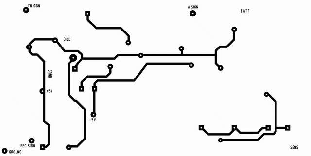

                      I am posting smaller pcb with component layouts, maybe some of you will spot some mistake on it. I got very tired of looking in it, and havent find anything bad yet....
                      Hi Ivconic,
                      I know I keep coming back to this ... BUT - what you are describing sounds exactly like the comparators are going into oscillation. Problem is that you don't have a scope yet. Get one. I've no idea how how you can build detectors without it.
                      The comparators on the outputs of the GEB and DISC channels have a threshold which is set by the sensitivity control. The GEB channel appears to have R40 there to provide some hysteresis to prevent this, but there's nothing for the DISC channel. Don't know whether this is a problem or not, as I haven't looked closely enough yet. If you bring a coin towards the coil to get a faint response, the comparator can easily start oscillating. It might even be worth just swapping the IC for another one. I've managed to cure some instability on another detecting by just changing the comparator. With a scope, you'll see the problem immediately.

                        • Goldy
                          Hello Ivica and frends
                          No problem for showing the goldy pcb. Made it together with Nakki.
                          Here the latest version.... but there is still on high sens sometimes erretic noise.
                          Can it be that it is 50-60HZ ?? Is it a pcb design error?
                          Ap
