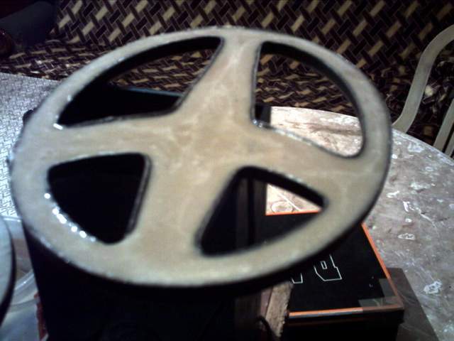

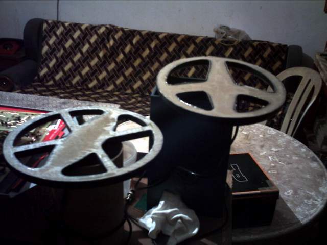

          • Those are 2 coils i made yesterday and today.Drying yet. It will need few more
            hours to get dried and stiff.Also there is a mass which used to fill up coil
            housings. Sort of 2 component pitch. When dried, it is hard and fast as steel.
            Best so far. Cold drying no relative movements. Larger coil is 800gr and smaller
            680gr. A bit heavy but almost unbreakable. I can hit it with hammer very
            hard - not even a small scar...Superb!
            And photo of my (my personal-not for sale) TGSL, which i am using now.
            The one who collected those 254 coins in no time. Real killer! Coinkiller!
            I didnt payed much of attention on appearance, it is a bit brute but real
            machine!
            Others i made for sale are looking much better,nice outfit...Havent neither one
            right not to take photo. I'll do that next time when finished...
                      machine!

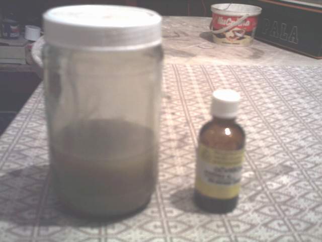

                      Hi Ivconic,
                      the mass you talk about is something like used in repair for cars... I mean something 2 components (filler+primer) car filler/putty ?
                      I've tested it to add weight to a coil 2 or 3 years ago... and it's really hard stuff... you can e.g. sand (seems metal after dry ! it's a rock).
                      I think most of these are poliurethane compounds... that are heavy about as epoxy and also hard... but they, big masses, shrink a bit.
                      I know there are epoxy based fillers (2 components) that are "loaded" with other kind of plastic (sometimes fibers) and other stuff.
                      My thought about them is about added stuff... I mean there are some for e.g. home improvement/repair that have aluminium grains inside... other (like car products or insulanting materials for e.g. water) loaded with metal oxides... : if so could be a real problem having that just over the coil !
                      Many car type have just plastic fibers inside... so are good for the purpose... one have to test making hardening some in an e.g. 5cm diameter bottle cap ... then trying to detect it with MD before using.
                      I've made some try and detected 1 kind of home-improvement epoxy adesive (maybe... cause is silvery looking... there is aluminium inside).

                      • No Max, this never used on cars or simillar. I dont know proper name for it.Sort of pitch,resin..? Oh, yes i know; look at some old TV set,flyback transformer and cascade are filled with it, same material. Doesnt shrink a bit. Remains same volume when dry.That's why am i delited with this. No metal particles inside, pure non-conductive material.
