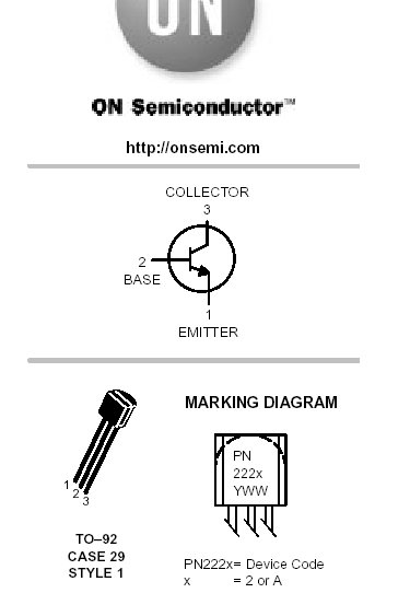

                      Hi tiktak,
                      here it is pn2222 pinout.
                      Best regards,
                      Max

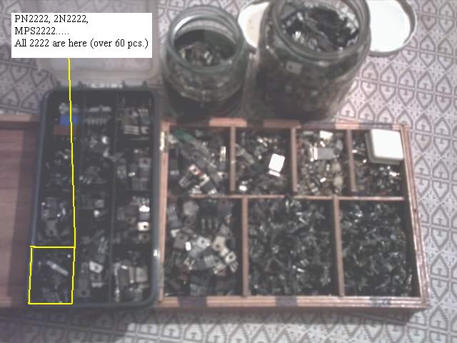

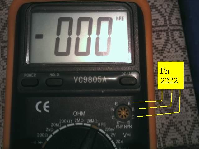

                      • Nightmare!!!
                        If it turns at the end that i was wrong about pin assignments...?
                        I have over 60 pieces of various 2222: MPS2222, 2N2222, PN2222...
                        In metalic and in plastic cases - both...
                        All OF THEM ARE C B E ! Neither one is different. I havent seen
                        2222 transistor ever with different pin assignments! Trust me!
                        If your PN2222 is different than CBE...than send it to me by mail
                        i will eat it infront of the camera! I swear!
                        Besides, you do not need to trust me or Max or anybody else here.
                        There is very easy way to check pin asignments..Look at photo!
                        Only if you put proper pin to proper socket instrument will
                        display Hfe....Any other way it will display either "0000" or "I."
                        dependable of instrument type....
                        So, you should put your PN2222 in instrument like this one and check
                        it...
                        You could do that from the begining without asking any questions..
                        Sheeeeeeeeeesh!!!
                        I will dream nightmares tonight..."huge,monster PN2222 is chasing me
                        arround.....!!!"
