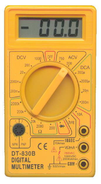

                I have this multimeter.I cant null my coil with this right?
                ACV:0-200V-600V±1.2%
                RANGE
                100mV-700V AC;
                I see that Ivconic use VC9805A.
                I will search for something according my poket.

                      about multimeters:
                      Your multimeter needs AC voltage range starting from 0mV (DT-830B starts with 100mv). Look for Max post somewhere about tuning with different multimeters there are quite big differences.
                      If you do not have frequency meter - that's also very much needed.

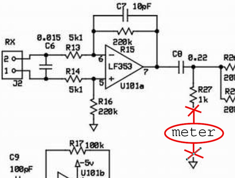

                        • meter facts
                          Tiktak
                          I am sorry about the minimum order from Digikey. What country are you in where they want you to buy 2500 each??
                          Look, about your meter: what Leto said is correct - your multimeter's lowest voltage resolution is 100mV and that is not so great. But, you might still be able to use your meter. Measure AC current, instead of AC voltage.
                          It looks like your meter's current (amps) scale can resolve to 0.1 microamps. AC current resolution is good enough. A 10mV residual signal would push 10 microamps through a 1kΩ resistor, and that should be plainly readable on your meter's 200uA scale.
                          Now, this should work:
                          De-solder the ground end of the 1kΩ resistor on the far side of the .22 capacitor from the receiver opamp output. (look at the picture.) Connect the red meter lead there. Connect the black meter lead to PCB ground.
                          Using the existing 1kΩ resistor should give an OK trade-off between circuit loading and meter display resolution. Set the meter's scale to 200uA and null according to previous instructions.
                          With the suggested set-up using a 1k resistor, simply multiplying the measured current X1000 will tell you the AC voltage. This is an indirect method of measurement, but it should work reasonably well (unless the fuse in your meter is blown). So, now you may be able to afford to buy a better frequency counter (hmm, I need one too, come to think of it). $$Get a better multimeter some other day.
                          Be careful when the meter in the milliamps test mode. I don't know your particular unit, but It may be more succeptible to damage. It is easy to blow a fuse - or worse when measuring current. You should definately THINK about what you are doing before you apply power, more so than usual.
