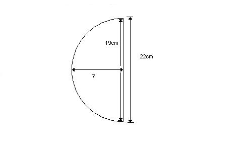

        By the way I found my mistake.I were using 0,30 without varnish!And have make 165 turns for both coils on 19cm former!
        This is too much!
        In the original coil wire is 0,25 without the varnish right?
        I have order small quantity of 0,25 wite without the varnish,so how many turns I have to wind on 19 cm former to make proper DD coil.And how much is this distance?I now that picture is not good and the part forming overlap area should be wider.But you understand what I ask.

              Hi tiktak,
              yes 0.25 without varnish (that is some 30AWG) or also bit more is good too.
              0.30 without varnish gave me same results when I changed caps but it's too tricky to be done, I think, getting right resistance and inductance required at first sight. I wasted much wire of this kind before getting right things.
              Can't remember now the exact distance but think was something 12.5 or 12.7cm in the middle.

                      Using my own calculator (see attached) I used 127mm inside radius, 0.27mm wire thickness and 117 turns. This gives an inductance of 8.98mH, which is closer to your measured result. How accurate is the value of the inner radius? This is a sensitive parameter, and only a few millimetres can change the inductance significantly. The calculator also shows a coil thickness of 5.62mm, whereas you have 5mm. Since the calculations assume a square cross-section to the coil, your's may be elongated.
                      Hope this helps.
