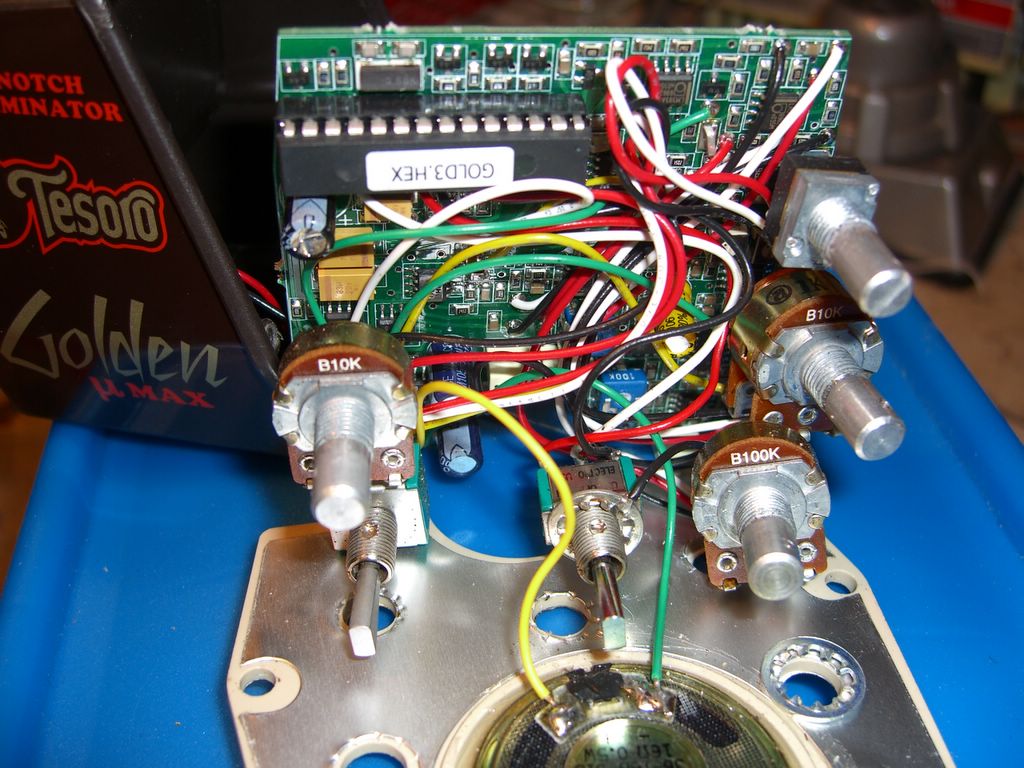

    Remember when we talk about potentiometers?Look at this picture!Its look like umax use 10kB,100kB this mean log?
    But this maybe because umax is newer version?
      Max,
      could be so... there is the MCU there.
      But are you sure they are log pots ?
      European and US pots are labelled e.g. 10KA for 10k linear pot
      However, if you have a japanese maker same linear pot then it will be labelled B10K, if product follow their labeling standard.
      Tesoro used asian made parts that time.

      • Hi,
        Max.
        Yes you are right! they are labeled B10k not 10kB!!

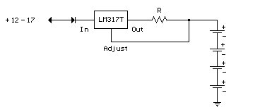

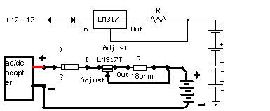

            Can you tell me can I recharge this 10 pieces AAA 1,2v battery with ordenary AC/DC adapter set to 12v?Or I have to buy some special charger?
            10 pieces conected in series and adapters + to battery + ;adapter - to battery-?

                you can buy one charger or use this simple regulator.
                Current limit = 1.25/R
                You need 1/10 of you battery capacity limit.
                For 700mAh -> 70mA
                R= 1.25/0.07 = 17.85ohm use 18ohm 1/2w
                Then charge overnight for 12hours. Batteries must be discharged first... at least at 80% to avoid troubles.
                Don't leave batteries connected to it without external supply.

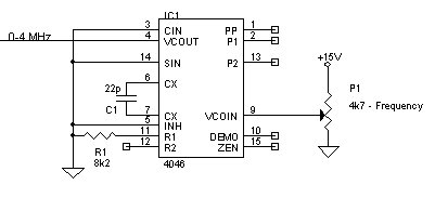

                    I think 4046 would do the job better, only dont have clue how to use it!
                    Yes, i have all those schematics with 4046, but wired up in quite different manner,
                    not useable in this one...Need some time to think about it.

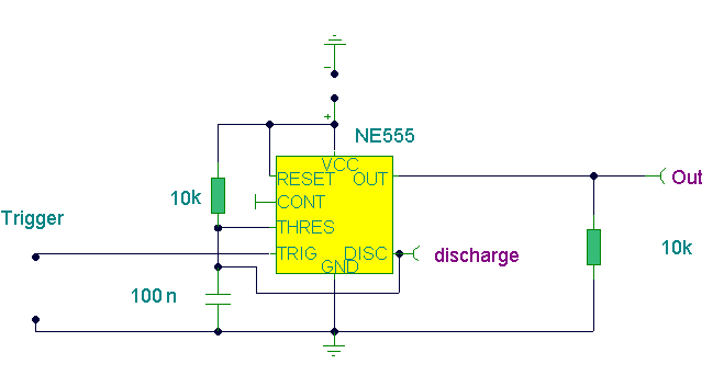

                    Still wandering! There is some 555 to check.....What do you think?

                      could do the job but still think that 4046 is too cool for that.
                      Circuit like this could do the job and you can set upper frequency of e.g. 100Khz... so getting about 20Khz for a 3 volt swing.

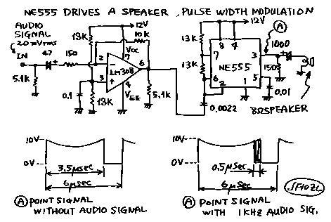

                      • 555s
                        For Ivconic:
                        this circuit can be also usefull (from JF1OZL) -> NE555 is used as a free-running oscillator. The oscillated frequency is 166kHz. This frequency is too high to be heard by the year of the man. In normal oscillator , the time-controlling capacitor "0.0022uF" is connected to the ground. But in this case, it is connected to the output of the audio amplifier. Therefore the width of the pulse is modulated by the audio signal. And it is heard by the speaker..

                          Hi ApBerg, thank you for replay!
                          As you wrote, I've connected coil on transmitter and frequency was 11.7 kHz
                          Then connected cap 15nF parallel with coil, like you suggest, freq drop at
                          8.9 kHz.All the time I heard constant tone in head phone, is it normal? When connected cap, tone was lower.
                          About coil: that should be double O coil like Ivconic's. Nexus made similar.
                          To Geo: very good idea,maybe try it later. Now seems my multimeter was right! I' try to reduce number of turns.
                          ApBerg,Geo,man from Mars thanks a lot!
                          Salute you!
                          • Hi
                            Max.
                            Is this what you talking about?But what is this diode?
                            1N4148?
                            • Hello Hush
                              Good results. The transmit freq. is the sourse for al the things that are going to work. The 4024 makes the freq for the audio sound, so if you chance the transmit freq. then aslo the audio sound is going to chance.
                              I think that it is ok that the sound is there for some seconds, this is the batt check, but I think the sound has to fade away after some seconds, this depends on the power sourse you use, the higher the voltage the longer the sound stays.
                              Let us know the results for your OO coil ?
