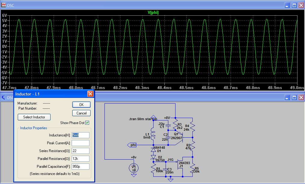

                    • Ivconic, Max
                      take a look this...

                        yes I see, but in practice is less, something 16Vpp: I've tested also with Tesoro original 9x8'' coil and measured always something around 16Vpp. What's your model definition (params) for coil ?

                        • Yes i know Max
                          I just make some test on Your circuit only.
                          Coil is the same 5m8 - like in Your test generator...
                          • Originally posted by sonar View Post
                            Yes i know Max
                            yes, but I don't remember now the values (was some months ago ?)... I think I've modified values from original schematic, right ?

                              • Hi,
                                this is one with coil params showed...
                                as you can see the voltage is well under 16Vpp.
                                But maybe you meant some other params there ?
