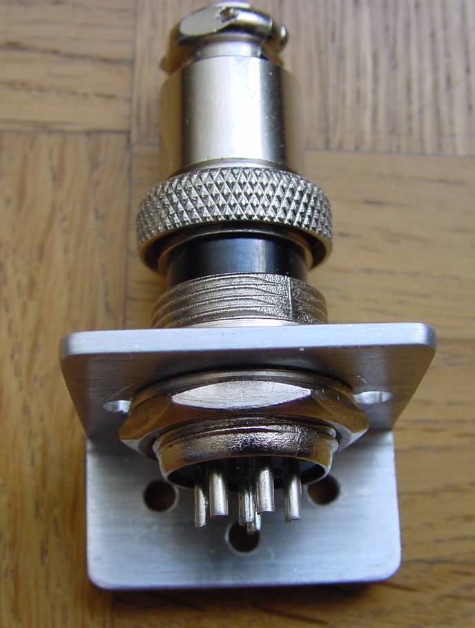

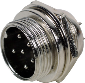

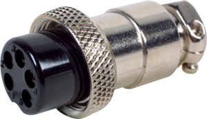

            about connectors I use these you can see at Maplin:
            http://www.maplin.co.uk/Search.aspx?...y%20Connectors
            Are multiway, low frequency connectors.
            You can mount the socket on panel and then wire cable to the plug: they are good cause you fix the plug with a ring-screw after inserted in socket... much like Tesoro's original plugs do (though Tesoro's use bayonet mount).
            The 4-ways kind are good for coils like TGS.
            They cost few... and are strong enough for MD applications... though are more exposed to corrosion... than some original MD parts.
            The noise is not a big issue in these connectors if wiring is done right way: There's no difference between Tesoro's ones and these about noise at these low frequencies.
            From what I know some small manifacturers prefer using these than more fancy things... in PIs too... cause are excelent for the purpose and costs are reasonable.... and are worldwide available.
            Kind regards,
            Max
            • Hi Max ,Minelab using these conectors.Grt Nakky.
              • And I
                • Yes that is the one i am using also...
                  Some benefits in S/N relatio also can be achieved if connector is mounted as close as possiblle to pcb with short leads. Front panel wit pots and switches is also grounded.
                  Keep in mind that all grounds are better to be connected in only one spot...due low frequency and possible some sideeffects. How to do that? Depends of your exact setup; enclosure,front panel,small back panel with coil connector...that's why i copied exact Fisher 1265 setup. Turns to be very eficient!
                  Also noticed that Disc/All switch is better to be wired with very small(thin) coaxials...taken from some taperecorder head Reduces S/N also. But also all 3 cable shields to be connected at one side only and one spot. On other side keep them short in coat and unconnected, only "hot" ends to be connected to switch pins.
                  There are many small tips very influencing S/N relatio and should be applied when mounting detector finally.
                  More you pay attention on those - better performances you will get... simply as that!
                  Regards!
