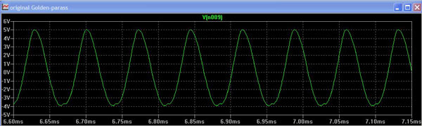

              FWIW: Is that 5V peak-to-peak, or single peak? I get about 5V single peak Tx signal - if I want more I add a LED diode to the 4.3V zener to increase the voltage drop which increases the TX voltage - but maybe more distortion also.
              TX voltage is sensitive to zener and also JFet Vgs-cuttoff. JFets have wide range of spec, Vgs-cutoff from -.5 to -5 ! If that is true, everybody have different TX voltage! But I think they are fairly consistently around -2 to -2.5 V. You could check yours to be sure.
              I guess transistor non-linearity makes distortion, JFet tries to regulate it to make more sinus. If you disconnect JFet, nice big oscillation but big distortion too. So if too distorted, JFet not acting soon enough, need smaller Vgs-cutoff or different zener I think. I experimented with it a fair amount.

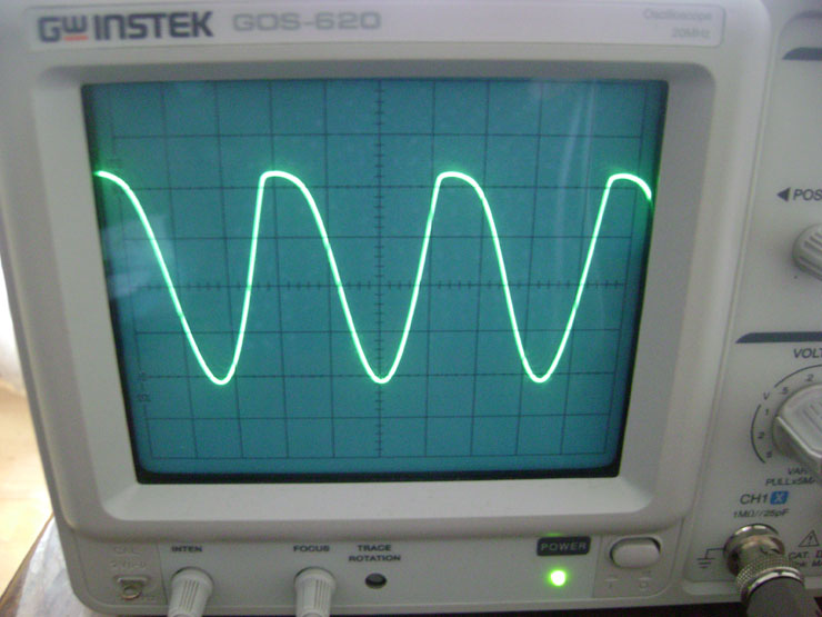

              • Okay I've done more measurements:
                The oscillogram below is measured transmit signal with settings 10uS/Div and 1V/Div. As you can see I have huge difference in the frequency and voltage.
                I don't have F.counter so Im using the scope:
                3.4 Div x 10 uS = 34 uS, so T = 34 uS = 0.034 mS
                F=1/T; F = 1/0.034 = 29.4 Khz
                Amplitude is less than 5 Volts Vpp (1V per Div)..
                I measured supply voltage:
                - Between: GND and Output of 7808: 7.98V (Good);
                - Between: GND and 4 Pin of LF353: 0.8V (Not Good??);
                Obviously the frequency is way too high. And considering my wire is 0.28 with varnish (I bought from the store, I haven't even measure it, it should be accurate), and the windings number which is 100, and the coil former is 28DD (255x137) I just have no idea why the freq went so high. Scope is calibrated,
                2V/2Khz sine wave shows accurate on the screen.
                I can make new Tx coil with lets say 135 windings, which I will, but this is not important.
                Important is what I am missing here. Up to here:
                Negative supply voltage suck (or Im not measuring it right)
                Tx Freq is too high, too low Tx voltage signal (could be because of -voltage)
                As for a start from now, I need to make new Tx coil with more windings (or attach the Rx to see the freq change since it's 105 windings).
                Negative voltage - don't know..
                Help needed , lets help the new guy ... Your ideas and criticism are most wanted now.

                  have you connected the 1K resistor on top that it's missed from pcb ? I mean R27 at Ivconic's schematic... you must put it in component side... make 2 extra holes for it if required.
                  You hear no sound at start cause there isn't anymore battery checker there... so sound could be produced just by signal path.
                  Also... which darlington you use ? If use BC517 you must reverse 180° cause pinout is different from MPSA13.
                  The small bump there is non linearity at oscillator... depends also on coil... good coils show less of it... but expecially transistor is involved.
                  Often is not much important unless it's very large bump.

                    frequency is wrong... really high. I don't know why... but I will check the capacitors at TX if the turns are 100 on TX coil. It's really strange you get so hi frequency there...
                    0.28mm with varnish is ok.
                    I made many coils... even different wire and get easy always around 14Khz with 100turns. Remember you need to tight the wires very strong on coils to get required inductances.
                    PS: check voltages too , you must get +8V at regulator, +12 or more from battery (otherwise works but not so good) and at least -6V at converter.
                    Kind regards,
                    Max

                      • Hello Eclipse.
                        I think you wrote you use plastic transistors, look for the e/b/c pins !
                        The coil you use, 100 windings is ok, ceck in the transmitter part the caps and the zener diode.
                        Regards.
                        • Thank you will, do it.
                          Amplitude and "bump" error are now fixed.
                          I have pure clean sinus wave at the Tx with ~9.5V amplitude
                          Still frequency and -5V mistery needs to be solved.
                            check frequency at output pin of 4024, must be (osc freq )/2 ...so for 14.6Khz expect to find 7.3Khz there, I mean the point where the r9 and R10 are jointed.
                            If not check the 4024... check supply, check if input signal is there.
                            If signal is present there check the npn/pnp transistors there at voltage converter: a usual mistake is when using e.g. bc547/bc557 instead of 2n3904/2n3906 (or others american kind) cause have reversed C and E terminals... just turn 180° if so.
                            If still doesn't work and transistor are OK, check diodes polarity and orientation, same for capacitors then if needed.
                            At tx you ideally have twice vcc ... so 8x2 = 16Vpp sinus... but never happens... usually you get anything from 9 to 14V there... depending of Q etc
                            You'll solve the puzzle.
                            Kind regards,
                            Max
                            • I am armed now! Sharp and dangerous!
                              Ha, finally i got some oscilloscope, beer for everybody, on me!
                              First thing i tested is pin 7. on LF353 ...perfect sinus.
                              Collector of 2N2907 is giving almost perfect sinus? Right side is a bit distorted...
                              That was all for now, havent slept from yesterday. Will conitnue tomorrow.
                              Huh....
                              • Guys a BIG thanks! I am so glad that the TGS is now in operating mode!
                                The negative voltage is -6.27V, positive is +7.98V, Tx is exactly 10 Volts.
                                There is sound from the un-adjusted coil , and actually it does detects , constant signal without metal which stops when metal object approaches..
                                offcourse max distance - 15sm ...heh still adjustments of the coil should be made...
                                The fight continues whith the coil construction!
                                Ivonic, congrats on the great machine you got there, I hope it will last long and will adjust many many boards :P!
