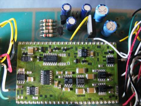

  • Just saw this photo on other thread; justify my doubts about pcb.
    Seems they also reconsidered S/N issue and made nice ceramic pcb, smallest as possible to improve ratio....ha,ha,ha...dirty trick!
    Usually ground potentials at lowest frequencies presents sort of "sucking antenna" for various interferences. In audio technique is imperative to reduce those at very minimum, cose everything is later pretty audible in speaker. So usually when projecting audio preamps and amps, designer tends to form ground loops at one and only spot on pcb. Many loops will degrade S/N ratio more and more. We can freely observe metal detector as sort of audio device, dealing with very low frequencies. So pcb design is more than important here, among other important things.

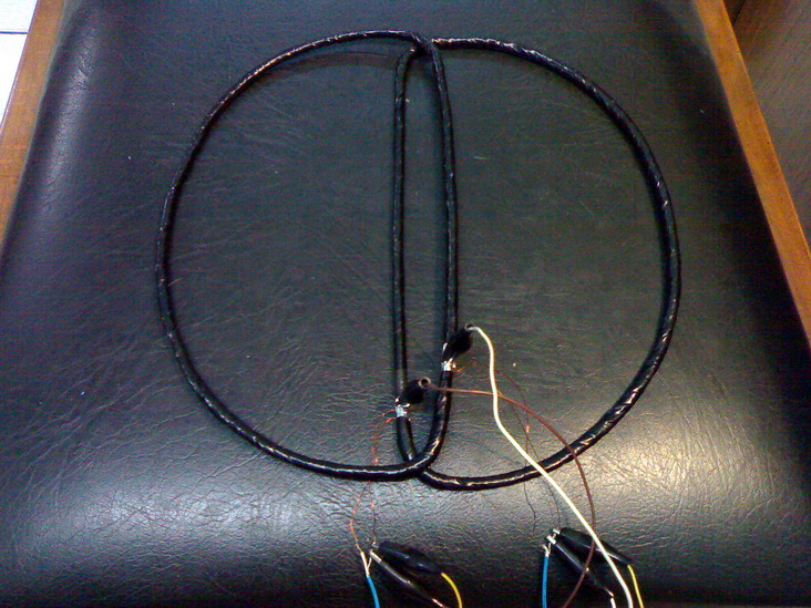

    • Originally posted by aft_72005 View Post
      Hi Max
      You are right , but I didn’t have short short circuit on coil.
      The faraday shields at the transmitter . And receiver coils open in the region
      Of gap .
      Please more explain .
      Best regards.
      you must have the gaps and you have but the overlap area covered with al foil is seen as a shorted turn by the MD. In that oval shape you have actually a conductive turn that's coupled with magnetic flux generated by oscillator: this produce strong eddy currents in that shielding , closed, loop that will damage your detection range.
      So, put some e.g. tape between the two shields where they touch and you solve that problem.
      Kind regards,
      Max

          • Hi,
            Kind regards,
            Max
            Hi Max
            It was working well later, I did what you said me , also you and Qiaozhi are right.
            Theory is true, but it is strange .not any happen after Banded coils with tape.
            Best regards.
              Hi Max
              Best regards.
              this is the good way of doing it, keep separate the shields of tx and rx coils.
              I like this way.
              Now, about poor results you have to optimize wiring also: read when Ivconic talk about short leads to e.g. panel socket etc all that is another key factor.
              I don't like alligator clips there and that wire, why don't you try something shielded cable instead ?
              Also, the CHAIR ! Are you sure the chair has no metal inside like iron rivets or nails ? Cause if so you could get lowered sens from detector too.
              So, are all "details"... but are important when searching for optimum.
              Kind regards,
              Max

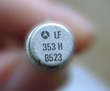

                • "Manifacturer logo looks like a triangle, can't recognize it."
                  Like this one ?
                  Kind regards,
                  Max
                  • Hi Max, it's not AD.
                    Here is a picture of the device, looks old isn't it...?
                      yes... it's old... it's a Thomson-CSF's metallic LF353... very old!
