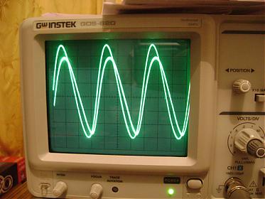

        Sensitivity pot act like.. well actually doesn't act a bit.
        I can't see any difference when rotating the pot, already checked it's connected and working, but does not seems to react.
        I Am using the schematic w/o the threshold, with fixed level.
        Actually my PCB is based on Ivconic's board posted in "gift-pack"..
        except the missing 1K resistor, the up-side down transistor in oscilllator and
        the thresold part everything looks the same as the schematic.
        The frequency of the oscillator is about 14.6-14.7 Khz
        I am using several different set of Tx and Rx coils
        One one set didn't have shield on them, the other have shield and the gap.

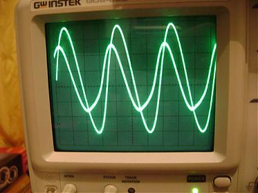

        Important question for me.
        How your phase shift appears when moving coils?
        Does it "goes" all around the 360 degrees?
        Because mine jumps a bit with about 30 degrees +/- and
        nothing more I could do to change it.

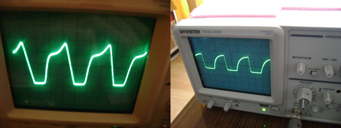

        That's measuring Tx (leads connected to GND and Tx connector 1)
        and Rx (leads connected to Rx connector 1/2 and also when measuring Pin7 on LF353 - both cases same problem. Wrong totally unadjustable phase)
        I have the feeling that these are scope problems. I doubt observation of JR. like me could help you guys, perhaps avoiding stupid mistakes only
        Check out the photos:
        The smaller signal is Rx, it moves only between the 2 positions as on the photos. Haven't seen more than 90 degrees shifting yet. Weird stuff.
        Cheers

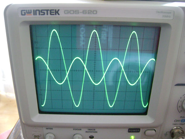

          the problem is at coil. The phase shift is no good as I see in pictures. If you swap RX leads you get 180° reversal appears : you must keep coil in same orientation like you have already and just reverse the leads.
          If you have 30° you'll get 210° and so on.
          It's obvious you get small phase shift when normally move the coils... but when you're around nulling your phase shift will change much, not few tens of degrees.
          You have to match Qiaozhi's picture to get coil about in right phase shift.
          BTW phase shift is not a severe limitation to depth in all-metal mode... so you'll get good detection even with not perfect value... the fact you get detection in an indication that the MD works, but then to get hi performances you have to check many things like preamp and fets.
          I remember that one time I reversed gate leads at fets (cause all we use different ones and I confused BF245 with J107) but STILL I get detection using a good (already made) coil... around 15cm for a large coin!
          So coil is really important and when other stuff is ok (like right connected fets! in my case) you get very good response... 30cm etc

                • I fixed some stuff making troubles, found others.
                  Found how I can measure phase shift correctly, it was the scope doing that.
                  It was keeping the signal steady and sharp. Swiched off the god damn option. Gets tuff to measure but at least works. Glad I found that finally.
                  Strange thing is that when reading calibrating signal everything looks Okay, correct dual channel mode.
                  I did a quick bench test, after all the optimum values which I was able to achieve correct phase of the signals maintaining low amplitude was ~13mV (2xDiv, 5mV/Div). Going lower gets hard to achieve correct phase.
                  Do you think is good enough, and how good this"good" it is.
                  Measuring without scope seems hard, w/o seeing what actually is going on, though many people do that.
                  And my guess is adjusted coil with scope to certail level, lets say 5mV does't actually mean that the multimeter will read 5mv, perhaps it will show
                  the trivial 0.0xxx I got two (2) unaccurate unrealiable multimeters, so I did't use them for adjustments. I'm glad I can avoid that.
                  If it works use it
                  Adjusting i do like this:
                  Connect 1 channel of the scope to Rx, using just the cap 15nF
                  Second channel is detached, any try to use the second channel - bang!, wrong readouts like
                  I first experienced hardness to maintain low voltage level
                  After I get close to the 5-10mV I switch on second channel, bang - the voltage goes crazy unaccurate, but who cares.
                  Thus I try to keep voltage minimum rate like it was, while adjusting shifting.
                  That's all. Hard it will be to keep this when using the epoxy, but I am still doing tests,
                  I don't care about that right now. Still work lays ahead.
