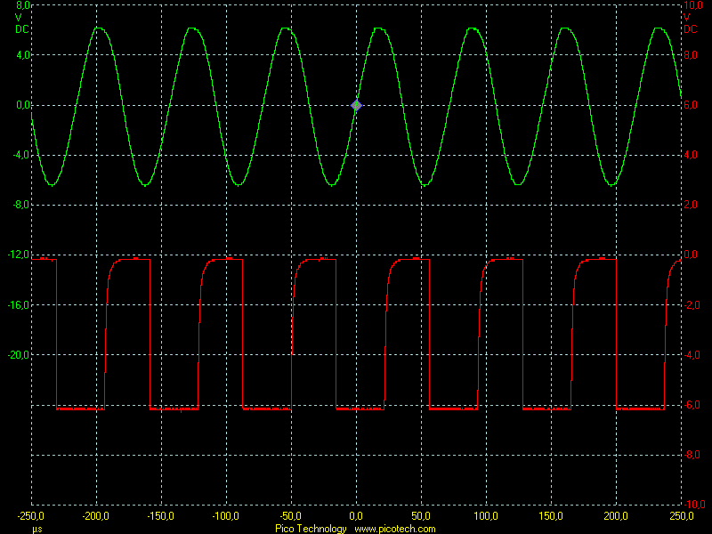

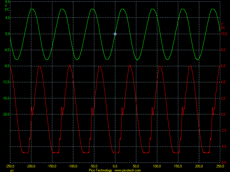

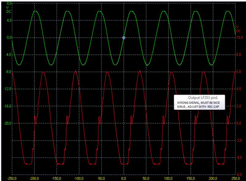

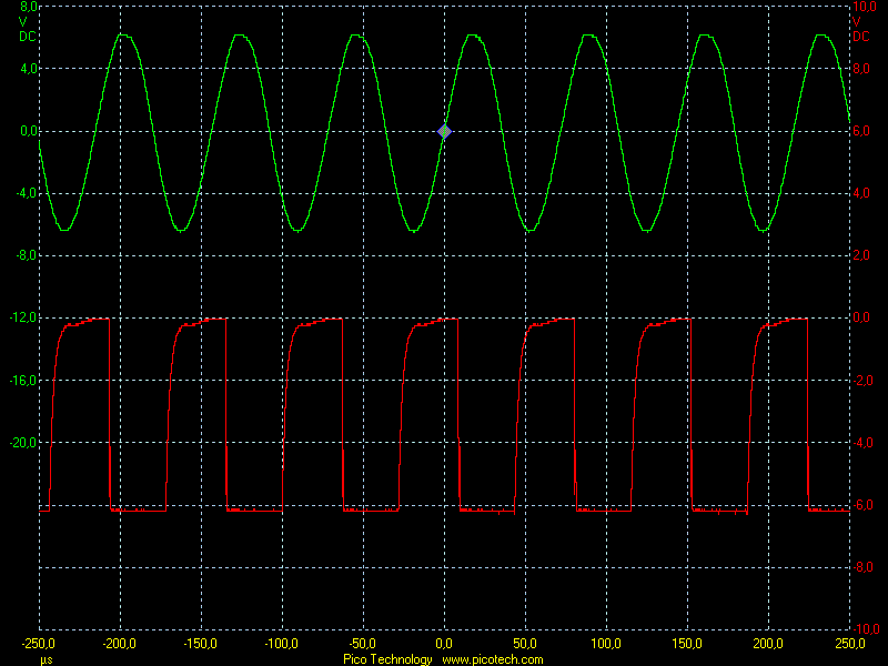

Hi Simon ,
In this YouTube link : http://www.youtube.com/watch?v=TVrISTKtxAw
I've recorded some of the 'coil nulling ' : Tx vs. Rx on output of LF353 .
With this set of coils ( shielded ) I don't get any closer as 35-40 degrees ...
For the detection in All Metal Mode the shift doesn't seem to care that much...
I didn't experiment that much in Disc mode or Notch Mode because it didn't discriminate that much so I had my (wrong ? ) focus in the All Metal
best regards,
Dennis the Mennis
