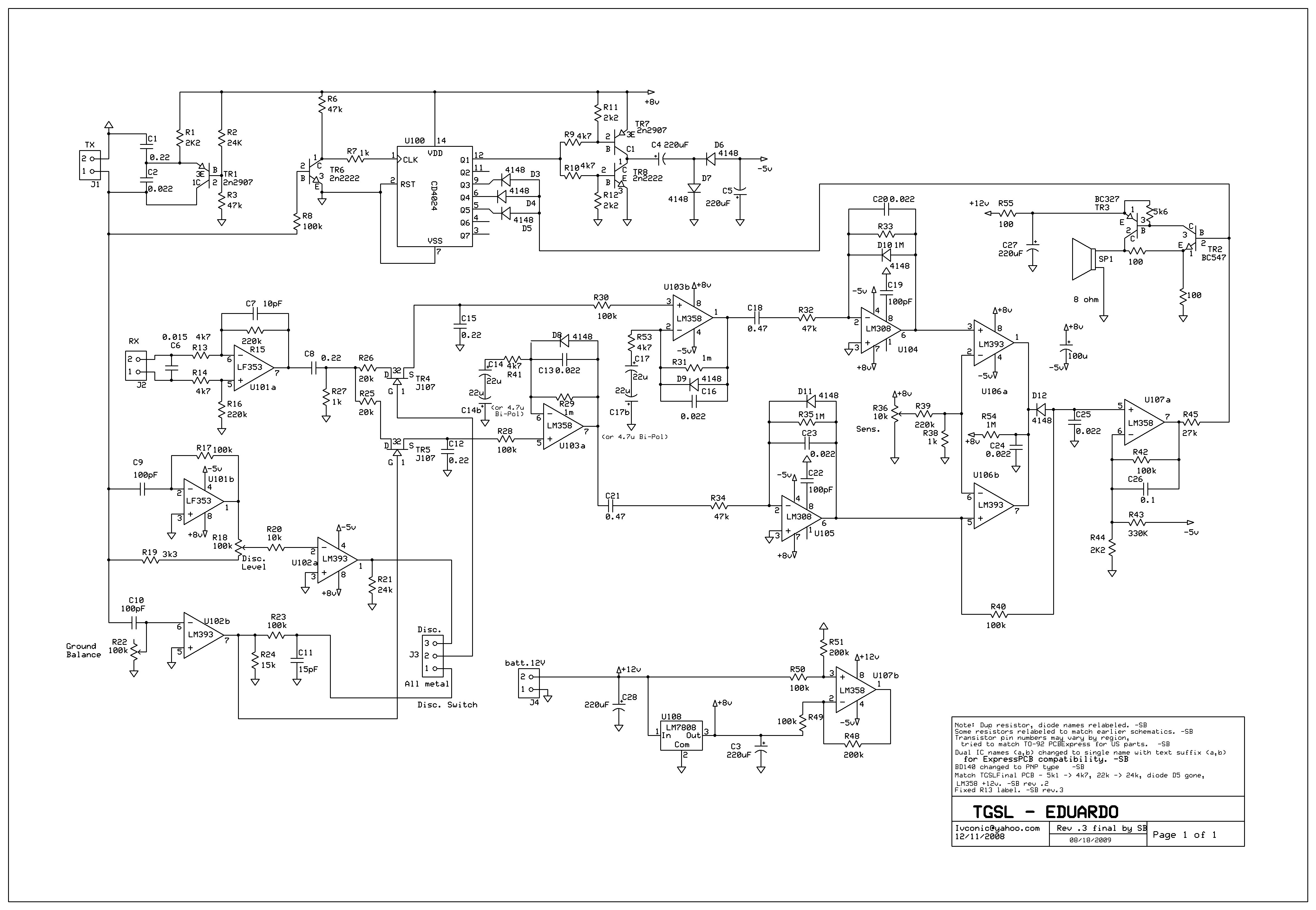

    • All its clear there is 2 types of TGSL. Both have slightly different parts.
      Quiazi put the ivconic Version 3 info on a thread, so we can all see this.
      The EduARDO VERSION SOLD at Silverdog - I cant find the correct schematic for this.
      If there is no schematic for TGLS EDU, fine. - - - Then what are the exact difference between IVcon TGSL and Edu TGSL
      (Silverdog has IGSL schematic for TGSL EDU, whoa come on guys)

        Hi, I want to build a metal detector on the first scheme. (TesorroGoldensabrezelfbouw1.zip (672.5 KB, 16954 views) it works well?

            Thanks Davor - inevitable questions for this drawing..
            The post det Filter Caps say 22uF (2off back to back to make a 10uF)
            whereas
            The note says or 4u7 non polarised.
            Would you know whether the ~5 or the 10 uF is most appropriate.
            S
            • That would depend mostly on your sweeping speed. However, if you go for larger capacitors it is highly advisable to replace the op amps in gain blocks with some FET input ones that have better 1/f noise performance, otherwise you'll have a lot of chatters (that are mostly due to the low frequency noise/fluctuation)
              At detektorforum.de some people noticed improvement when two back to back capacitors are replaced with non polarised caps.
              IMHO it is OK to go for lower HPF cut off, as the only drawbacks are 1/f noise and slower settling at power on. The 1/f problem is fixed with a better op amp, say TLC072, or even TL072. When redesigning for low speed motion make sure you also replace the 0.47uF capacitors with 1uF or so. You are hardly going to find plastic capacitors at "normal" physical size at values larger than 1uF though.
              With slow motion sweep you are NOT losing anything at faster sweeping as the low pass cut off remains the same.

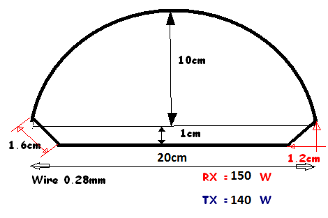

                • I am making coil for TGSL EDU.
                  Wound 107 turns on coil jig... standard dimensions from manual for TGSL Coil making
                  255x137 mm
                  0.25mm copper anameled wire
                  I have inductance of 6.53 mH and resistance of 27 ohms.
                  It is still on jig.
                  Is that OK ?
                  Can I remove it and get going with isolation and shielding ?
                  • If it's already constrained with wire or if you use double sided jig, the value will stay almost the same. Maybe you could remove 1 or 2 turns, but there is no need to aim for the exact 6.5mH value.
                    The TGSL will accept some variations.
                    As explained in this thread, in the worst case, if you are really too far away from the recommended values, you'll have to change the oscillator's capacitor to adjust it to your inductance.

                          Speaking of coil dimensions you are presenting here...i can suggest more turns; ~150 for RX and ~140 for TX.

                          any one have make this coil its work or not
                            This Coil Is right or wrong

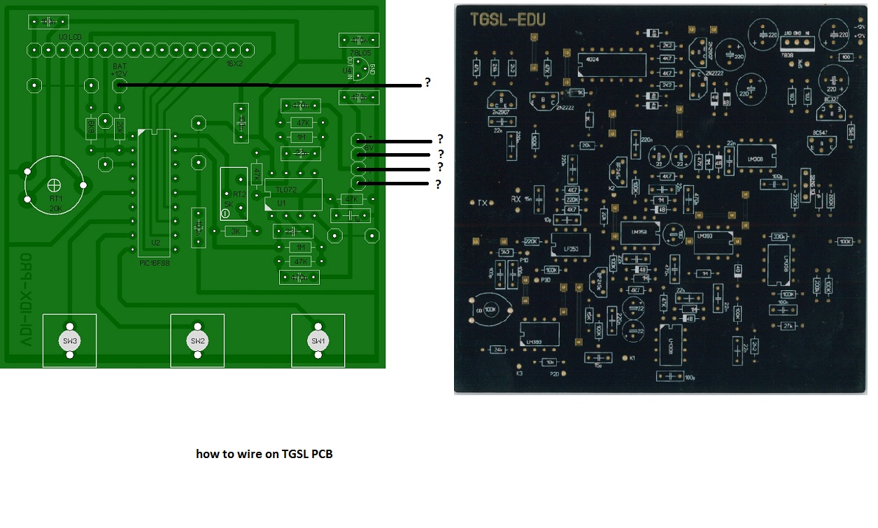

Name:	part placement.JPG
                              i need help
                              how to connect the VDI PCB Wire On The TGSL Board
                              i dont no how to read schematic i just follow the picture and assemble on this forum
                              i try to find how to connect the wire on that bord
                              an i dont find all on this forum
                              any picture can help me how to connect that
                              • Originally posted by paku View Post
                                [ATTACH]24919[/ATTACH]
                                Looks close to the correct number of turns if that is what you mean. Build it and let us know! Most important is that you get phasing correct as actual inductance can vary a bit. Also, your coil will be a bit heavier than normal.
                                Keep in mind though, if you want to build something different than what has been built and tested by many others we cannot help you much.
                                With that said, I have had fun building all kinds of different size coils. Most all have worked pretty well so long as I kept the inductances or phasing close to spec..
