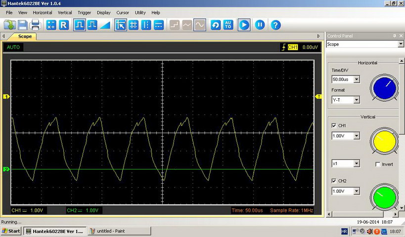

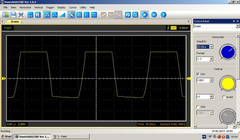

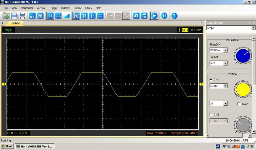

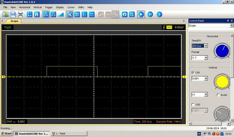

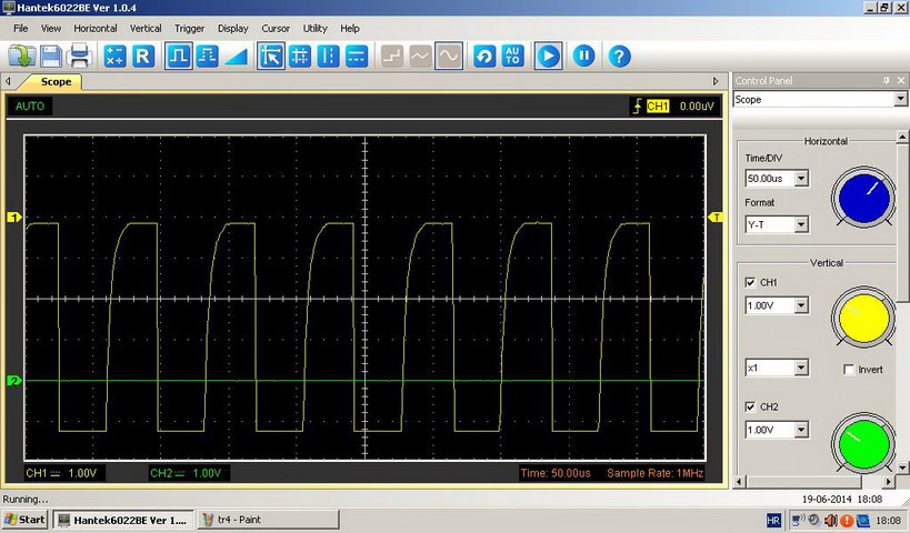

                              • TGSL test points 1, 2, 4, 5 (gate TR4 and gate TR5)
