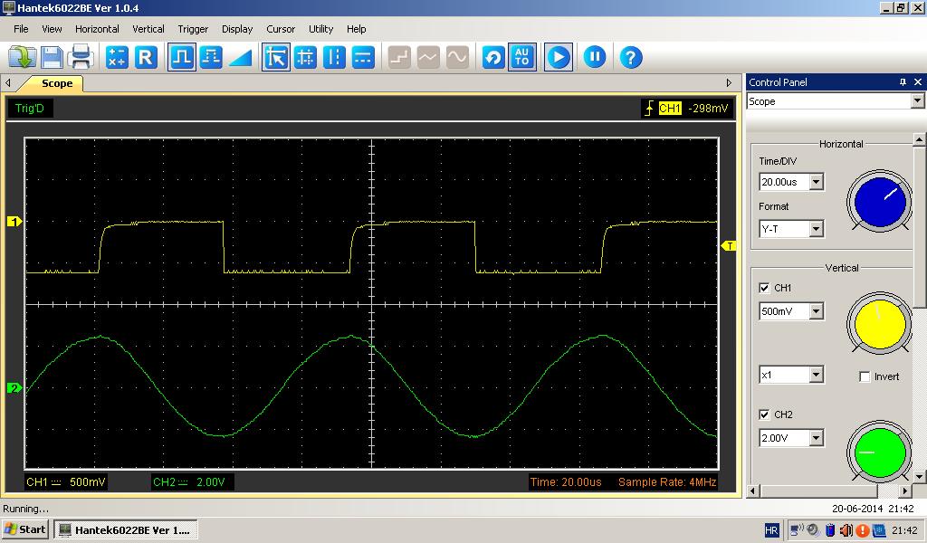

    • Originally posted by sdesic View Post
      Null phase
      [ATTACH]30387[/ATTACH]
      The picture is great - better than a foto from a normal scope I feel!!
      The USB Scope appears to be working really well.....
      Andy

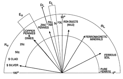

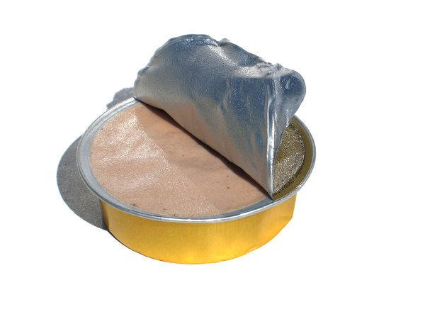

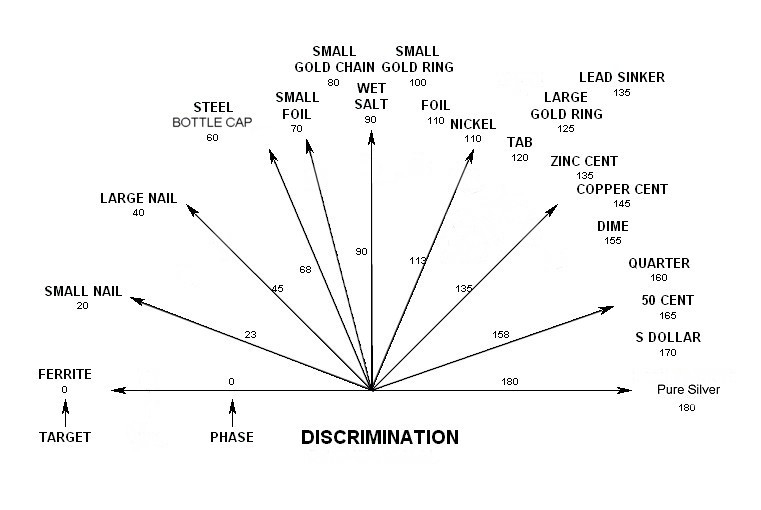

      • I was testing TGSL this weekend and I went to trashy area (foil, iron, pate "cans")
        Tried to disc out most of that but I was unable. Mosquitoes attacked me also so I left.
        Foil and iron are not so much of a problem disc is on middle position.
        When I discriminate foil, what am I missing?
        Some of gold stuff ... not zinc and nickel
        Pate cans replaced iron bits

          Discrimination Charts
Name:	Discrimination Chart.JPG
          • To put it in a nut shell discriminate foil and you loose silver such as pre 30s old six penny bits etc
            • We don't have silver coins in last 70 years so ...

                  • The one you made which shifted during potting - have u tried using it - it may be ok in use.
                    If u make more, dont go for an absolute null, the important factor is the phase relation between Tx and Rx signal.
                    When good, u can get rid of ferrite. Then you will be away ( oh and single beep not double with unclad coin )
