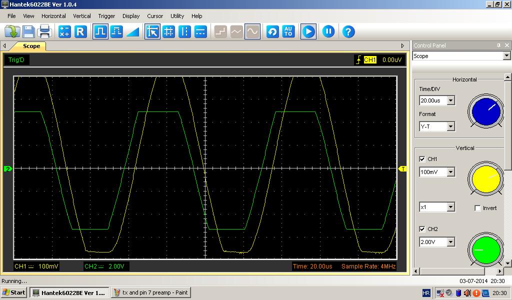

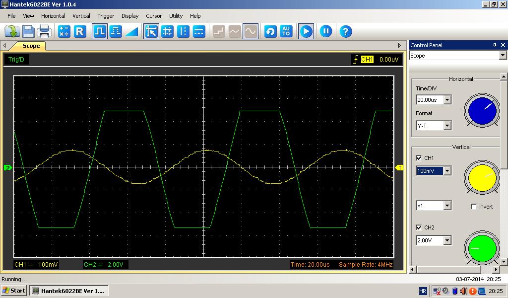

                  • I have measured :
                    TX 5.99mH
                    RX 6.44 mH
                    I have desoldered RX coil from PCB and tried power up
                    I have 3,6 mV on RX
                    desoldered back RX on connector
                    measured pin 7 250mV with AC voltmeter
                    Connected scope on TX and pin 7 preamp
                    here is result
Name:	tx and pin 7 preamp.JPG
                    Green is TX
                    same configuration and with 7 cm x 2 cm block of ferrite on coil
Name:	tx and pin 7 preamp with big ferrite.JPG
                    my USB scope is not calibrated to measure voltage
                    I found that coil is not rejecting ferrite completely - close by (1-2 cm) it rings on two places (?)
                    will try to play with GB
                    • you dont need to desolder any thing.
                      You dont need cal with your traces.
                      You have too much Rx output - you see the flat tops on the sine wave.
                      Need to null this better. If all potted up, then maybe too late.
                      Pot next one with scope on it

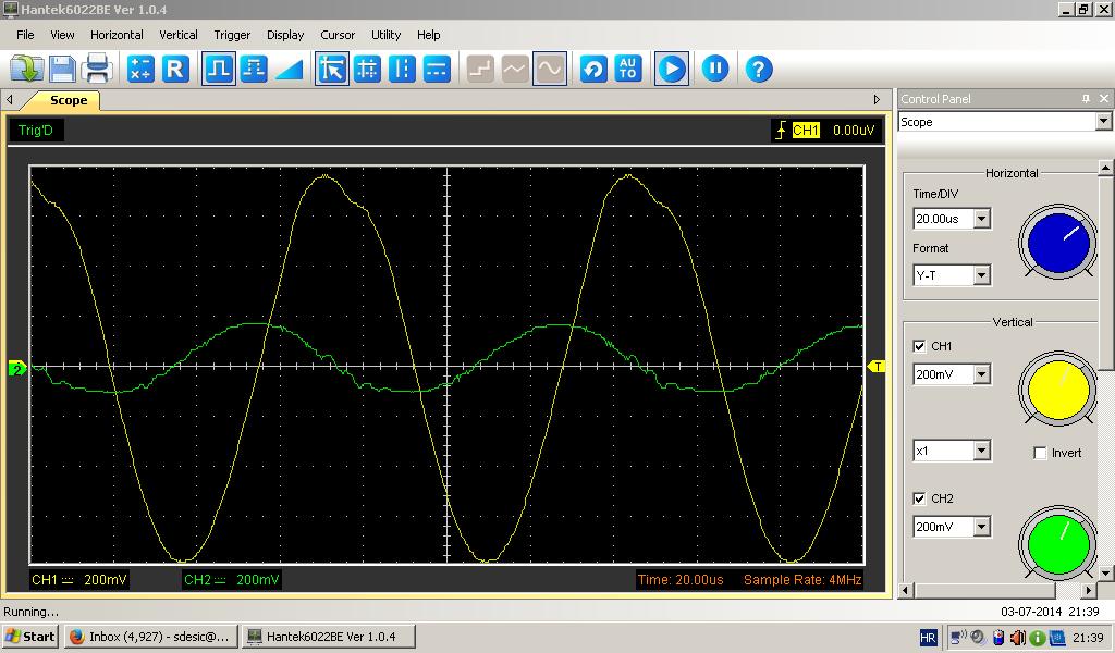

                        • Second coil with second TGSL
Name:	second coil TX and pin 7 LF353.JPG
                          Coil is hotglued in place
                          • much better looks correct amplitudes...
                            Your goal now iis making sure ferrite can be rejected, or not heard by setting the GEB pot. If you can reject ferrite, It will detect all of the good alloys and you made a detector !
                            • how many frequency you get when you nulling coil ? khz
                              • I don't have direct measurements with scope but it can be calculated... from my last screencap
                                2,5 cycles in 180uS
                                by my calculations about 13,888 MHz but I not math expert
