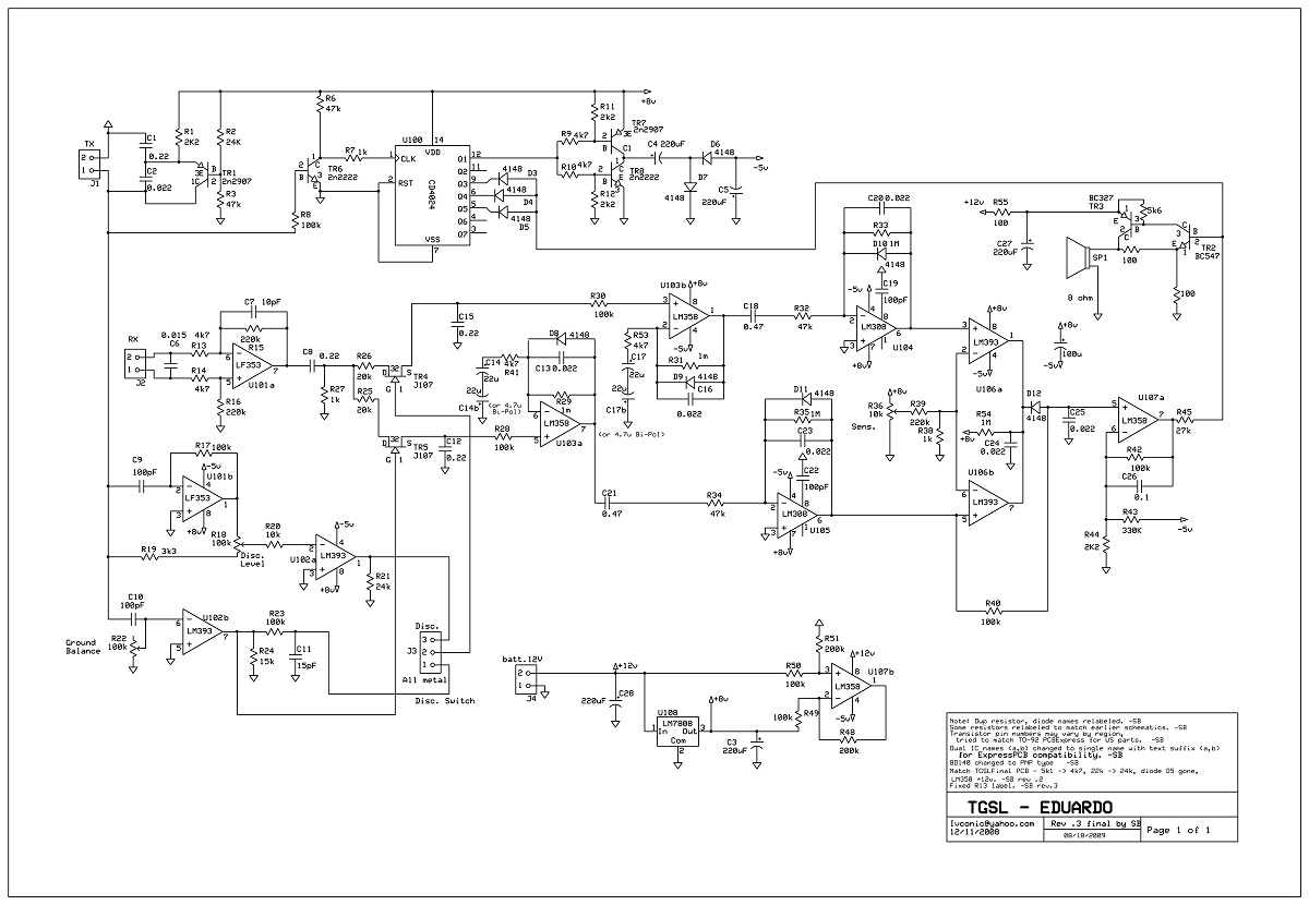

  • I have found: Sens 10k!
    • Pot. Sens. 100K. 10K NO.
      • TGSL_PCB_pot
        Hi Eduardo!
        Thank you, but on the PCB I see 10k!
        http://www.silverdog.co.uk/shop/imag...f-1024x768.jpg
        Then?
        And the ground extern pot? 100 k or 10 k?
        • Schematic has GB 100K, Sens 10K ?
          • Yes.
            • Works best with 100K with the 10K. Tested.
              The capacitors C14a,b,and C17a,b,are 10uF. It works better.
                Ok! Thank you!
                If I changed the C14a,b 22 uF, and C17a,b 22 uF capacitor for 10uF, and 100 k LIN pot for sens. then the TGSL works better?!
                • Yes.
                  • Thank You!
                    Tomorrow I buy some pots and capacitors...

                            • hello all
                              i made this tgsl (posted page1).
                              but audio is poor and its parts (22 ohm and mpsa13)are hot when using an 12v power supply. will this problem empty the battery if use it?
                              a 100ohm resistor is in series with 8ohm speaker. how can use a piezo?
                              best wishes
                              M
                              • If your 22 OHM resistor and MPSA13 are getting hot then there is something else wrong. If built correctly duty cycle of the audio signal is normally very small.
