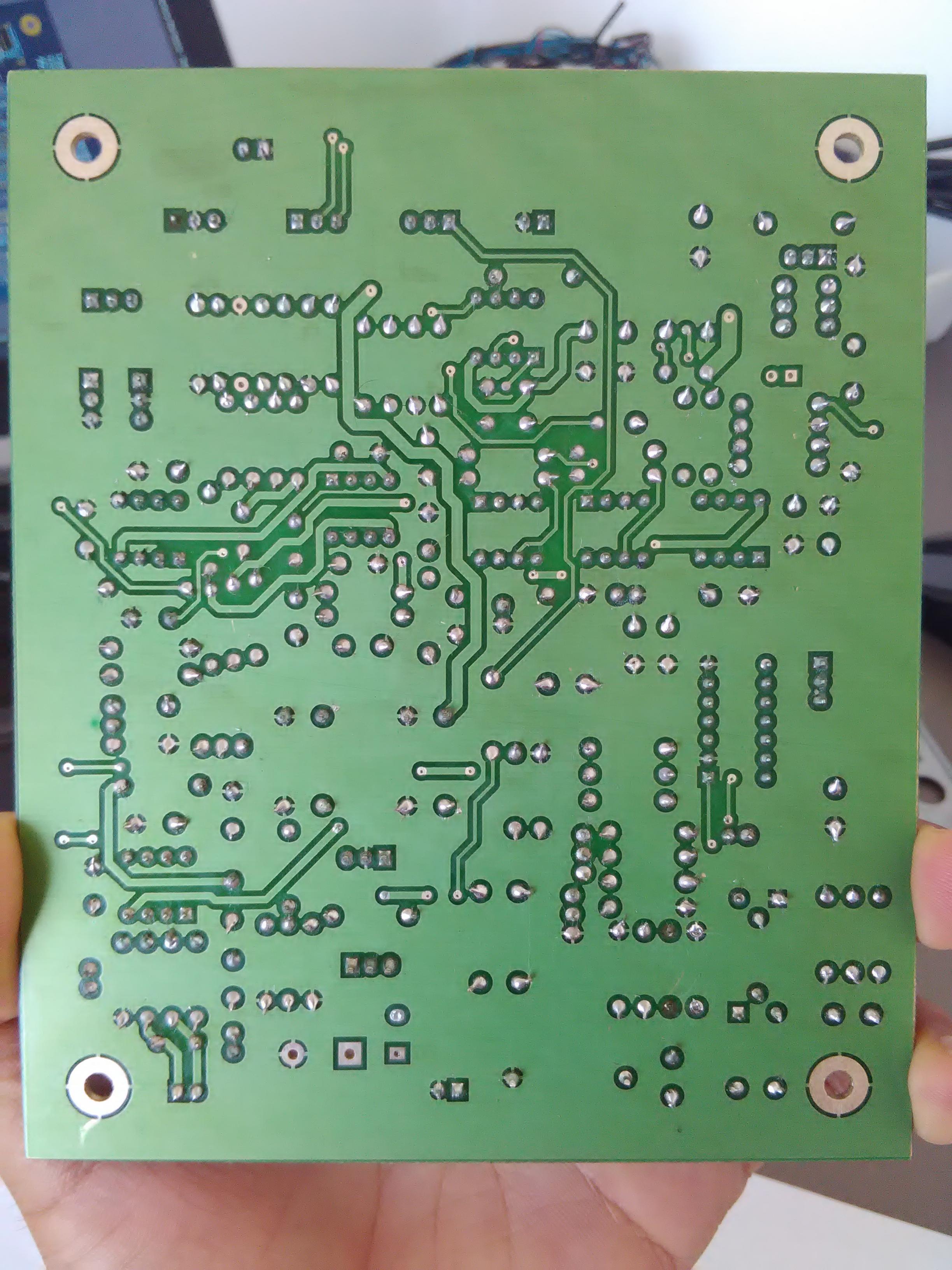

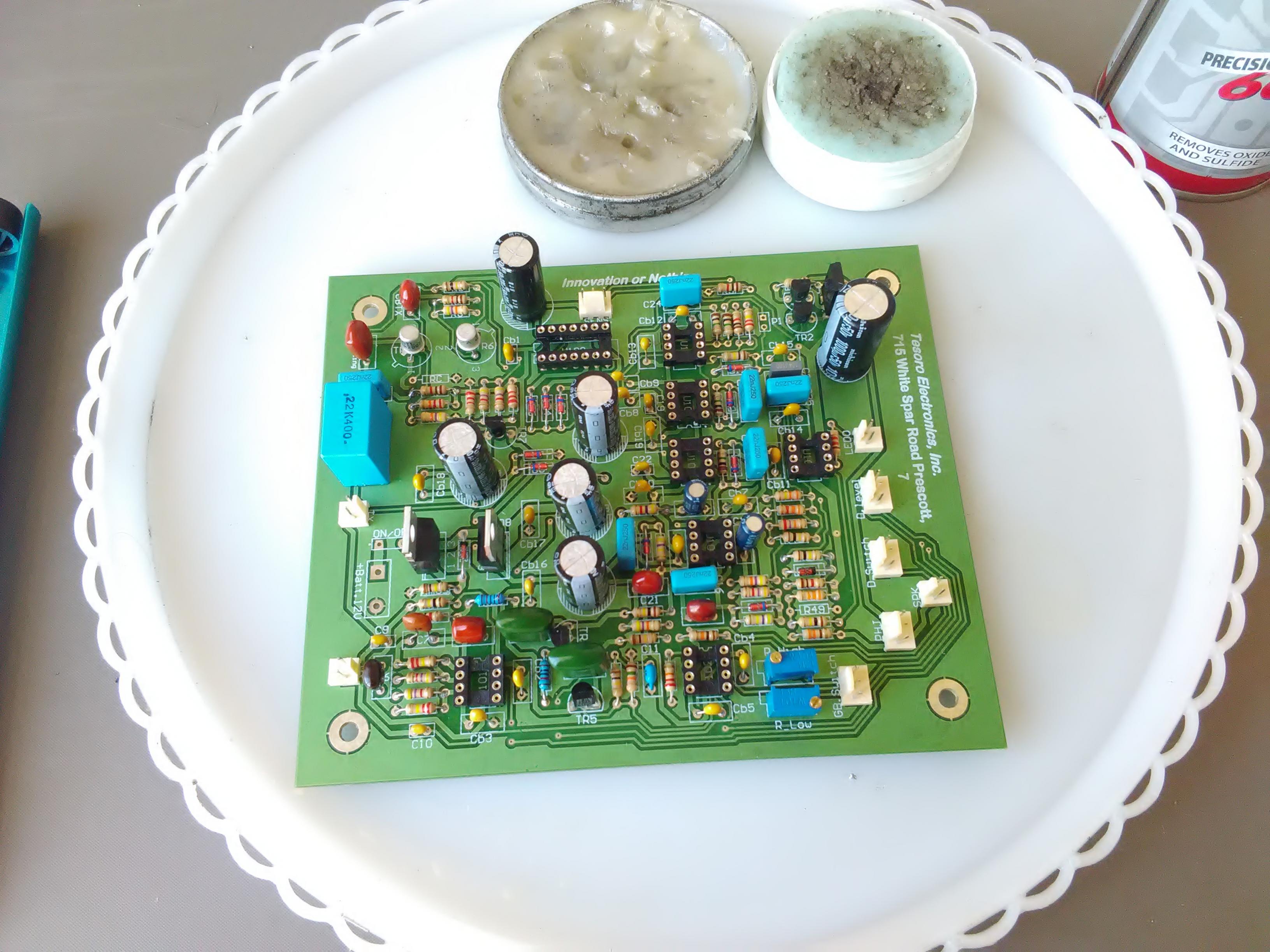

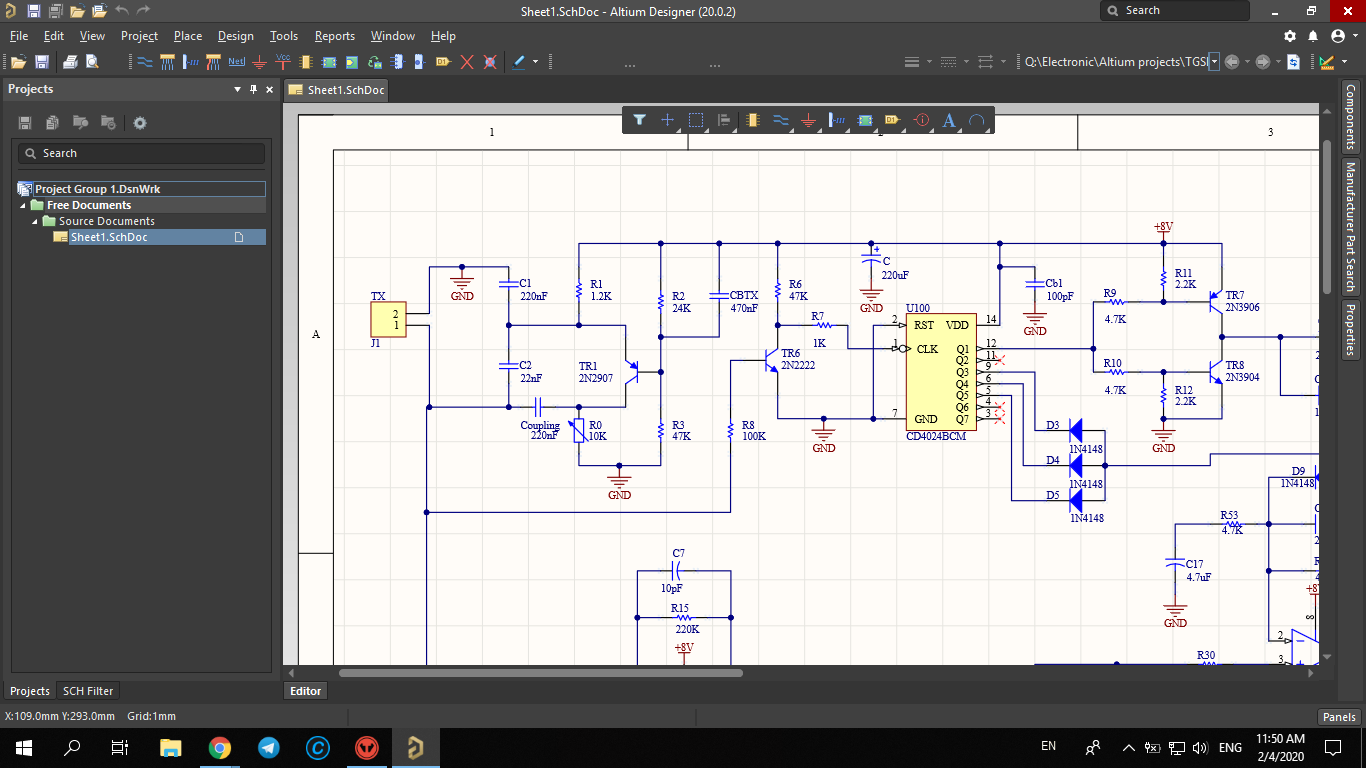

                      • my pcb and schematic for tgsl:
Name:	TX redesign.png

                                I saw part of the schematic you posted and i see dramatic changes in TX stage!?
                                What the heck you did there man?!
                                (rhetorical question)
