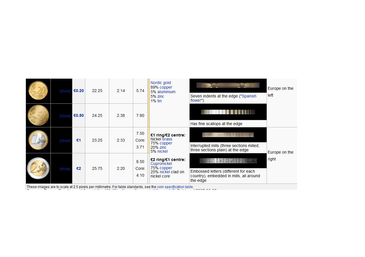

                http://en.wikipedia.org/wiki/Euro_coins
                FYI

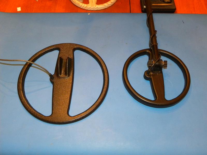

                      • TGSL and smaller coils
                        Well now that It's a little warmer out and I finally got a chance to do a little detecting with the TGSL, I have been comparing the performance of different coil sizes. The advantages of an 18cm coil over a 27cm coil are becoming more apparent. These advantages are not obvious when just doing bench testing:
                        1. 18cm coil is lighter, and even though a 27cm coil covers more ground,
                        the fact that you can swing a smaller coil a little faster makes up for it.
                        2. 18cm coil is easier to pinpoint with, which makes digging faster and can
                        make you more productive.
                        3. 18cm coil is less noisy when in actual use.
                        4. While a 27cm coil can give you more depth, it's advantage is not that
                        apparent when used in the ground. It "sees" less ground in relation to
                        targets.
                        5. 18cm coil is cheaper and easier to make.
                        6. 18cm coil has better target separation in trashy areas.
                        7. 18cm coil is easier to use around objects.
                        8. 18cm coil is much more "sturdy".
                        Try biuilding one.. you might like it!

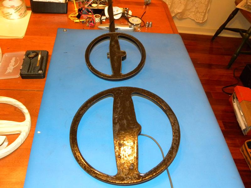

                        • Bottom view of homebuilt TGSL coils:

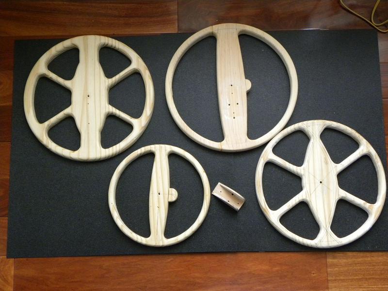

                          • good job ,nice work , do you have a pattern of wood model ?
                            regards Alex
                            • Some formers.. I need to start making them out of a plywood as pine tends to warp when heat is applied to one side. Also, they tend to crack easily.
                              Don
                              • dfbowers;
                                technical dimensions, please
