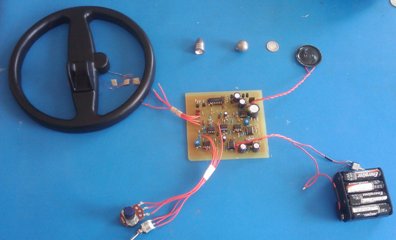

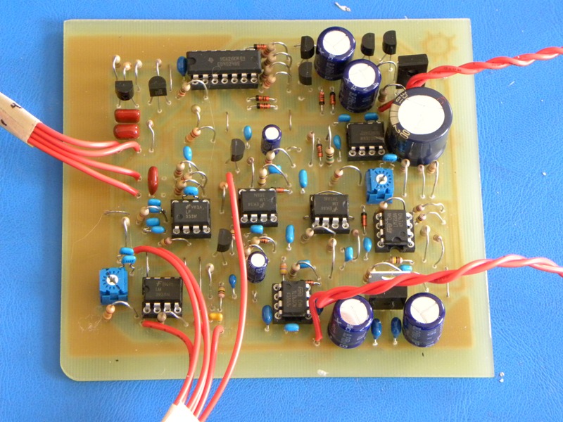

                  • My TSGL
                    TGSL
                    • TGSL
                      Circuit close-up

                        Can you detail which variation of Ivconic's circuit you built? I mean, this thread is 165 pages long, and the circuit has gone through some upheaval.
                        I don't mean for you to post your schematic, but do you have a link to the page where it is?
                        (Throw me a bone!)
                        • Rev .3 final by SB 8/18/2009.. (was that your latest?) There was a post somewhere with details on how to make and wire the coil, PCB, schematic and parts placement all zipped. I think it was labeled "Correct and tested" or something like that .
                          Don
                            Don
                            I'm sorry I wasn't more specific. I was mainly wondering if you employ a TX stabilizing FET or not.
                            I will try to find the zip file that you referenced.
                            Is there a stabilizing FET (or whatever it's called) in the your tx circuit? I was wondering because I seem to recall Ivconic as having abandoned that FET as inconsequential.
                            Last edited by porkluvr; 03-08-2010, 10:47 PM. Reason: to clarify "stabilizing" FET meaning
